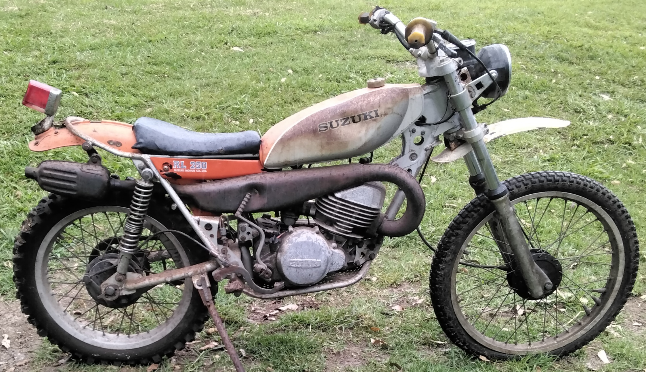

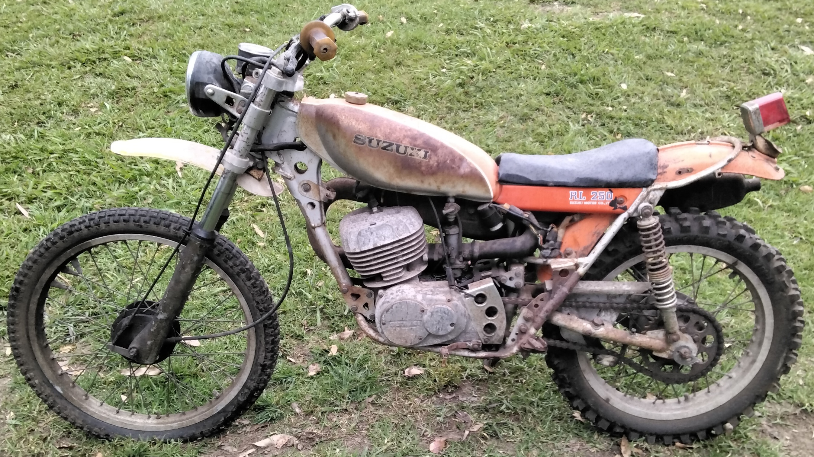

David Lahey wrote:Greg, that :suzuki is a great find. Amazingly complete!
Yes David, I am really happy with it and even happier to have it offered to me!
Apparently it has sat for many years, the Bloke I bought it off said he could remember seeing his Father ride it when he was a kid but nothing since then so it came to me as is not running. Since then I have had the carby apart (and that was fairly clean inside) so I think the fuel was drained or used before being parked? The tank had very smelly old fuel in it and some rusty contents but does not leak! So I changed the air filter, pulled the spark plug and checked that it had spark. Compression is pretty good and magneto area is really clean inside but the mains (on flywheel side at least) has a bit of freeplay. It fired up easily and seems serviceable in the top end but hard to be sure as mains are growly? The chain was really stretched so I did not test ride but ran through the gears with bike on its mobile stand.
