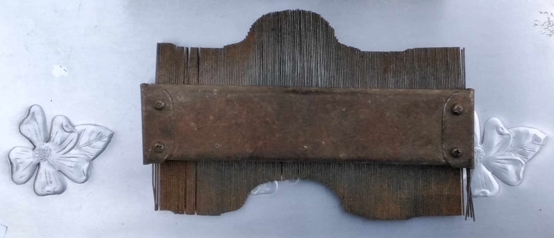

Other than calculating the change in compression I didn't measure the exact shape of the chamber Greg.
It would be interesting if there would be significant gains to be made by the shape of the squish/combustion chamber on a Trials bike given the low revs at which they operate.
I don't have a split head yet Greg although some might say so.
I am interested as to why you have lobotomised your head though for that silver tray.

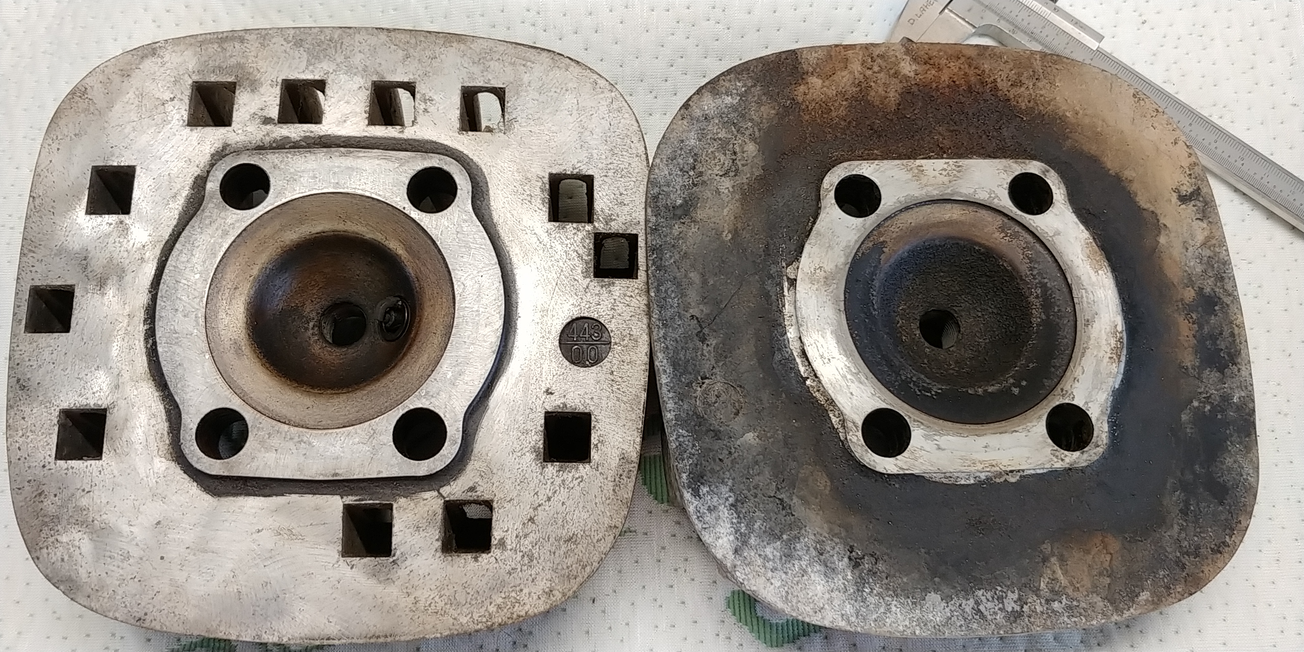

Well I don't have a fancy profile gauge like yours Greg, but I do have something else to add to the story.
Here are photos of the two heads in question. A DT175A (
model 443) head and
TY175 (
model 1N4) head.Measured with my eyeballs, the combustion chamber appears to be the same shape on both and the squish band has the same angle and width on both. Where they differ is in the step up between the squish band and the gasket surface. The TY175 head has a 1.5 mm step and the DT175 head has a 1.2 mm step. So to answer your question, yes you could replicate the compression benefit of the DT175 head by machining the gasket surface on the TY175 head, as many people have done. An even more common trick with the TY175 is to use a thinner-than-standard head gasket or no head gasket to increase the compression ratio.
The reason they decided on a lower compression ratio for the
TY175 compared with the
DT175 is because the
TY175 was designed to be ridden by complete novice trials riders and they certainly achieved that with the heavy flywheel, small carby and reduced compression. It is ridiculously easy to ride a standard
TY175 and because of this, many thousands of people continued on riding trials after their first attempt. I can remember my experience as one of those novice people as a teenager. I had been riding trailbike class trials (very poorly) on a
TS185 L and then a
Model 99 Alpina (325cc). The Alpina was not easy to ride in sections due to a worn-out carby, poorly set ignition timing, clogged exhaust, trailbike suspension settings and non-functional brakes. When I brought home a fairly clapped-out
TY175B in 1976 and rode it in my practice sections, I could barely even feel the bike at all because it felt so light. The motor was perfect for me at that stage, super predictable, impossible to stall and with a power curve as flat as the Nullabor. It didn't matter that it was so lowly powered because that meant I didn't get into trouble.Nowadays a standard TY175 is still a great bike to learn to ride on but for people who have become experienced at riding trials, they do feel slow in the engine department and short in the wheelbase.

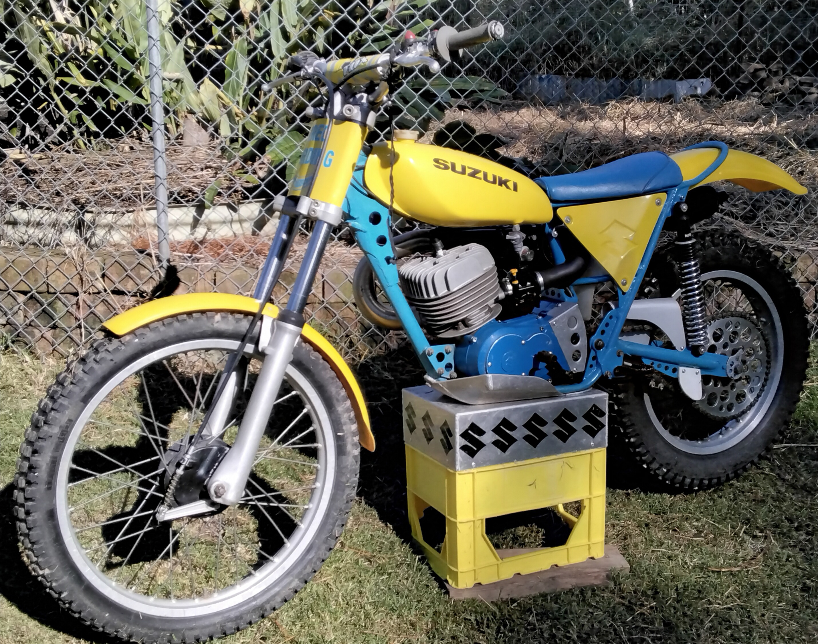

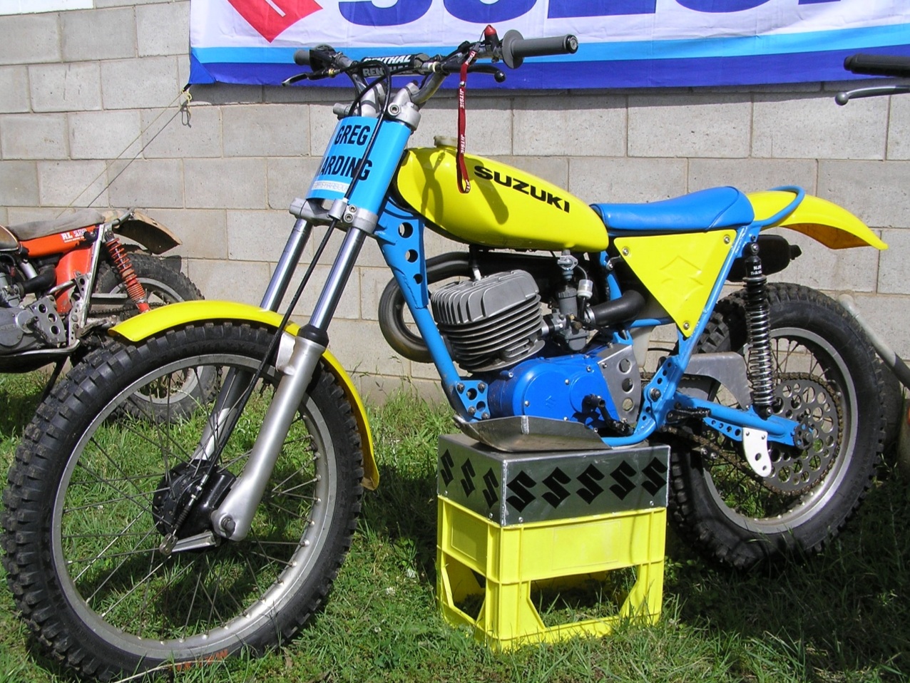

SQUEAMISH SEVEN YEAR ITCH SPOT THE DIFFERENCE?
Just sharing what I have been up to with a comparison from then and now. The first photo by David Lahey back at Twinshock Masters in November 2015:
The second photo was taken today by me. Excluding the Brick house of gas, gas being the by-product and everything else in the background.
Can you spot the differences? Please post your answers here and will confirm or deny.

Greg ... You seem to have painted that carb stealth black and for very obscure reasons have undrilled the holes in the shark fin
And what has happened to that fork brace ... Must have been beefed up to better support that flash front guard.
Footpeg relocation

Is that the standard size rear sprocket ?
It still looks great, Greg
Footpeg is lower.
Exhaust header is bare metal finish.
Carby is black and is a different type.
Chain is not adjusted as tight.
The bar pad is different.
Name plate is a different colour.
Lanyard elastic is a different colour.
Clutch lever is different colour.
Brake lever is different colour.
The petrol in it is newer than 2015.
Footpeg is lower.
