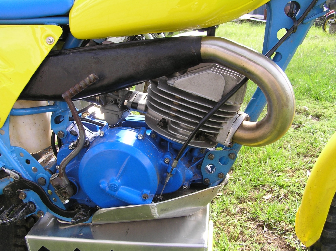

Fuel filter different
chain guide just above front sprocket attached to frame is gone
Posts: 906
SQUEAMISH SEVEN YEAR ITCH SPOT THE DIFFERENCE?
eagle wrote:Fuel filter different Yes
chain guide just above front sprocket attached to frame is gone Not sure what you mean here as there was never a chain guide above front sprocket
David Lahey wrote:It still looks great, Greg Thankyou
Footpeg is lower.Yes both
Exhaust header is bare metal finish. Stainless steel header is the same but may look different because of shadows and heat tanning
Carby is black and is a different type. Yes OKO
Chain is not adjusted as tight.Aha Yes
The bar pad is different. Yes
Name plate is a different colour. Yes YELLOWfor Denman
Lanyard elastic is a different colour. Yes
Clutch lever is different colour. Yes
Brake lever is different colour. Yes
The petrol in it is newer than 2015. Yes and I never leave petrol in bikes when not in use!
eagle wrote:Is that the standard size rear sprocket ? Yes 54T is standard fitment on a SQUEAMISH :D
tat ty wrote:Footpeg relocation Yes
tat ty wrote:Greg ... You seem to have painted that carb stealth black and for very obscure reasons have undrilled the holes in the shark fin Yes, apparently lightening holes make them weaker, who would have thought?
tat ty wrote:And what has happened to that fork brace ... Must have been beefed up to better support that flash front guard. Ummmm not sure what you are seeing, same forkbrace and guard!

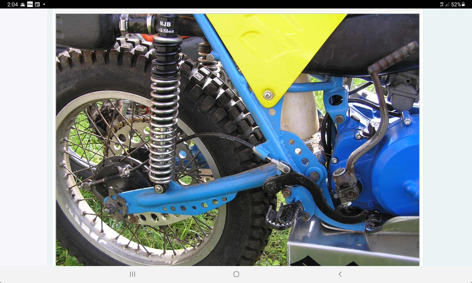

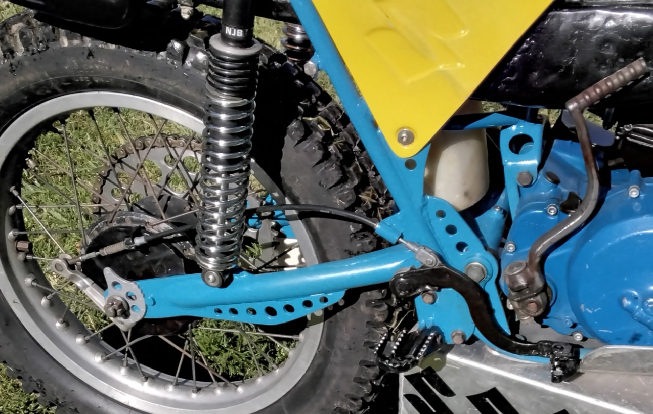

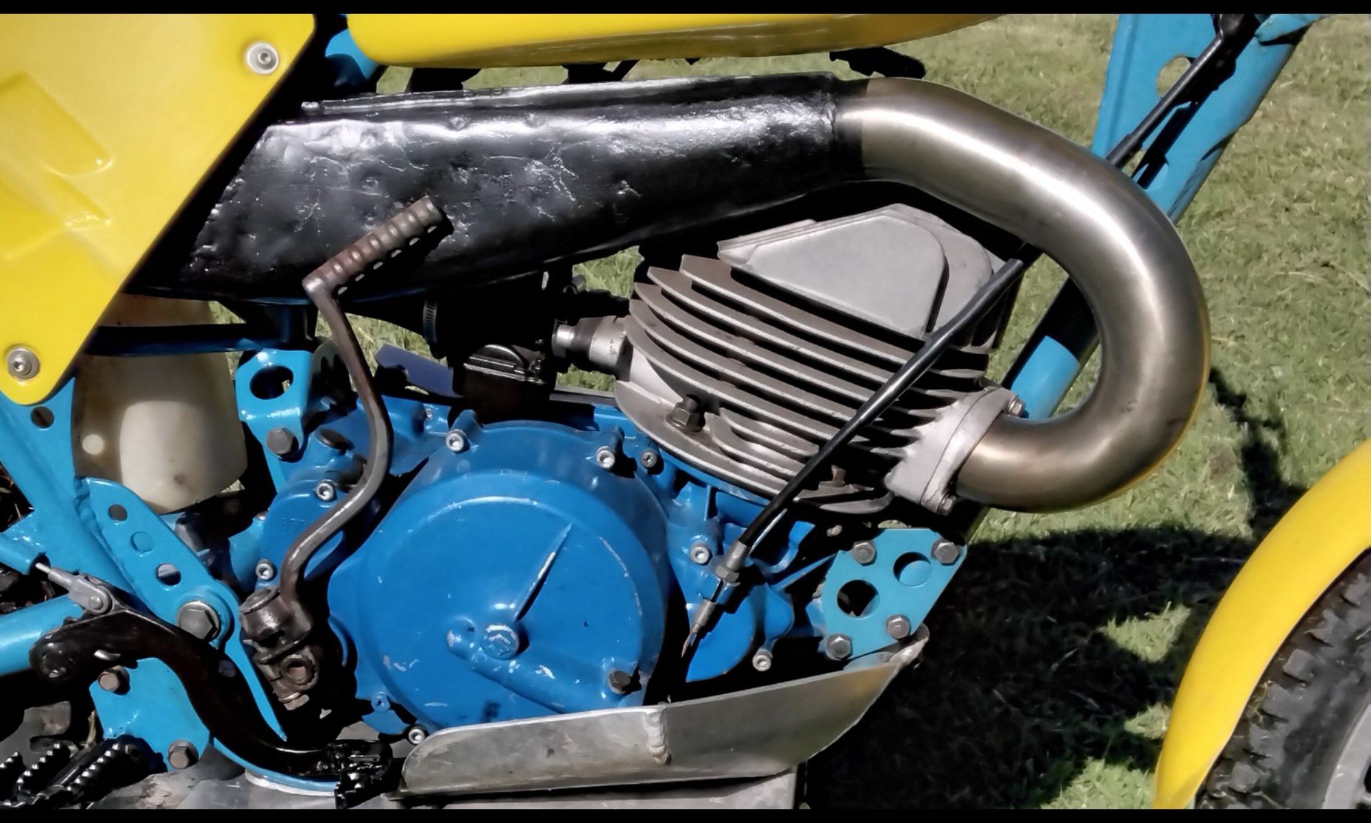

These next photos might confirm some things and might reveal others?
Photo courtesy of David Lahey 2015 Conondale
Photo by me on Sunday:
Squeamish 2023
Squeamish 2023

Looking @ the first picture again, i can see it is the besser block wall behind the bike, being a grey colour it looked like it was a bike part to me :)

Here are more comparison photos:
Photo by me last Sunday
You've modified the :suzuki Squeamish brake pedal to suit the new footpeg location

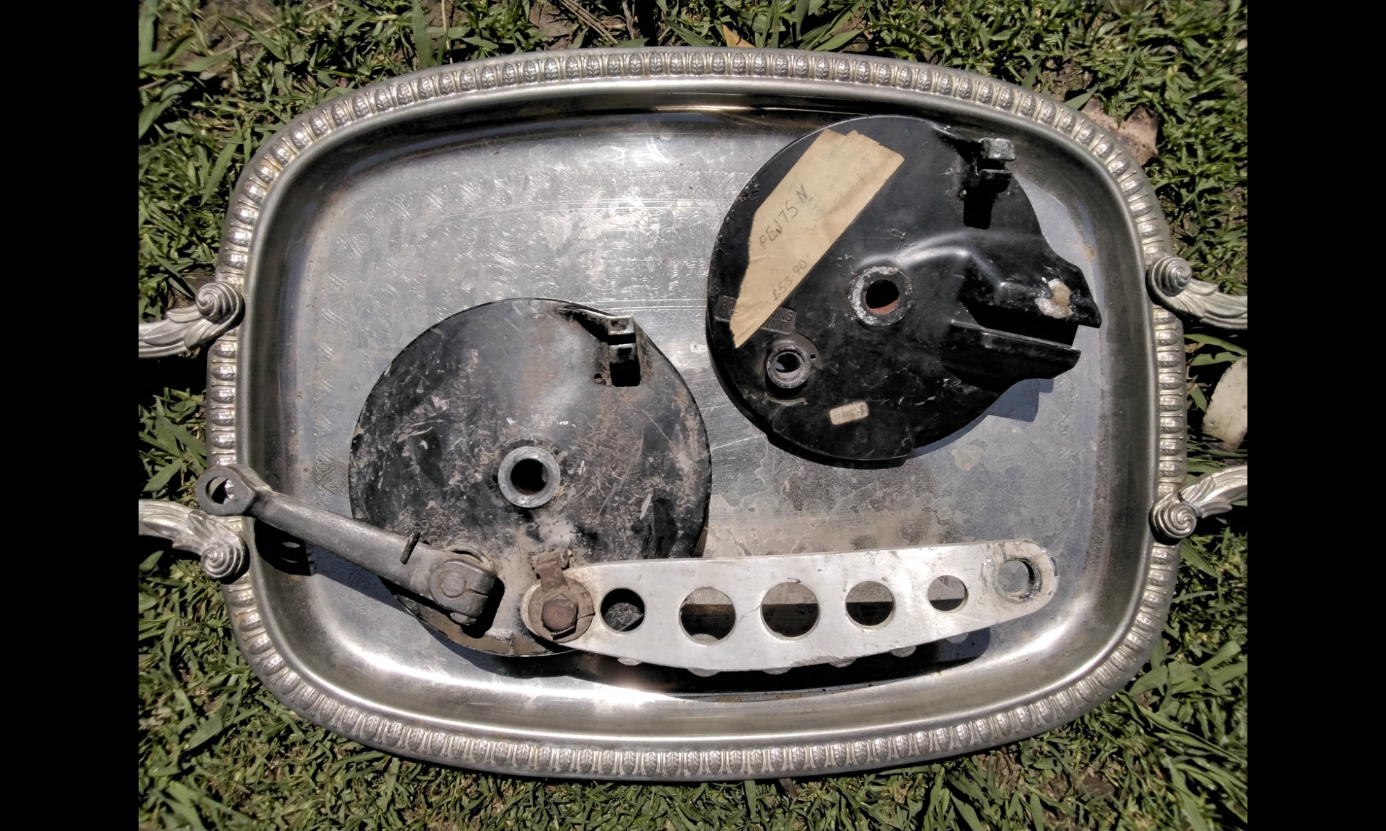

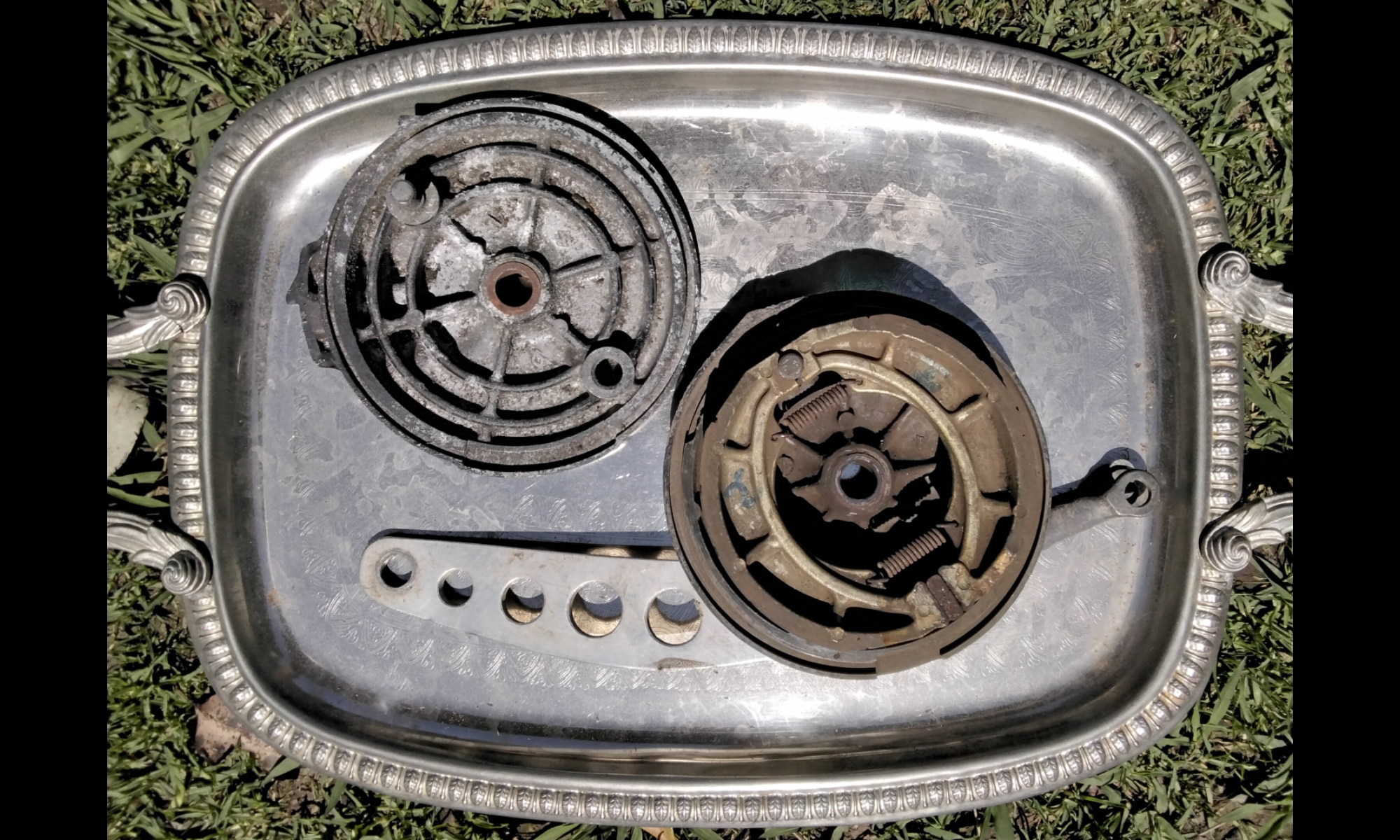

Remove the aluminium bracket for the rear brake, does that mean it really had no purpose ?

Definitely some wizardry on the stator cover. Looks to be very custom and too shiny.
You also changed the shocks from NJB Experts to NJB Trix Shoxs.

Rear brake backing plate now anchored to the swingarm via a slot in the plate and tab on swingarm?

eagle wrote:Remove the aluminium bracket for the rear brake, does that mean it really had no purpose ?
Yes I removed the torque arm and Yes it had a purpose, see photos:
Rooney wrote:Definitely some wizardry on the stator cover. Looks to be very custom and too shiny.
Yes, the access panel is there for clutch adjustment and I must be terrible at changing gears because the gear lever decided to do an adjustment! So I saved the pointy "S" and made a new panel.

brent j wrote:Rear brake backing plate now anchored to the swingarm via a slot in the plate and tab on swingarm?
Yes, I thought you might find that interesting! It all started when I was given some new old stock parts includingthat brakeplate.
