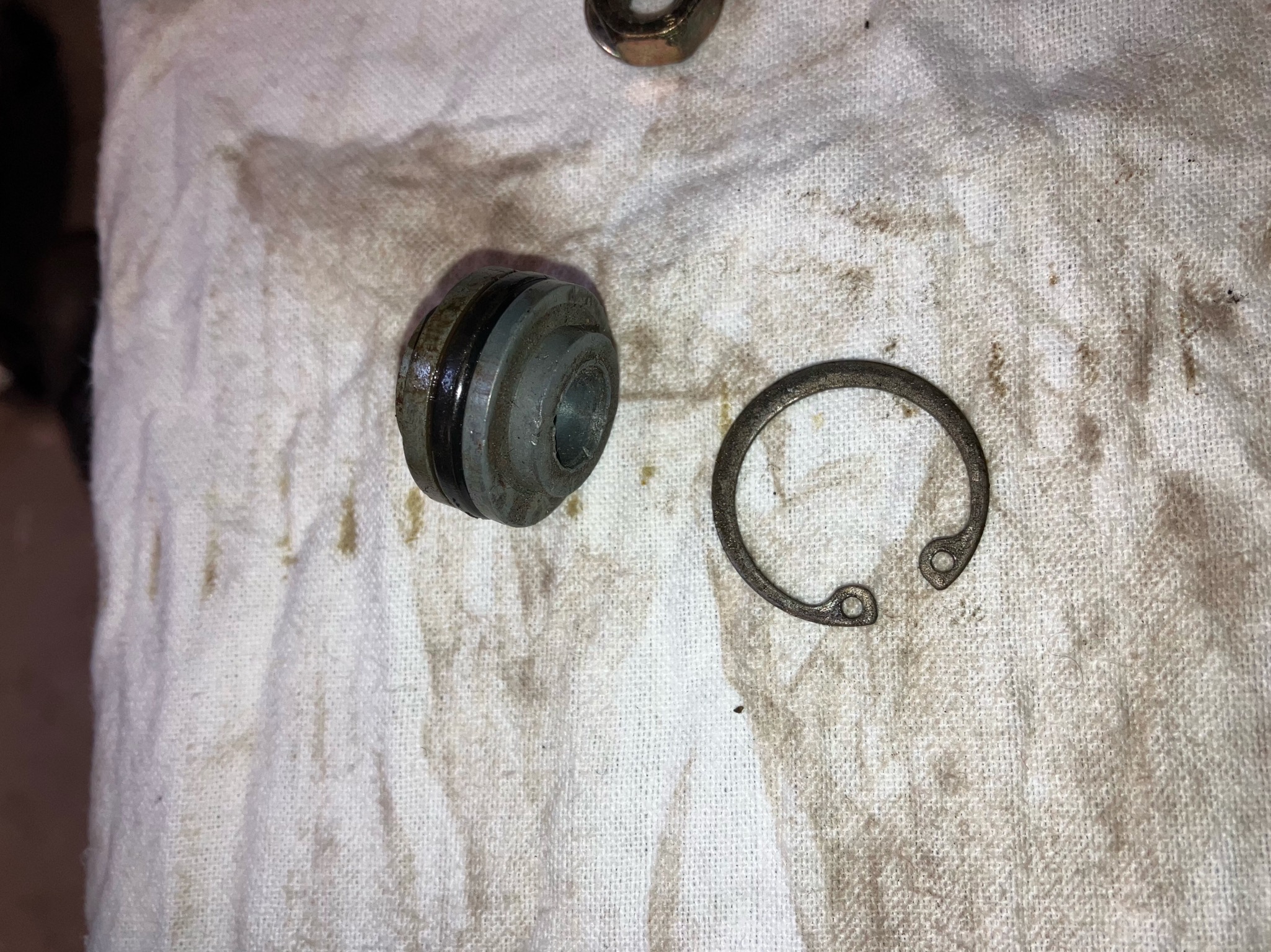

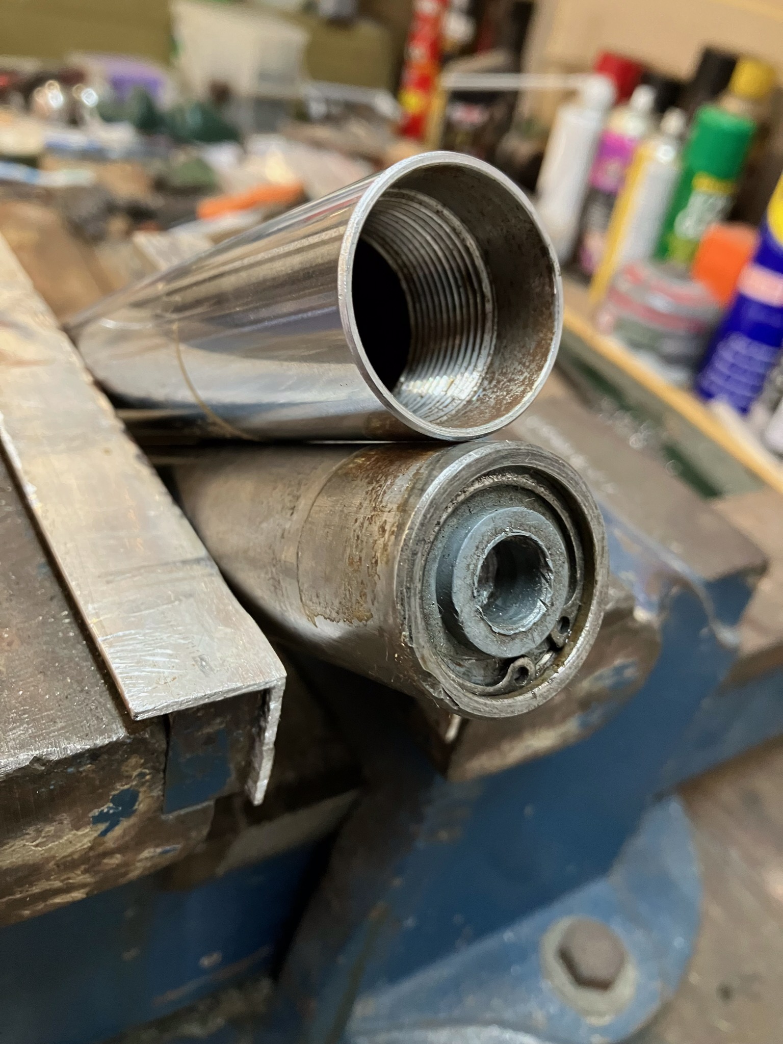

The NOS forks had gaiters on them when I bought them and unfortunately some moisture had gotten in while in storage and there is rust which has left pitting in the stanchions :?
Inmotion Trials had NOS 172 stanchions for sale so I bought them.
Now, my original stanchions and the NOS forks both have the spring retainer as a simple plug with O ring seal and held in place with a circlip.
However the “new” stanchions have a thread in the top for what I think is a pressure relief valve that also retains the spring.
Top is “new” stanchion and the bottom is the original.
I believe these were only fitted to early 172’s but certainly not mine.
Here is the parts manual.
I have not been able to find a relief valve but an option may be to have two plugs machined to screw into the stanchions with an O ring and spring seat machined into them.
Re: Cota 172 Restoration
If you measure up the thread pitch and thread diameter and the diameter of the smooth bit where the O ring seals against, I'll check if some Spanish fork caps I've got here are the right size for those tubes
Phil 850
Posts: 120
Location: Western Sydney
Post by Phil 850 »
Thanks David
The bore share the O ring would seat is 28.45 mm, so I guess the OD of the thread would be 28.
The thread pitch is 1.5 mm.
The internal diameter of the thread is 26.5 mm.
I’ll check these dimensions again tomorrow just to be sure.
Regards
Phil

Hi Phil I found the Spanish fork caps I was thinking of and the threads are 25 x 1.5
Thanks David
I appreciate the assistance.
I might have to see if I can get something machined up.
Phil
