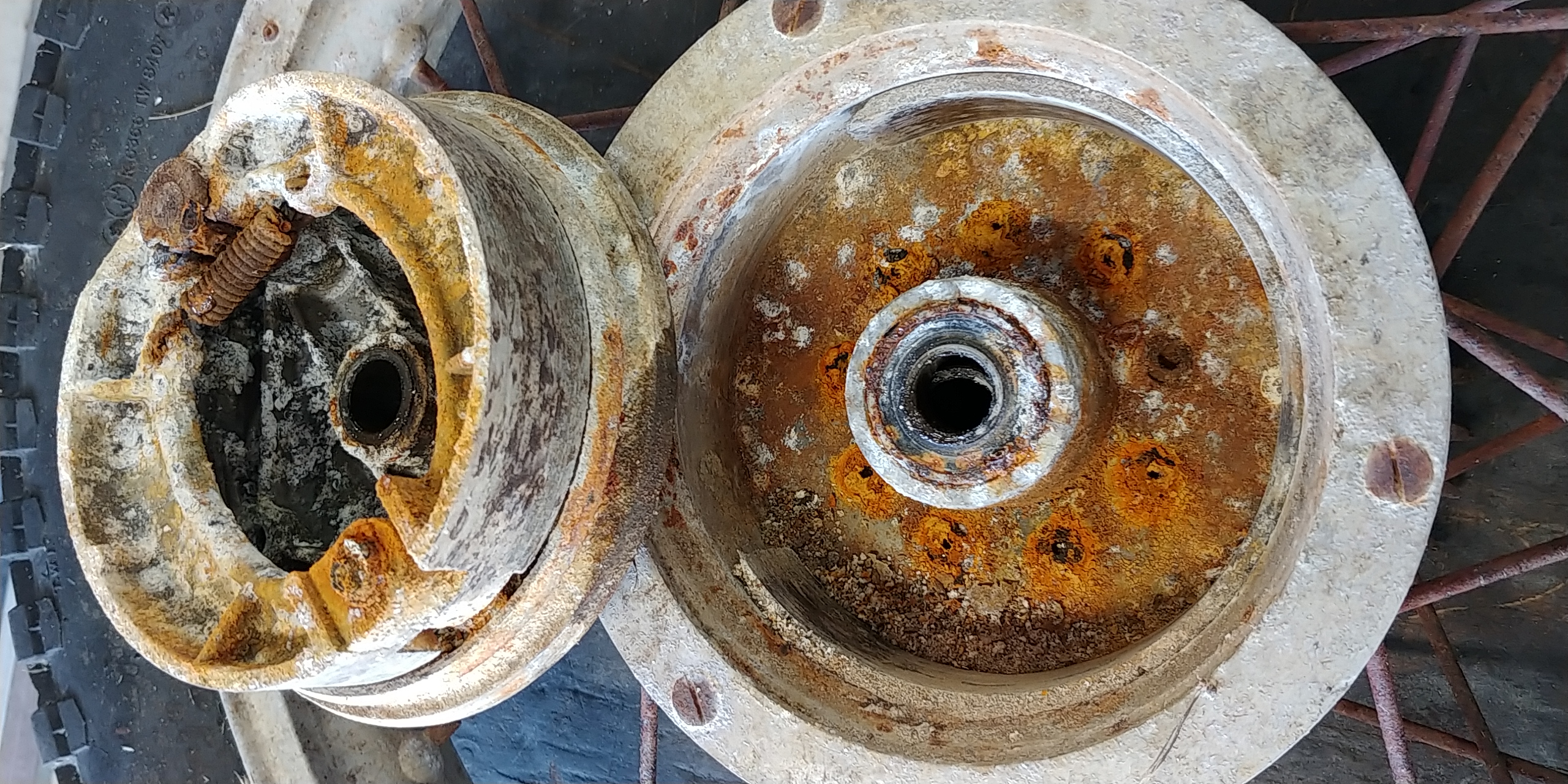

I acquired another Basket Case recently and while it still had both wheels in position, the rear wheel was not keen to rotate, making moving the Basket Case around a high energy event.
This Basket Case is the remains of a :Bultaco: Model 137 Alpina that had sat for a very long time in the shade, but at the seaside.
This photo shows why the rear wheel didn't want to turn. The brake linings had parted company with the brake shoes and the chrome drum lining had formed corrosion blisters that had grabbed the brake linings.

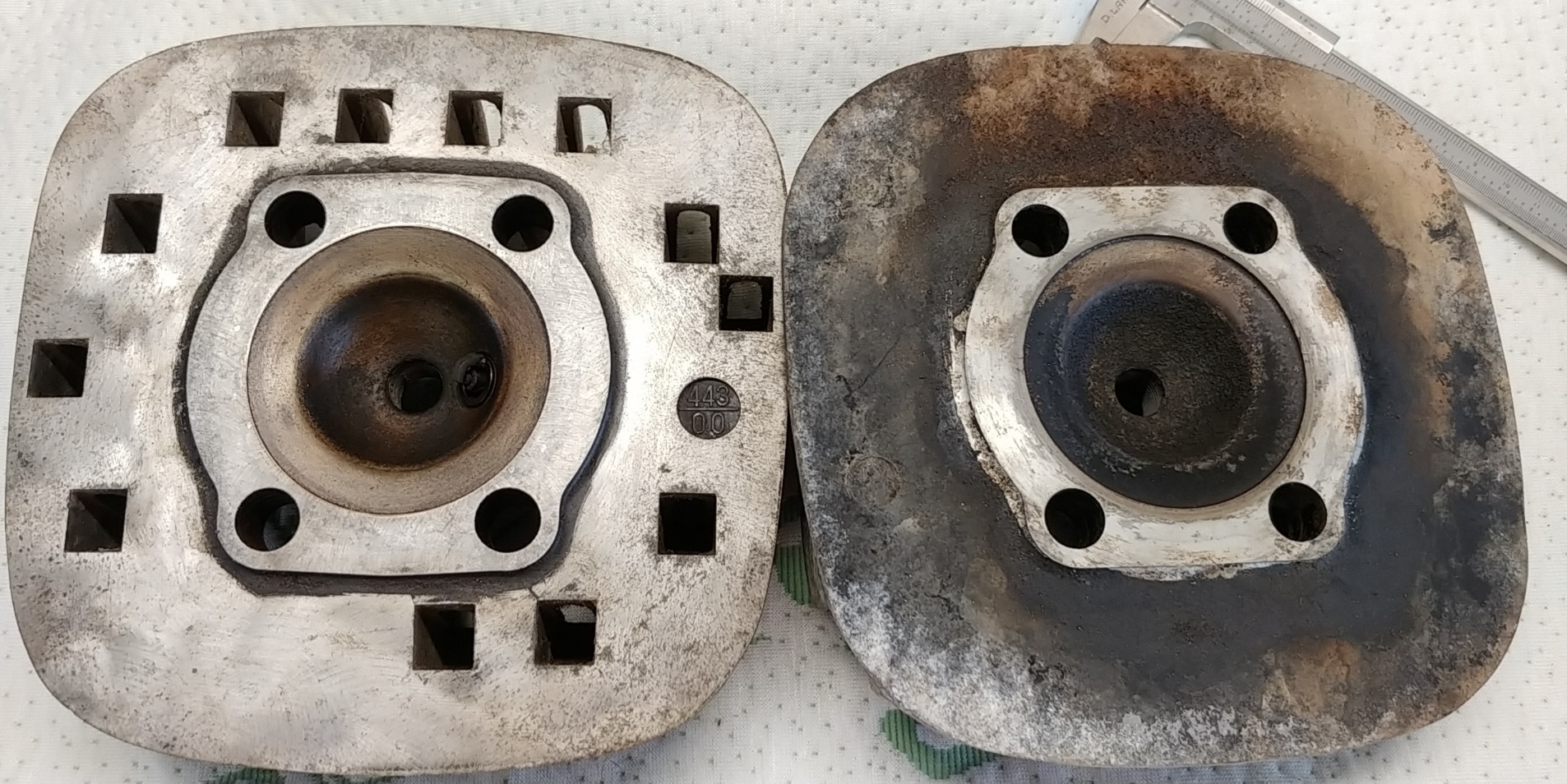

Here are photos of the two heads in question. A DT175A ( :yamaha model 443) head and :yamaha TY175 ( :yamaha model 1N4) head.
Measured with my eyeballs, the combustion chamber appears to be the same shape on both and the squish band has the same angle and width on both. Where they differ is in the step up between the squish band and the gasket surface. The TY175 head has a 1.5 mm step and the DT175 head has a 1.2 mm step. So to answer your question, yes you could replicate the compression benefit of the DT175 head by machining the gasket surface on the TY175 head, as many people have done. An even more common trick with the TY175 is to use a thinner-than-standard head gasket or no head gasket to increase the compression ratio.

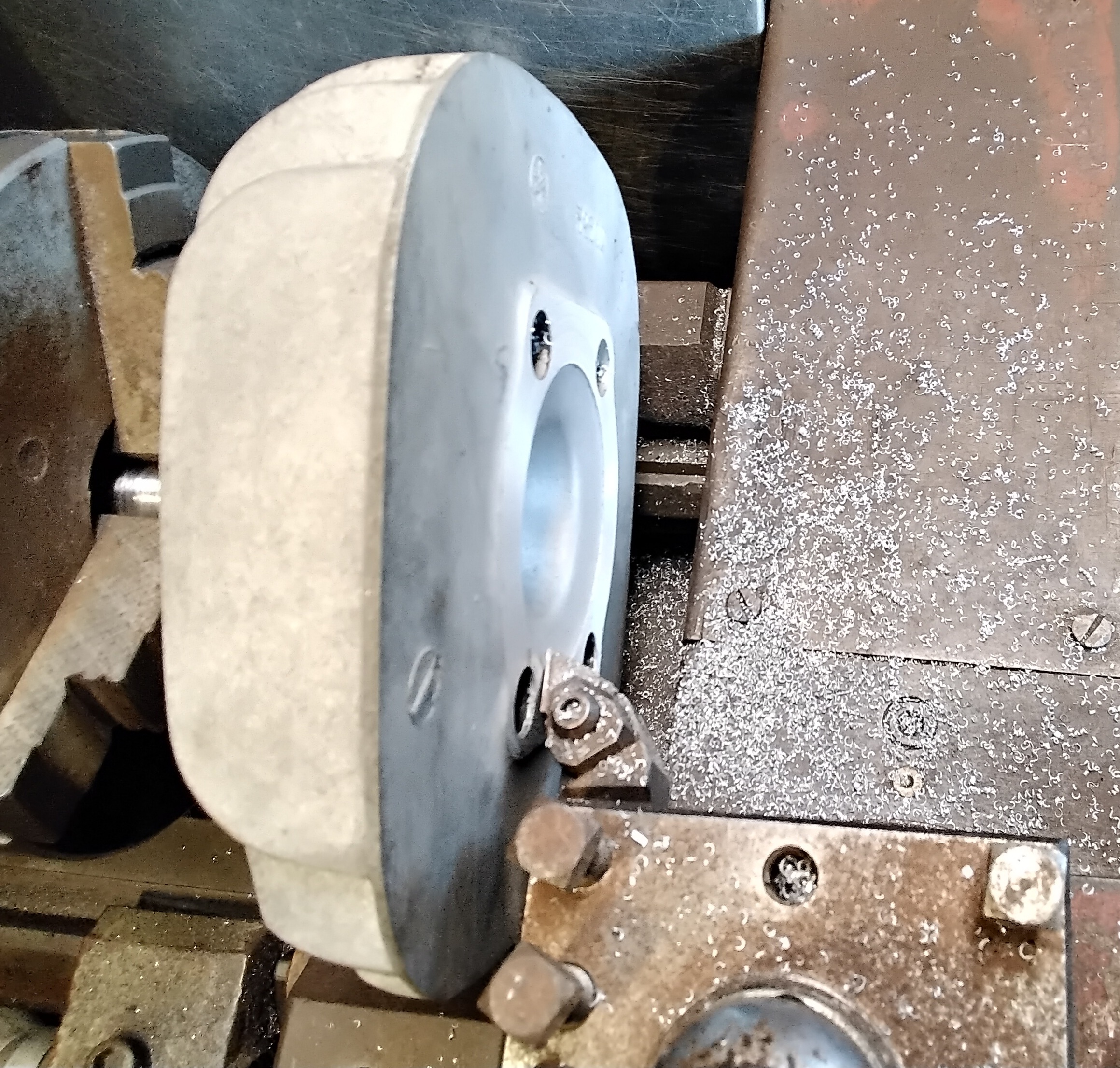

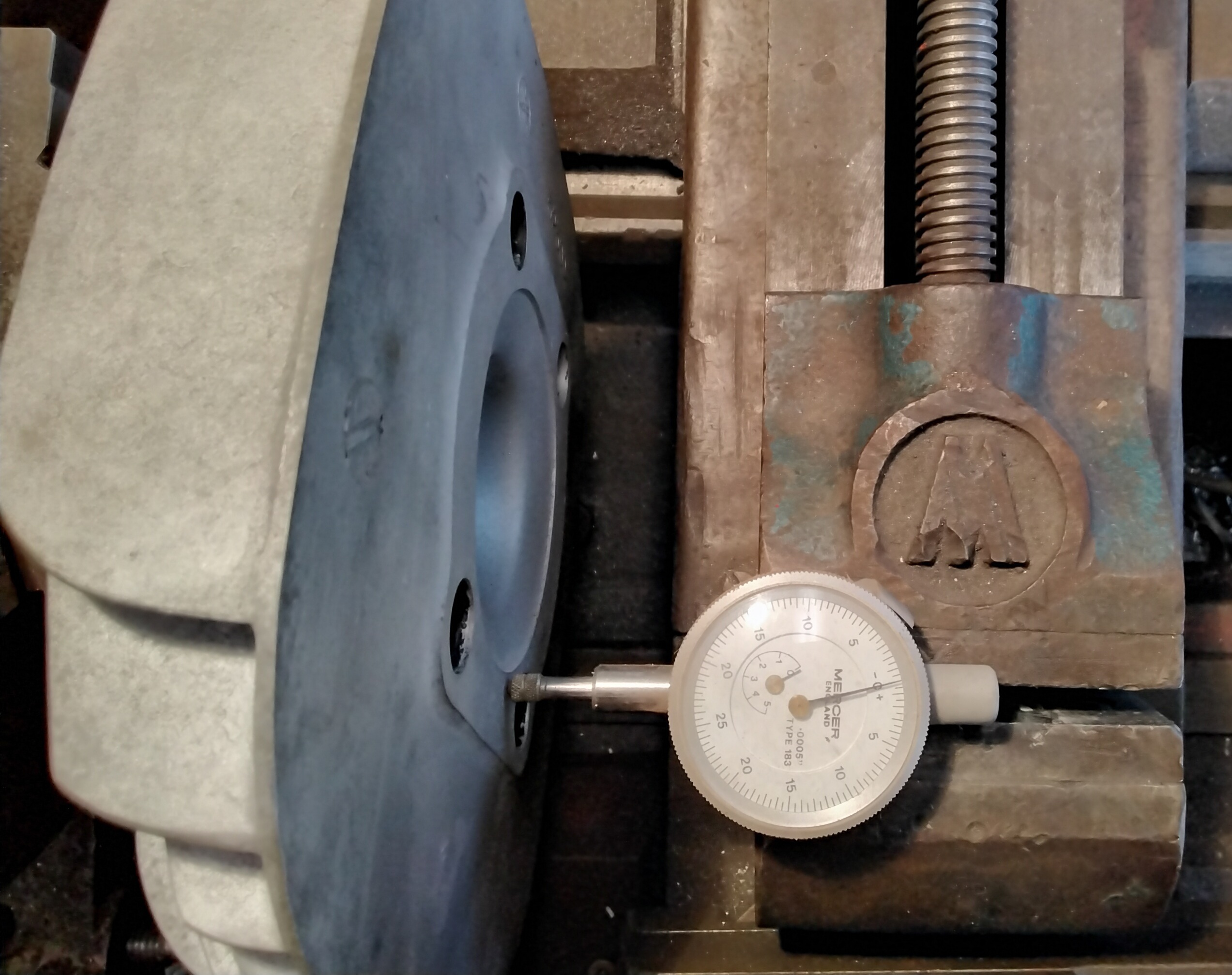

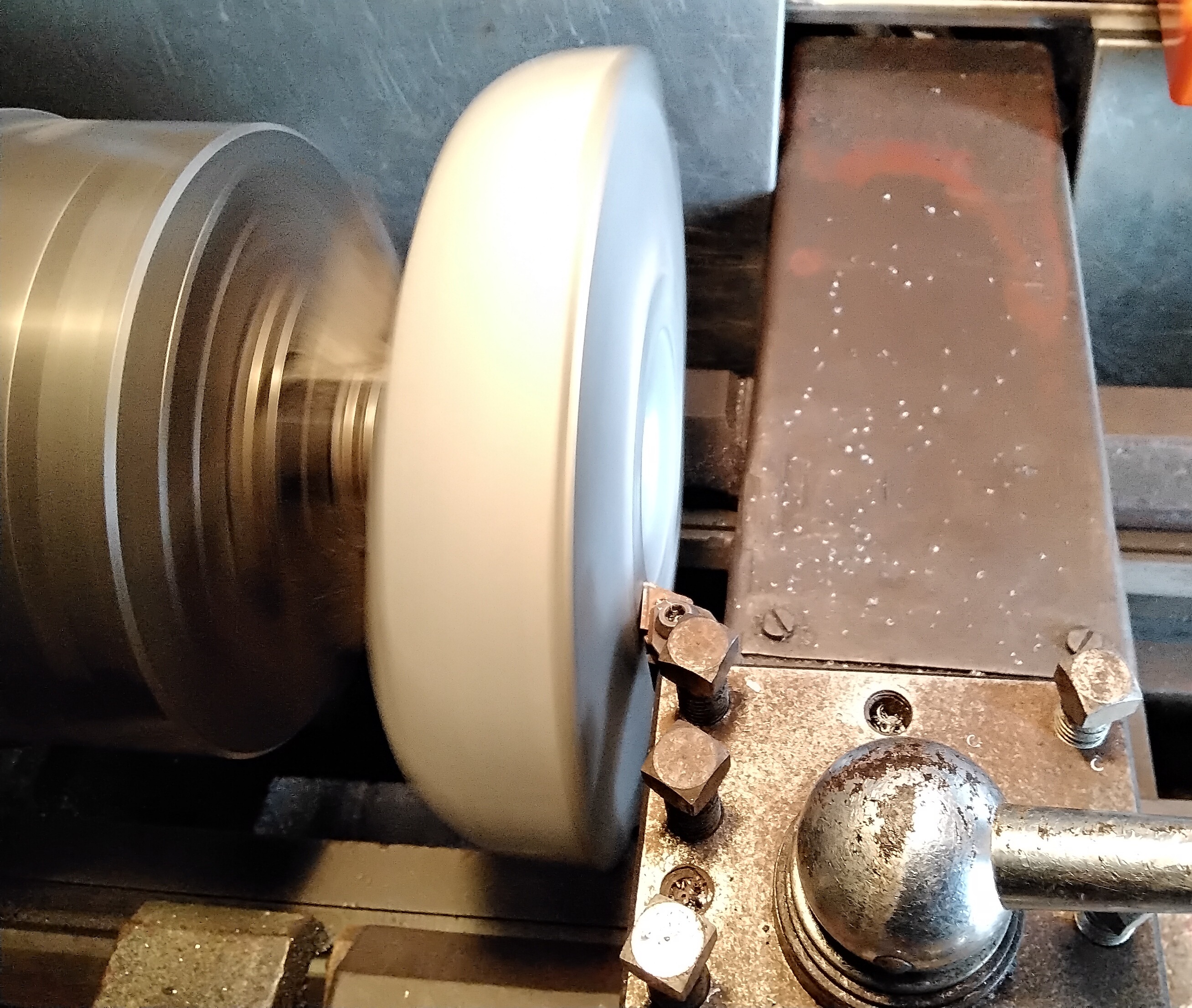

After pondering this for some time, my conclusion is that I don't like the look of mismatched head and cylinder and I don't feel the need for a spare spark plug. So I have made an arbour in my trusty Brunswick engine lathe for machining a :yamaha TY 175 head to match the higher compression DT175 head:
First of all is to get the head to spin true:
First cut:
Final cut removing a total of 0.3 mm:

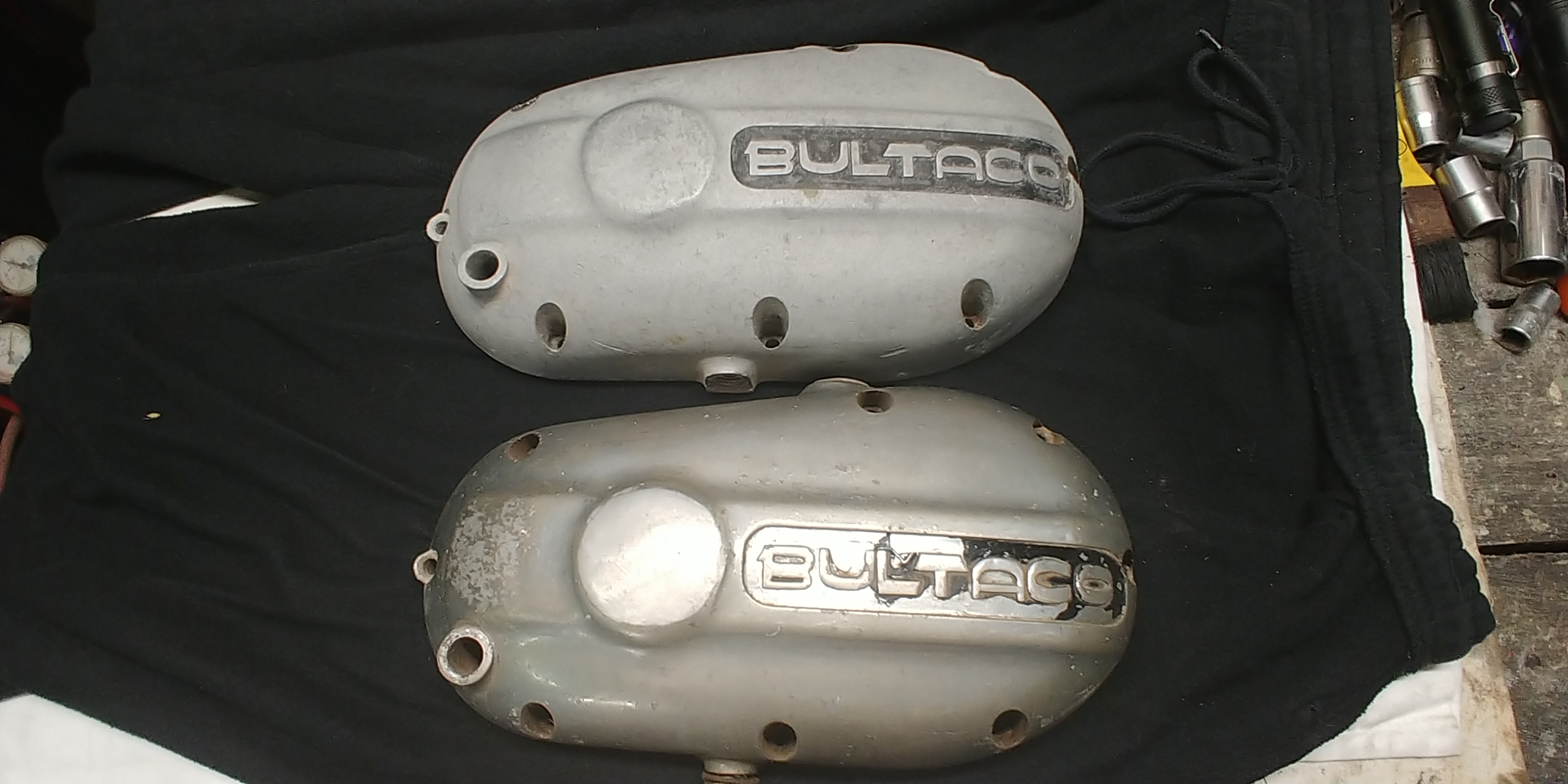

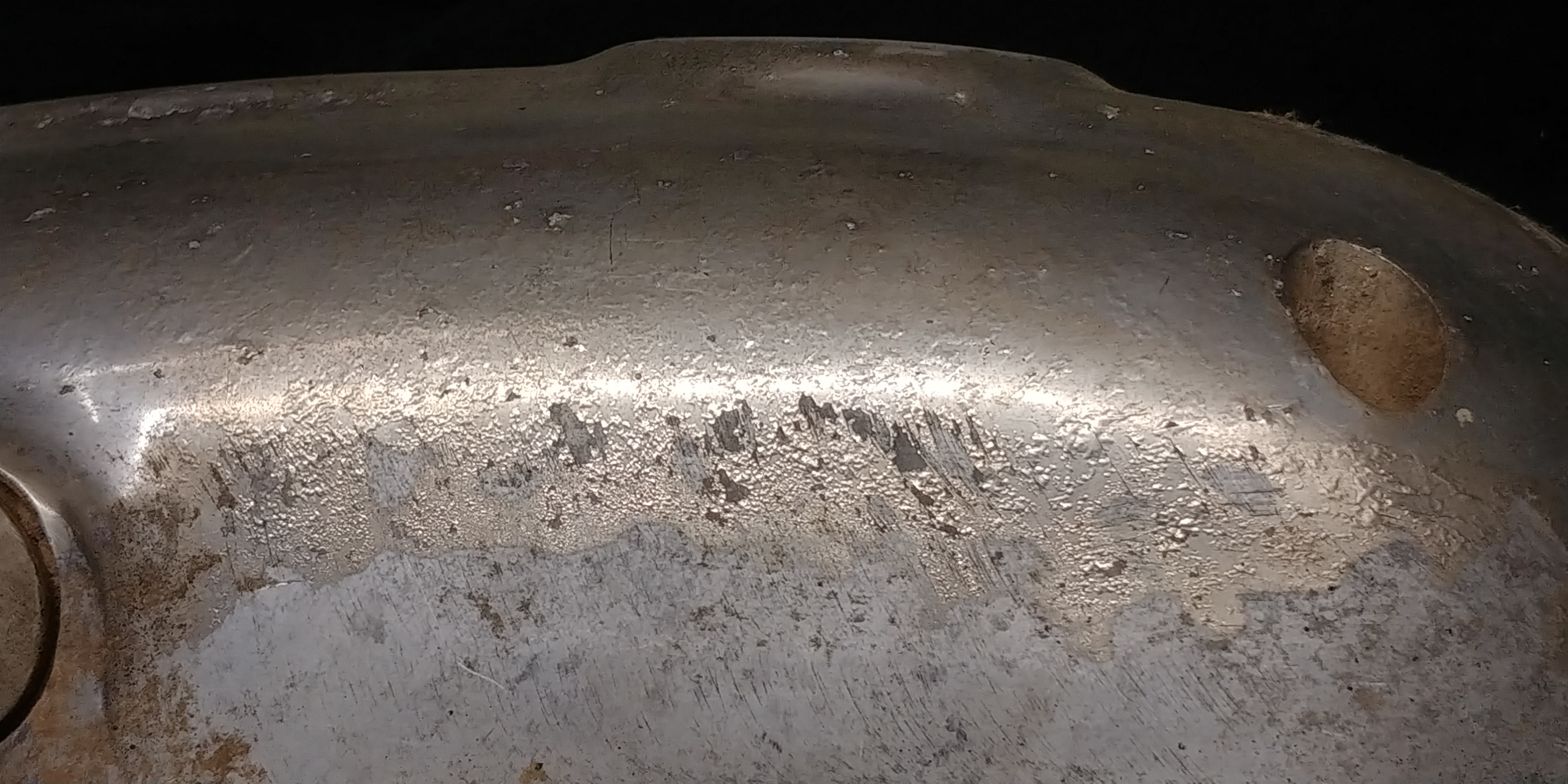

Kurt's post reminded me that I hadn't yet posted photos of the dreaded chrome plated :Bultaco: engine outer casings.

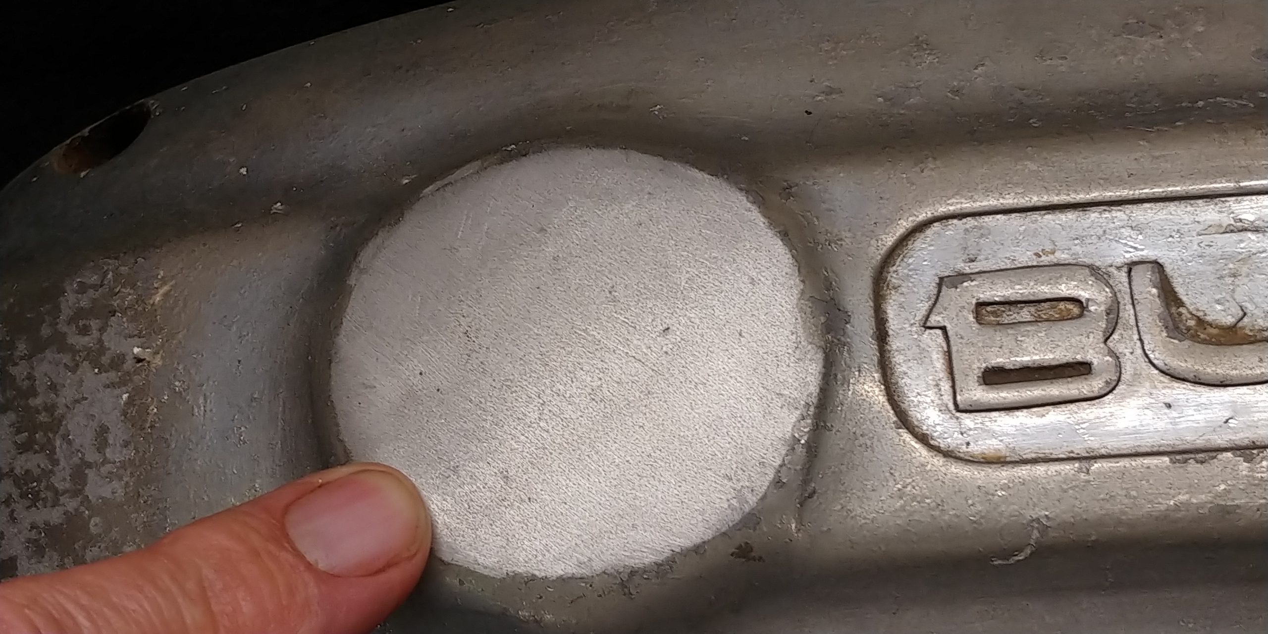

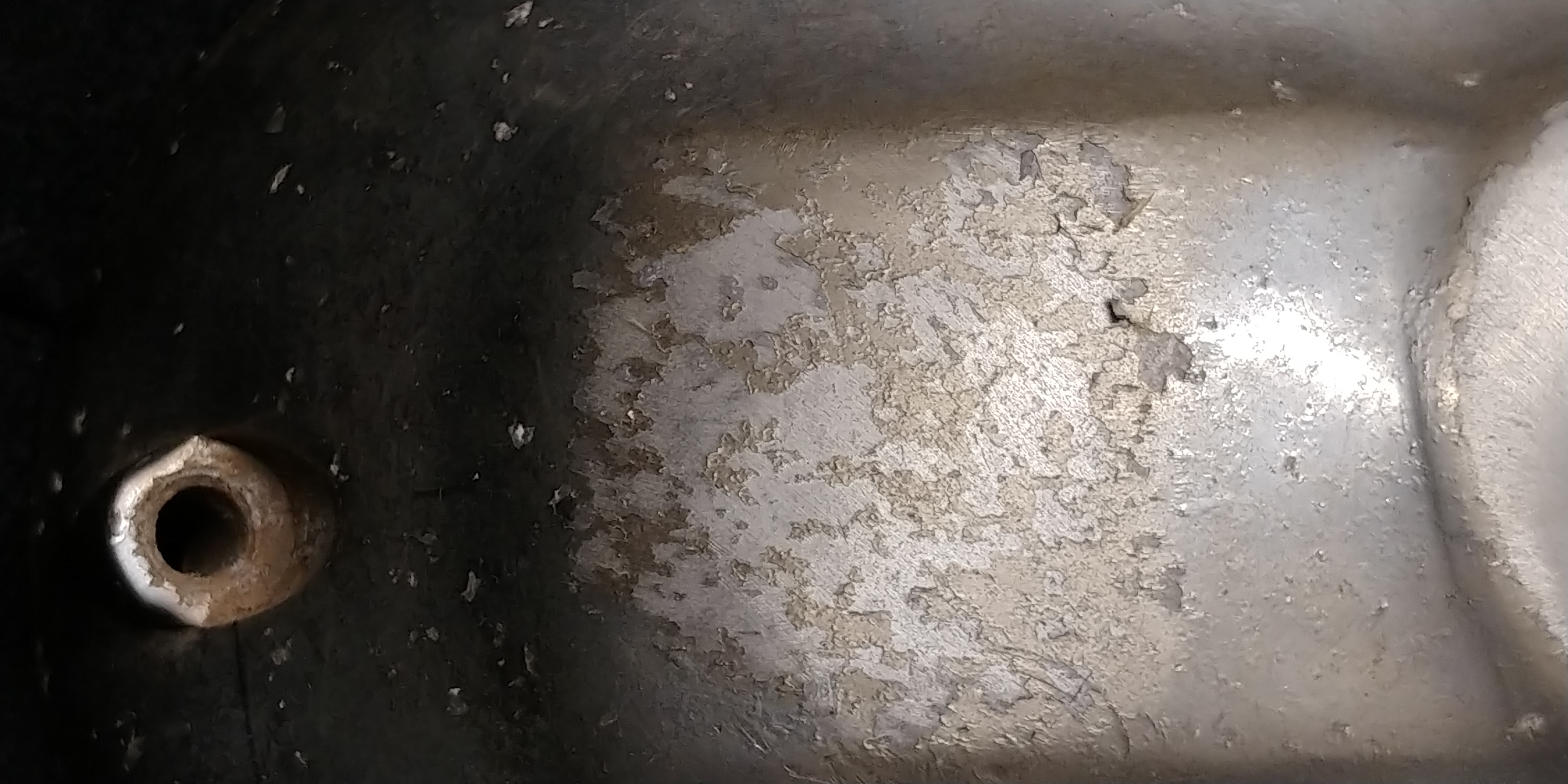

In 1969, :Bultaco: shiny plated the outer engine casings of some models. I have no idea why, but I do know that the plating eventually starts to flake off and I haven't found a way to make them look as pretty as polished aluminium looks.
These :Bultaco: primary drive casings were made close in time. The plain aluminium casing I'm thinking was made in 1967 or 68 and the chrome plated casing in 1969. I don't think either of them has ever been refurbished so it is a pretty good comparison of how well they have fared over the years.
The problem with the flaking chrome is that the chrome is much harder than the aluminium so if you use dry blast to remove the plating, the aluminium will get damaged. If you try and use electrical current to remove the plating, the aluminium will dissolve way faster than the plating. In one photo I've pointed to a spot where I stripped off the plating with an abrasive disc. It worked fine there, but would be useless on the bits that are recessed, like the :Bultaco: logo.
