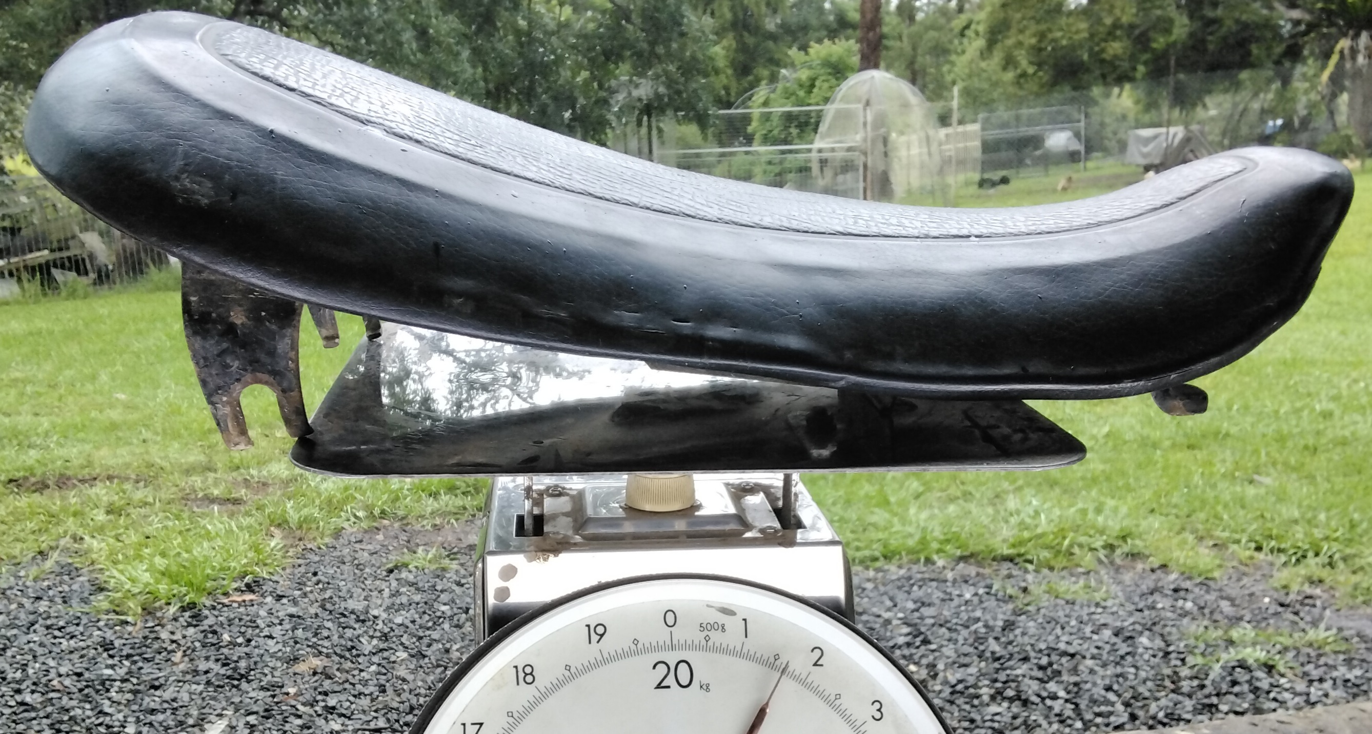

So my :honda: TL 250 theory has now changed, I used to think that when :honda: made the TL 250, they panicked about the weight so they made the tank out of aloooominium....... The stated 99 Kilograms was a bit optimistic but I understand why they were worried about tripple digits!!!! Now that I have weighed the seat (goes on after the tank):
My new theory is they chose a 600 gram lighter flywheel and hoped for the best!

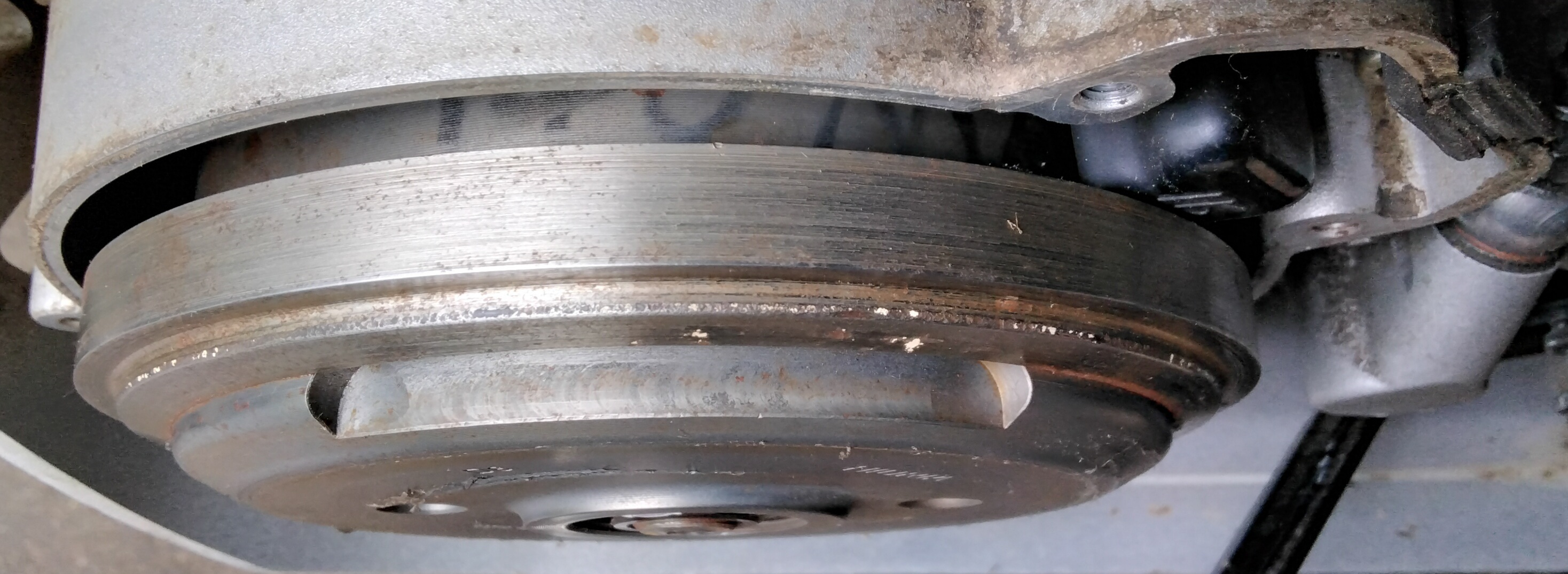

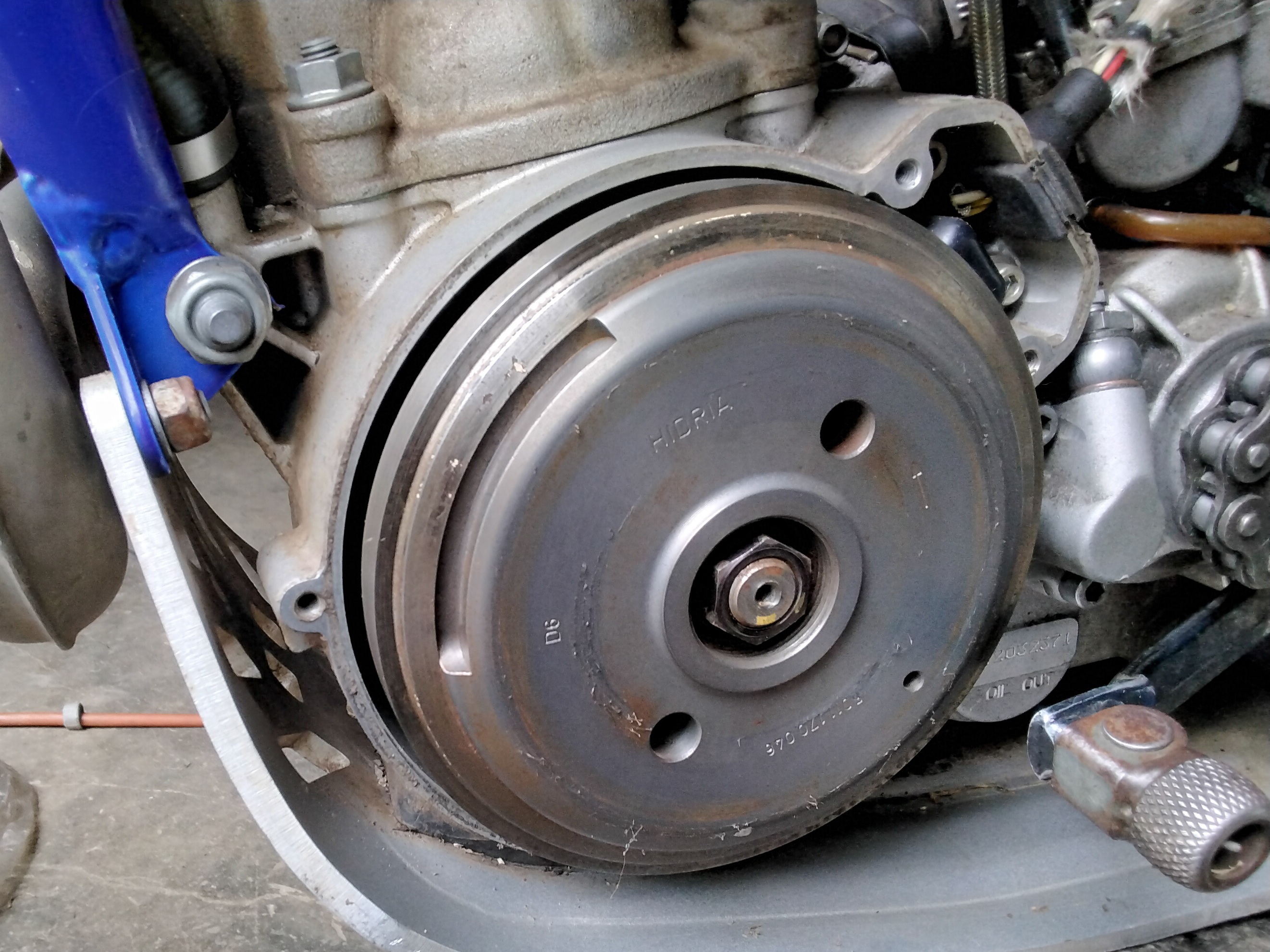

This is not about a Twinshock but it is relevant here, Donna's bike Shirley :sherco 125 was a little racey for her so I tried to source a flywheel weight and no such animal anywhere! There was an old truck axle that held my door open, it had a nice sizeable flange for mounting the wheel on. So we machined a ring out of it and heat-shrunk it on. The outside diameter was what was left after machining the stud holes off and the width was worked out to clear the pick up and cover but I did not weigh it.
It has been on there for years now and certainly made it more rideable.
