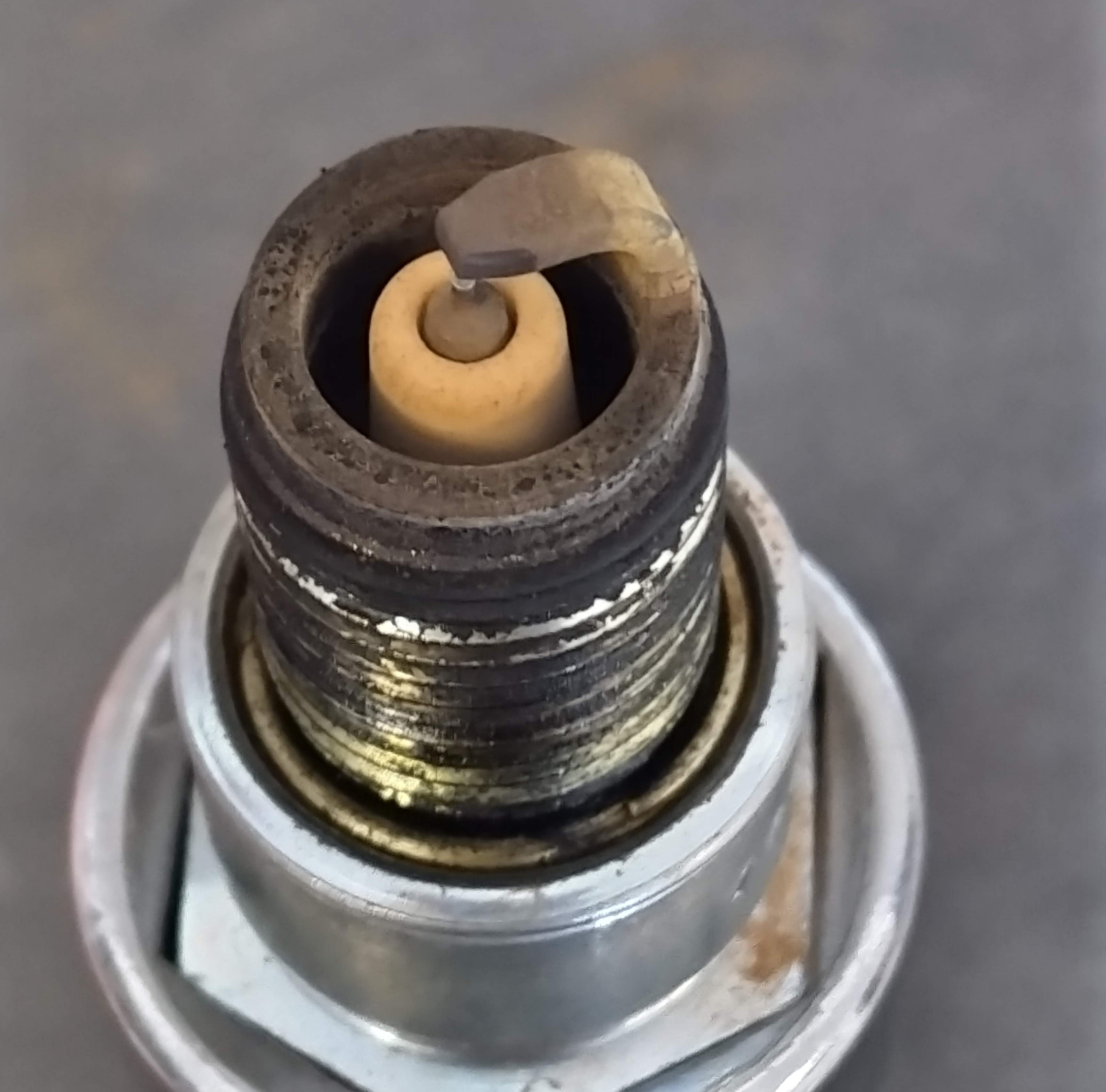

That aside, I have attached the pic of my current plug (iridium because my current model allows standard plug) but my bpmr6a was similar in the 2018 bike. I have run boyesen reeds in both of my TRRS 125's, optimised my jetting and importantly changed my needle from a jjh to a jjj - slightly leaner in that critical just off idle - 1/8th throttle position that I have found in each TRRS i have ridden, which just has a very slight "burble" - ie slightly rich and is a range perhaps well used puttering in sections. While some of my fellow riders would say "get over it - just twist the throttle more", I do like to understand and optimise my carby to my needs - sealevel to about 400m and the warmer climate here in
and I am known for delicate throttle twisting.
May be when someone looks at my spark plug below they will say it is too lean, or too rich on the main or has deposits from additives ??? But my bike runs well, does not foul plugs, starts easy, does not ping and is the same plug for a year or more.
The Boyesen reeds (to me) give better performance (torque and consistency in response) low down and great responsiveness through throttle range. The pic of the sparkplug was after a practice ride at our clubs Trial Park (3ha) and not a plug chop after a full throttle firebreak run.

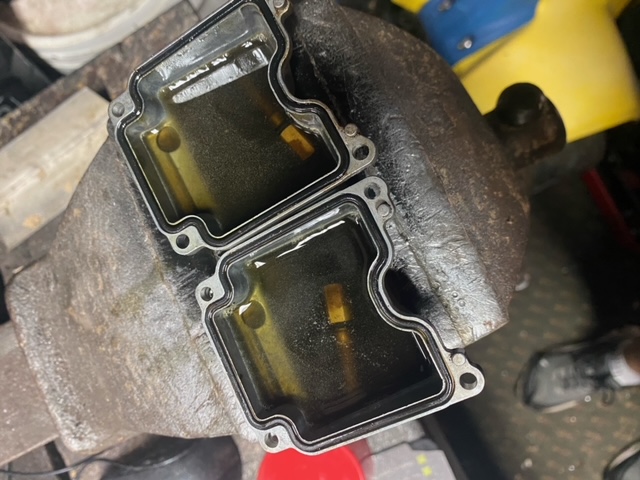

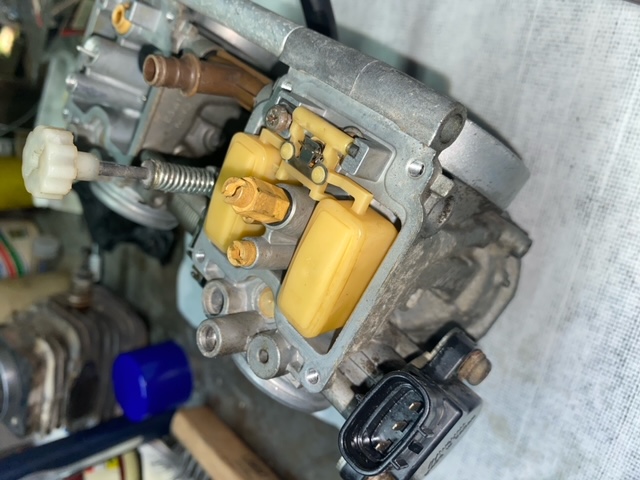

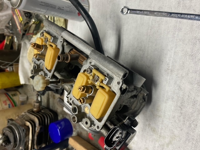

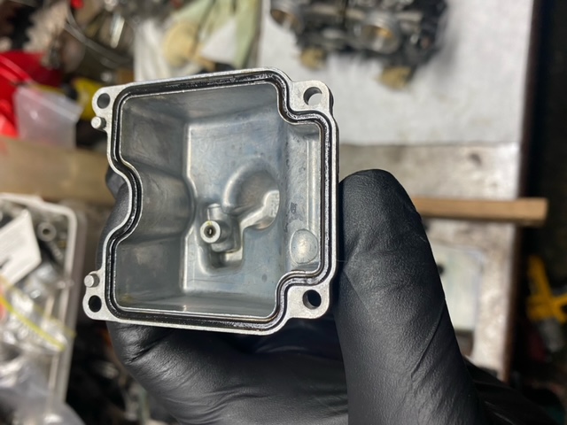

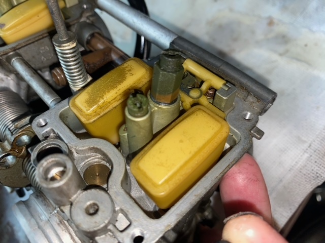

Thought I’d post some before and after photos of some carbs I just cleaned using the Subaru cleaner.
I removed all the jets and floats and needles. Also the emulsion tube so I can clean all the passages.

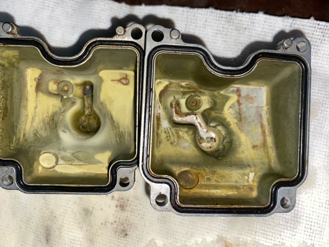

It needs to soak for about an hour. I put all the parts into the float bowl and keep topping up with foam spray. I use a nozzle on the spray button. Sometimes it doesn’t come with the nozzle, so use one off my WD40 tin. Don’t leave in solution overnight as it goes salty looking. I clean it off with brake cleaner. I know, more money. Also use in a well ventilated place.
