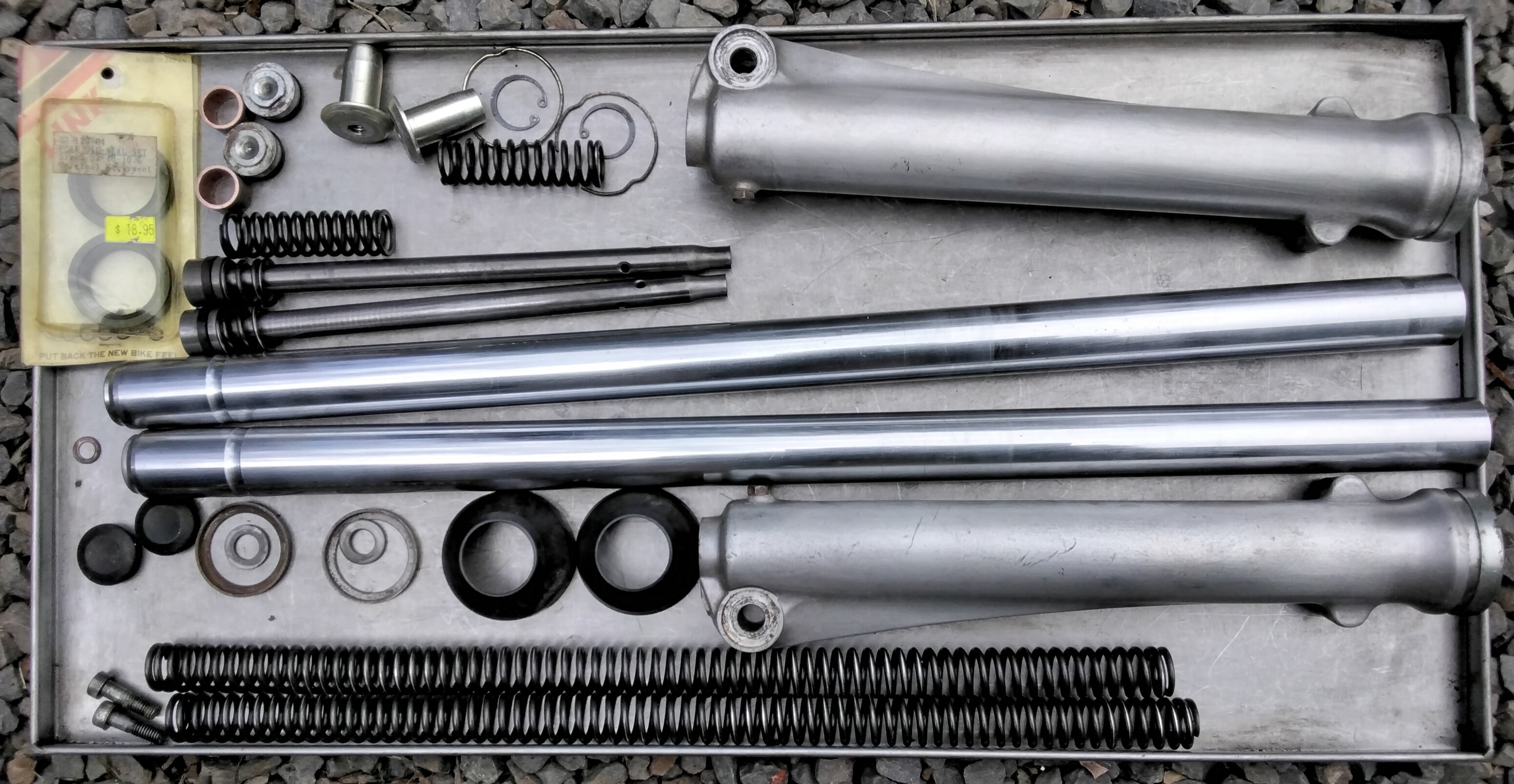

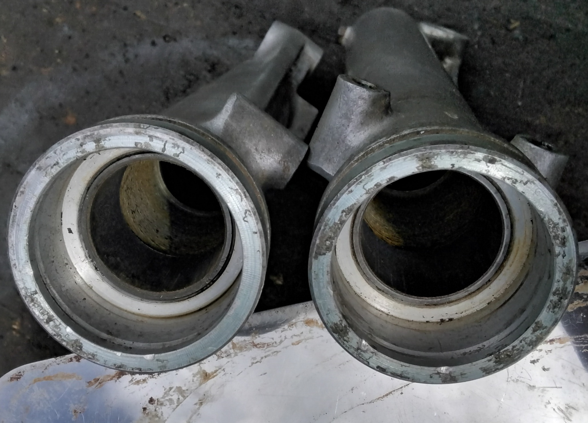

One of the other things that made it better was slightly more preload in the forks and new seals. When they made these, they were not cutting corners on quality or materials used:
2 kilos per leg!
2 kilos per leg!
These fork seals came to me with another TL 250
Here is something that I have not seen before in bikes from the mid 1970s, the sliders have guides as standard, this might be an option for worn sliders on other bikes.

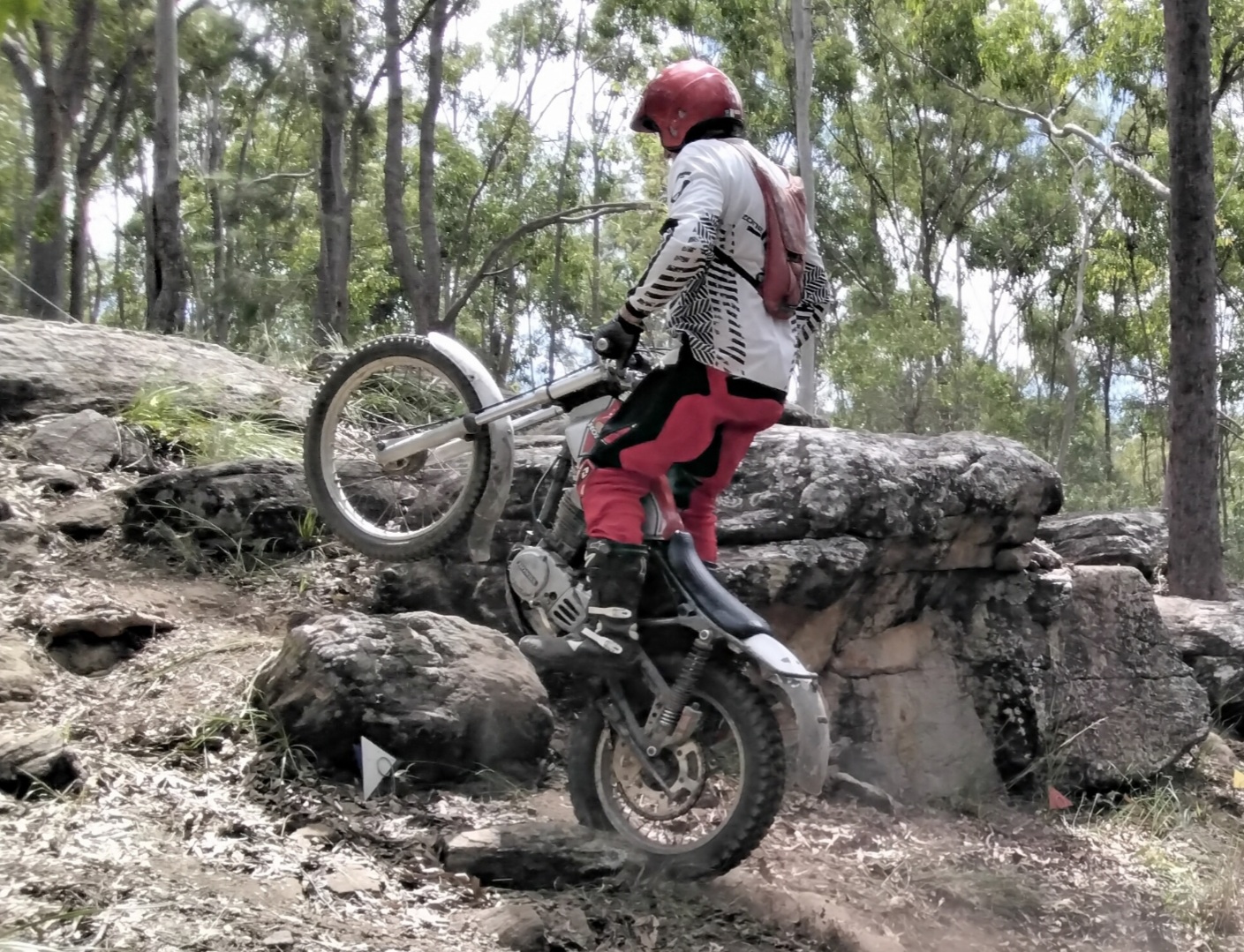

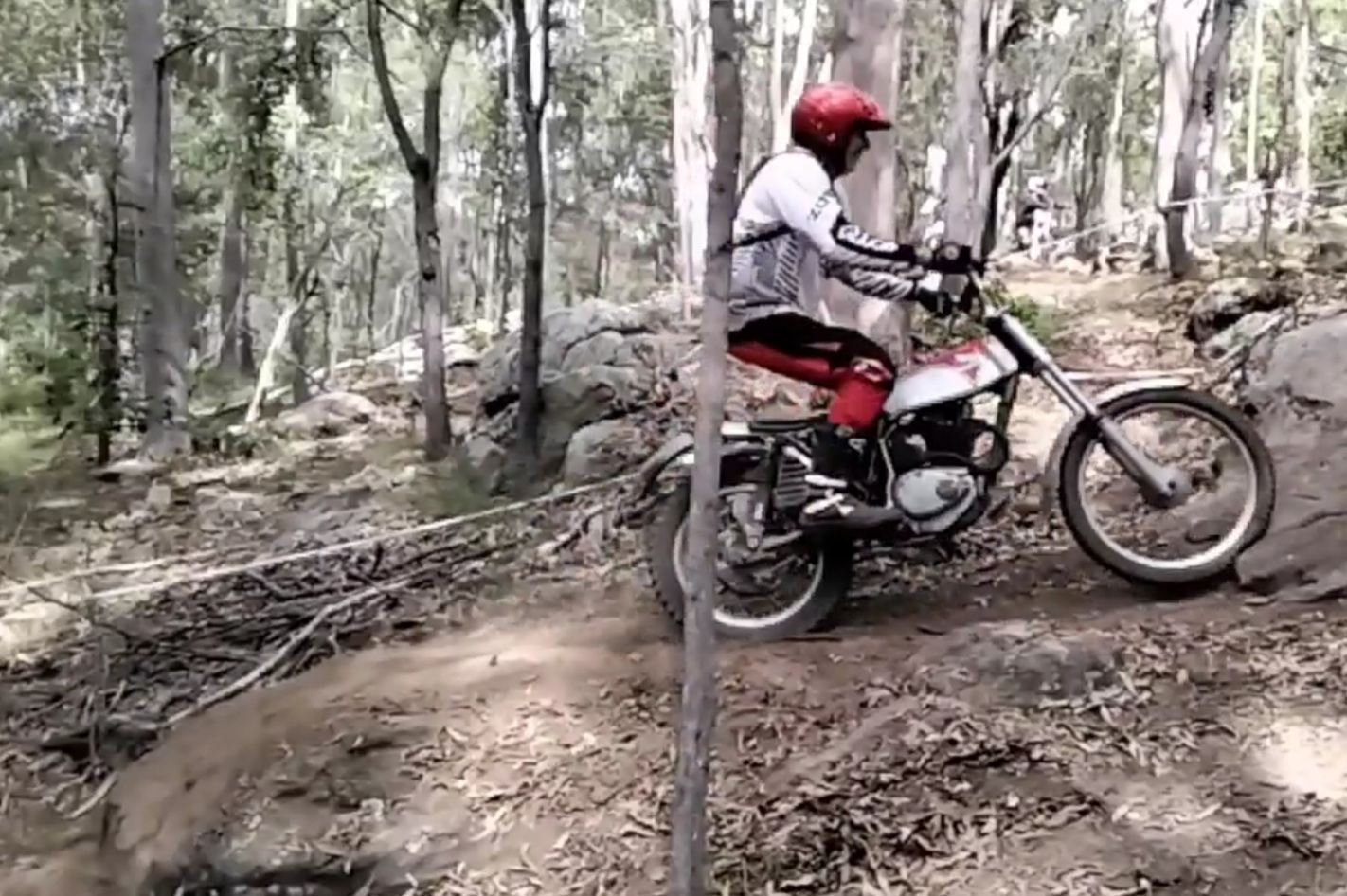

Here are some action shots:
:honda: :honda: :honda: :honda: :honda: :honda: :honda:
It's very nice to see what things you have done to make that :honda: easier to ride in sections. I love seeing what setup and tuning changes people make to their twinshocks.
Have you found that this bike is easier to ride in some situations than your other twinshocks in those situations?

David Lahey wrote:Have you found that this bike is easier to ride in some situations than your other 1970s twinshocks in those situations?
Then it is considerably easier.
The :honda: TL 250 has power to burn up hills and it bites in and tracks up hill rather nicely! :D

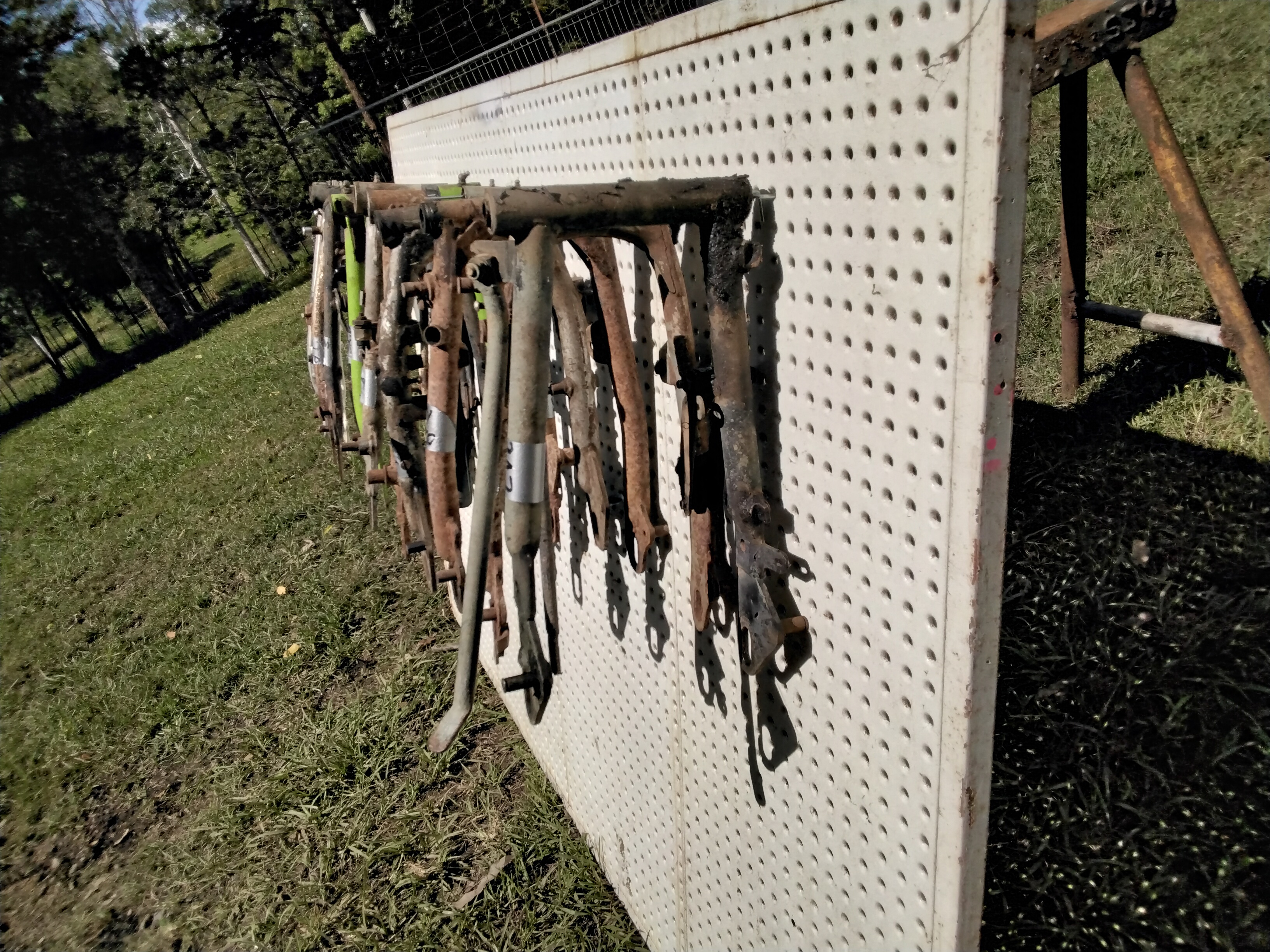

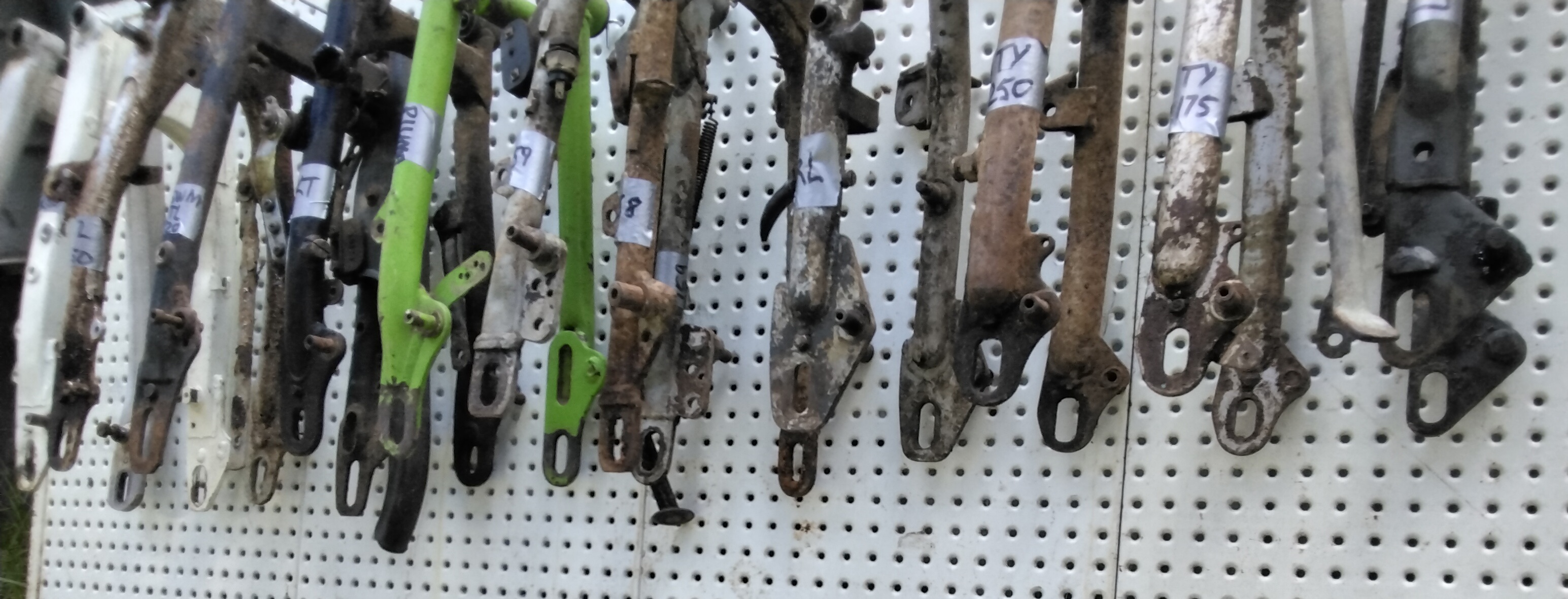

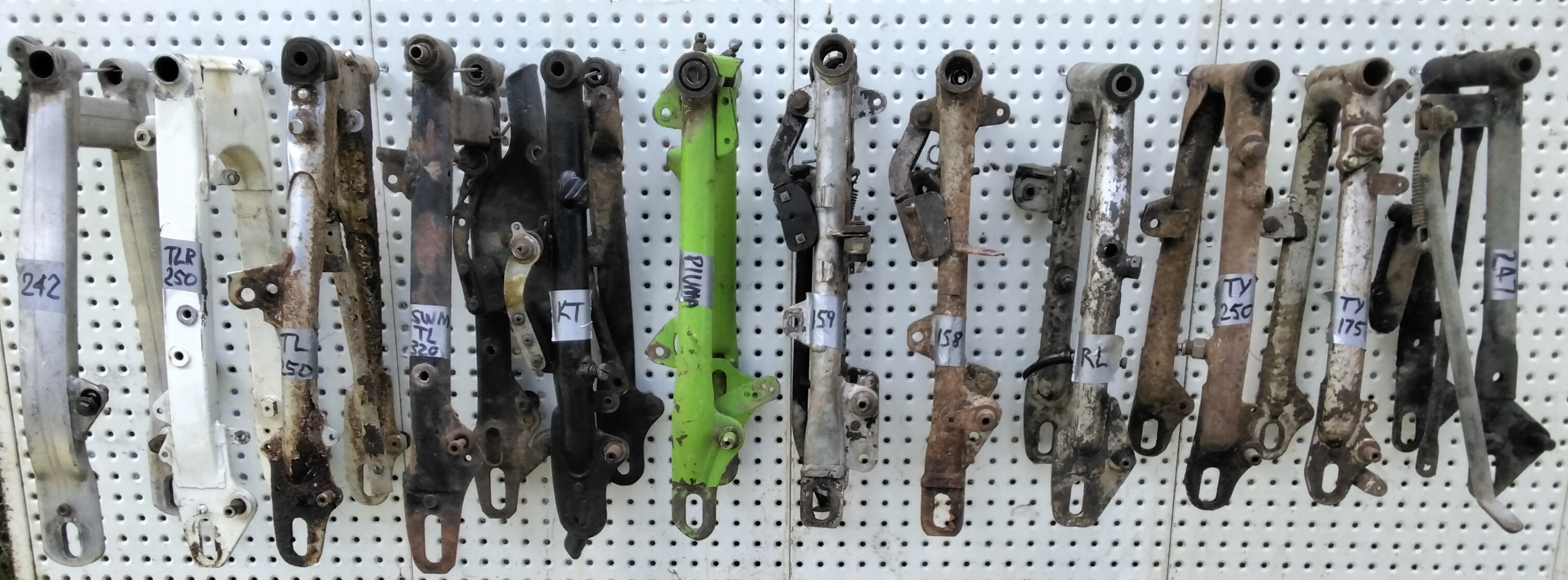

Wondering about this made me curious enough to do a swingarm comparison on a pegboard that coincidentally is like 25 mm grid paper:
There are 12 swingarms in total, a Dirty Dozen if you like:
Right to Left is shortest to longest:
Perhaps this photo depicts the lengths a little better:
Interesting how :montesa cover both of the extremities! :lol:
What does all this mean you ask?
Well you have probably worked out that :honda: were on to a long swingarm before all of the others! 8)
In fact TL 250 is the same length as TLR 200 and TLR 250.
Now back to your question as you asked it. Firstly a little on my :honda: TL 250, it came to me about 15 to 18 years ago with those Marzzochi shocks and I can remember playing with the preload and rebound a long time ago. They are maybe 20 mm longer than standard and work quite well.
Now I am thinking that the combination of long swingarm and long travel on the back along with a torquey motor is a good set up! The :honda: TL 250 of mine has an uncanny ability to recover from a bump and track straight up a hill and do it with ease even on a bump like this:

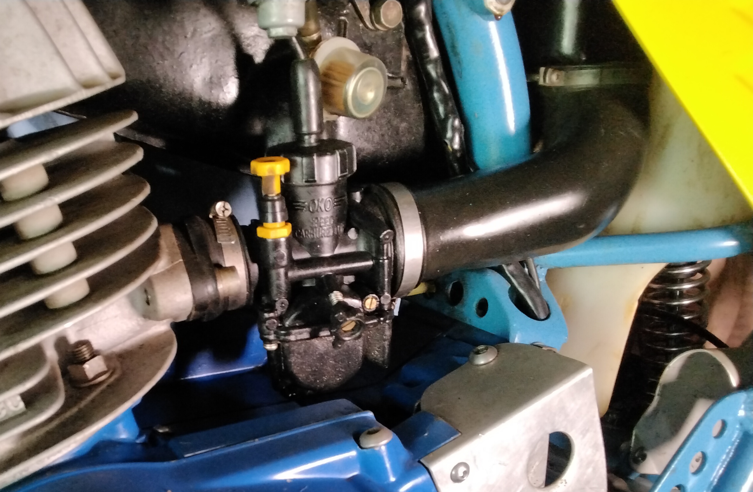

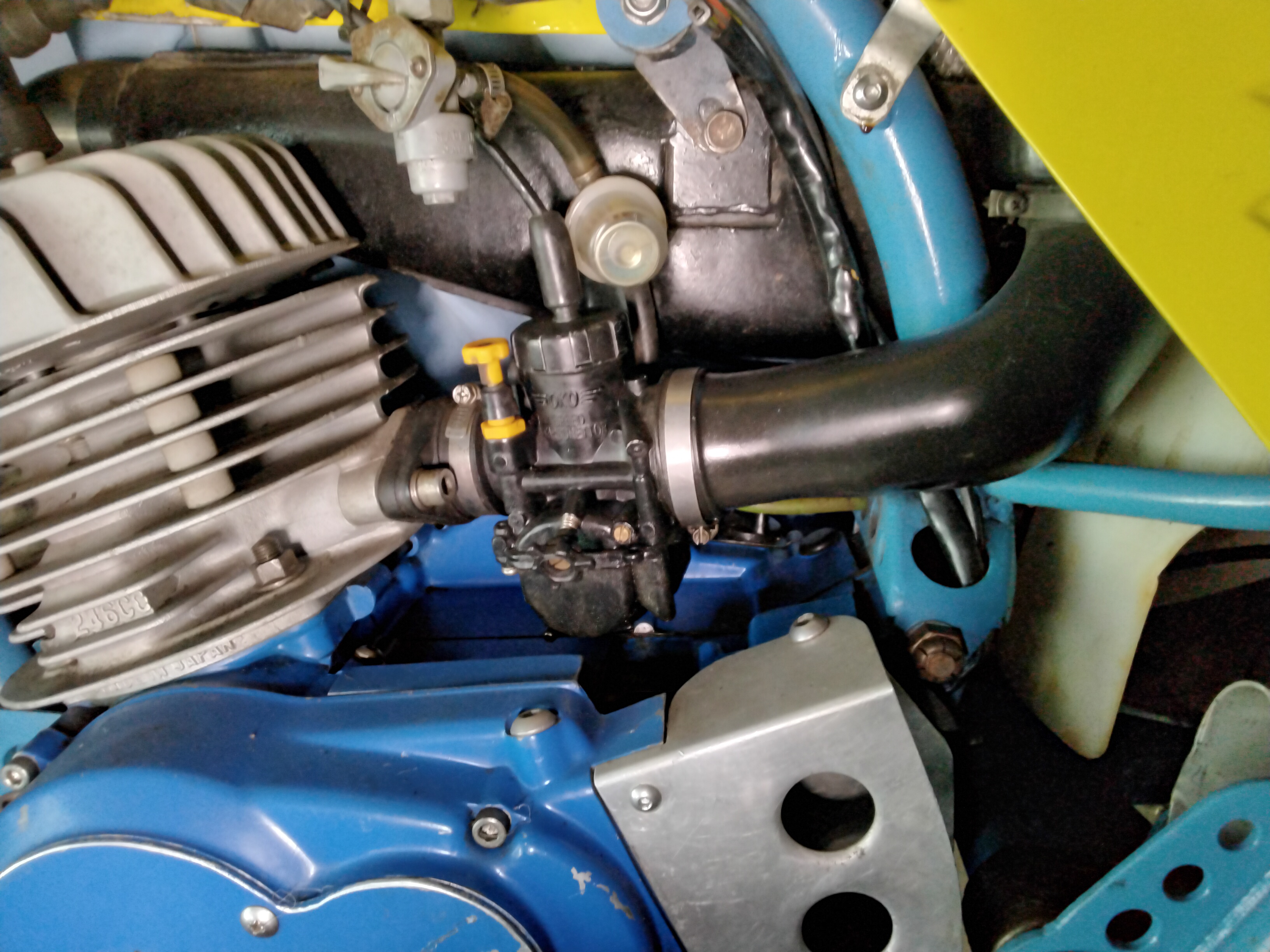

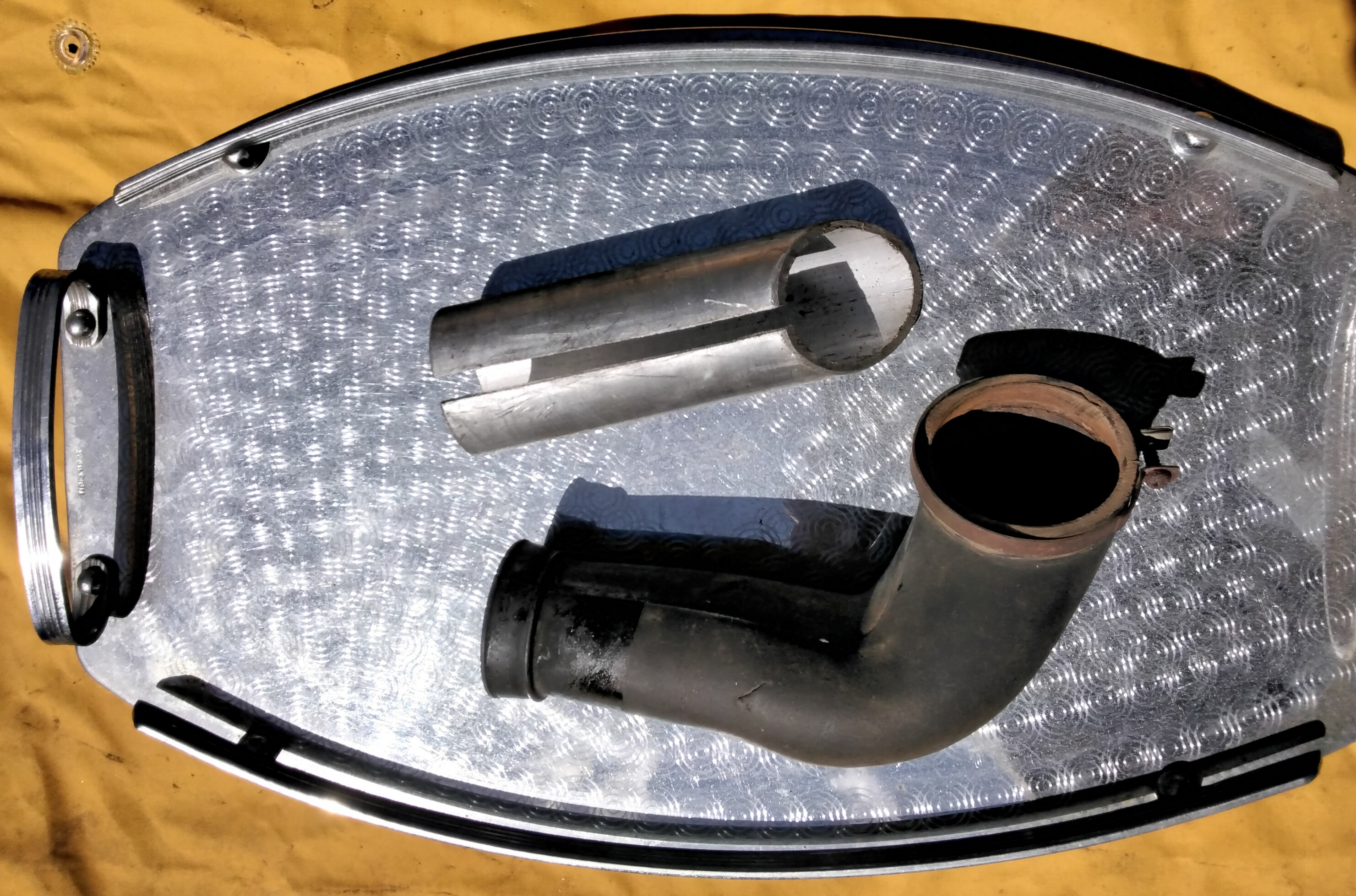

Excellent to hear Brent, you have me curious about what carby you are running? The standard 28 mm is a little big in my opinion so I fitted a 26 mm round slide OKO and it runs a lot better right off the bottom and is better right through the rev range.
The mounting (insulation) block is a Mikuni part straight out of their catalogue and bolts up. The main problem was getting the original air cleaner boot on to the carby. That was a little like Blacksmithing, heat beat repeat. To start with I soaked it in boiling water to heat uniformly and soften and then forced it on to a warm aloooominium tube. Then I split a bigger aloooominium tube, inserted and used tyre levers to stretch the boot. This needs to be gradual to avoid splitting and I was using a heat gun as it was more convenient than hot water. The aloooominium helps prevent overheating the boot so heat a little, stretch a little, rotate a little, heat stretch repeat.......
Knowing you are a fitter machinist so I will use Engineering terms: You need to stretch the Firetruck out of it!

My carb is a flatslide OKO from Mid Atlantic trials that was supplied as pre jetted kit. It included a manifold similar to yours and a rubber adaptor to join the std air intake hose. Due to the different position of the motor I had to shorten the intake hose and glue the adaptor in place.
I'm having a problem where, once it is hot and it stalls or I turn it off it will start after 15-20 kicks and it runs like it's loaded up. Hold the throttle full open and it just blubbers until it clears and revs. Once it cools it starts on two kicks as it normally does. I've swapped CDI units, replaced the plug cap with a new Suzuki one (5k resistance) replaced the coil with a new Suzuki one, several new plugs and swapped out the stator for a TS250A unit. None of these things made any difference. Yesterday I pulled the plug as soon as it stopped, and the plug looked oily so i put in a new plug and it started straight away. I've drained the tank and will refill it next weekend. The bike was jetted in June-July at around 20C and 20% humidity. Currently it's 35C and 90+ humidity. I also run an oil feed to the LHS main bearing so I'm inclined to think it's loading up on oil. I was running about 30:1 fuel mix. I think the oil pump may supply enough to lube thee motor but I'll run maybe 60:1 just to be safe.

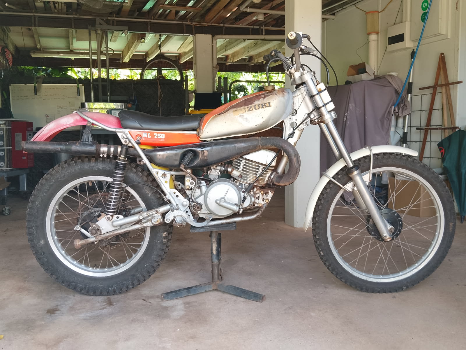

RL250 “Squimsish”
Measurements taken with the bike on a stand with wheels just touching the ground with suspension on full extension.
Wheelbase 1360 (1335-1370)
Rear axle to footpeg 405
Ground clearance 365
Swingarm pivot to ground 475
Footpeg to ground 410
Swingarm length 430
Front axle to triple clamp 805
Fork angle 28
Frame rake 26
Front weight 44kg
Rear weight 54kg
Full fuel tank on bathroom scales
photo to come

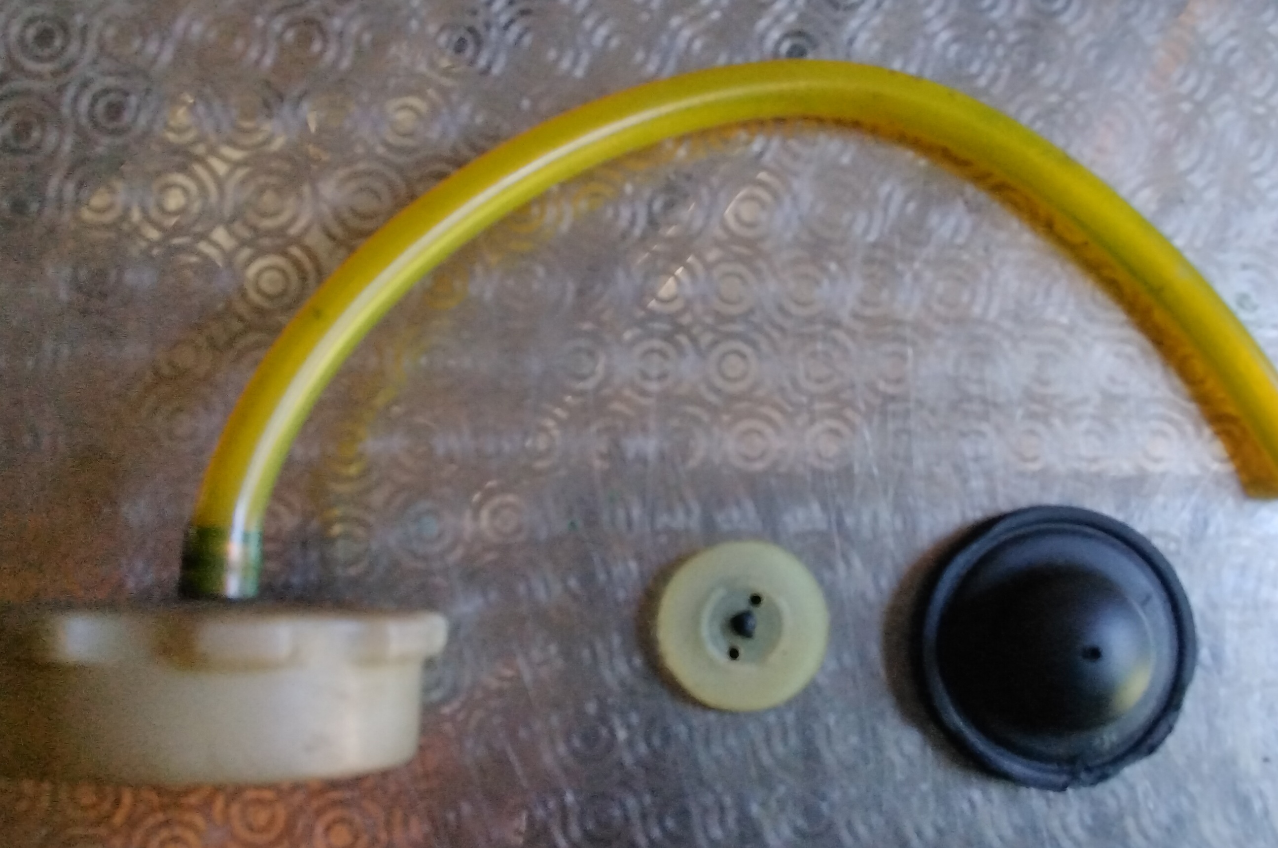

30:1 sounds a bit much to me when you consider that you are injecting oil as well, 50:1 on my old 2 strokes.

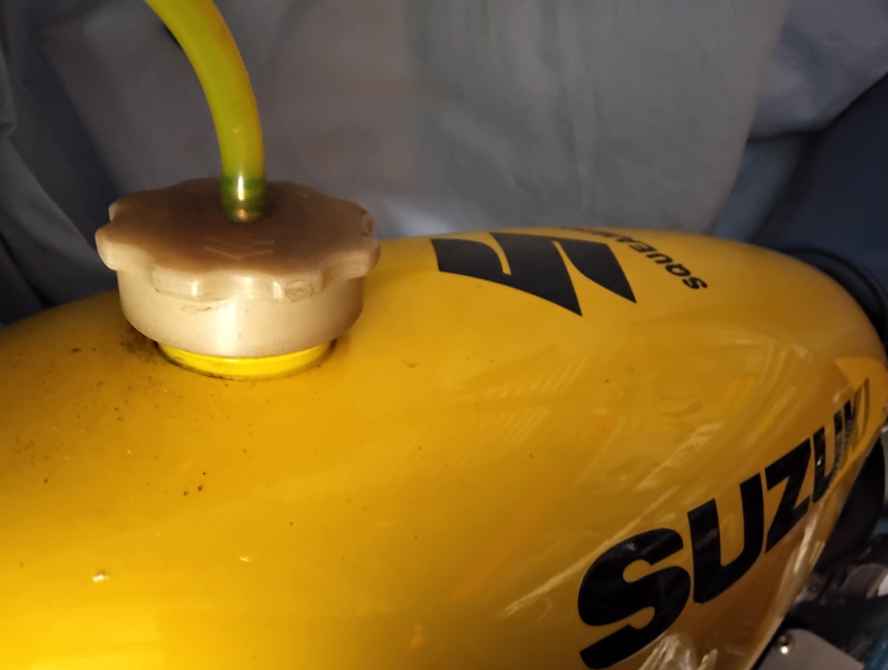

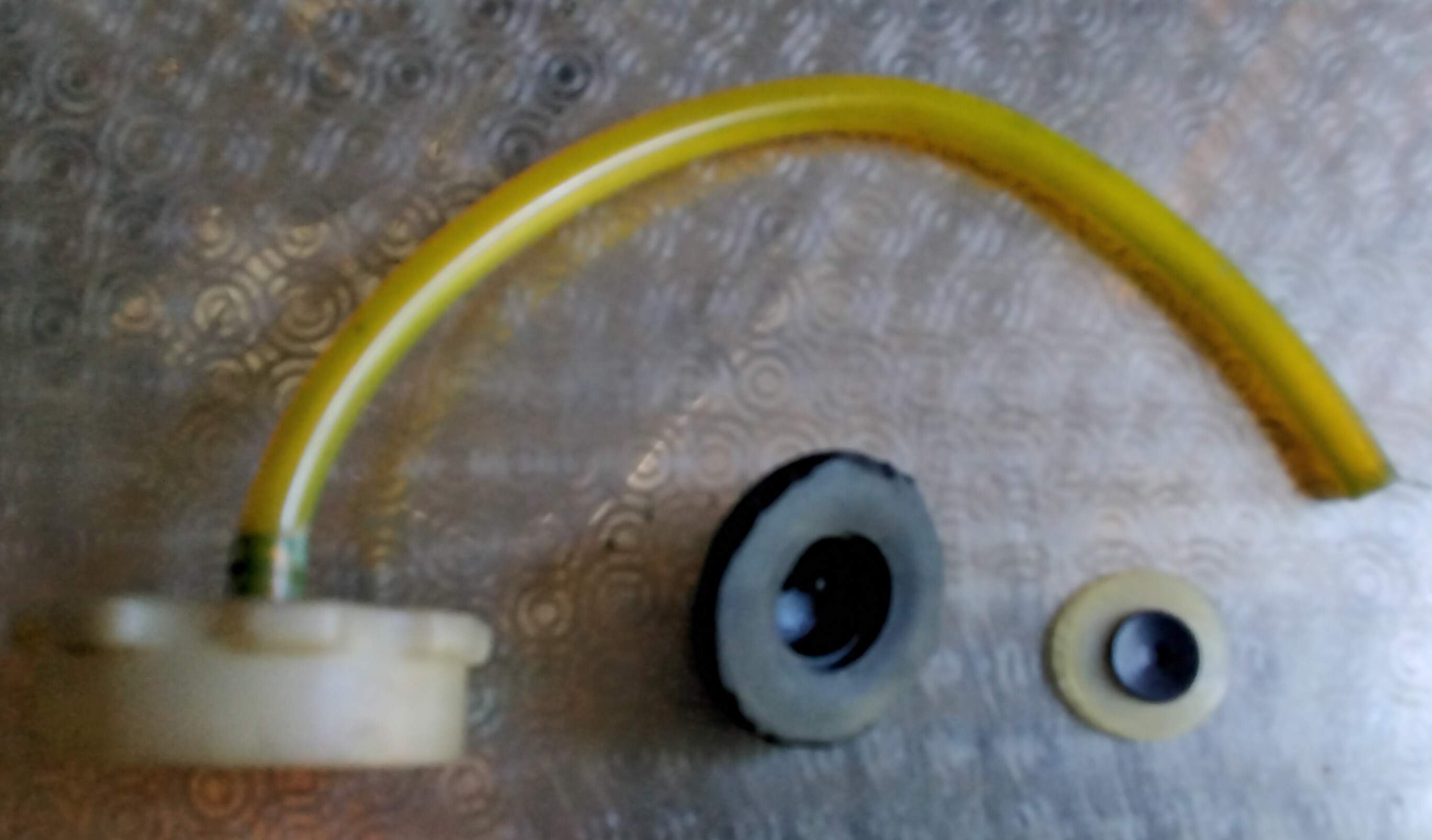

The SQUEAMISH was suffering similar symptoms and I chose the other rabbit hole that smelt like fuel. Mainly because I was able to replicate the problem at will, it happened more often with a full tank and even more often descending down steep hills. My thoughts are the one way valve in the fuel cap was sealing too well while manhandling the bike over obstacles and the pressure had to go somewhere with the next weakest point being the needle and seat.
The valve can go in 2 ways and I think it is meant to let air in as fuel level goes down? The parts book is no help:
The workshop manual has me thinking there is a conspiracy:
To be fair, I think :suzuki were not considering what can happen in Trials riding and the workshop manual reads very similar in other examples for different models. What do you think?

Here are the "specs".
RL250 “Squimsish”
Swingarm length 430
Fork angle 28
Frame rake 26
Front weight 44kg
Rear weight 54kg
Weight measured with a full fuel tank on bathroom scales

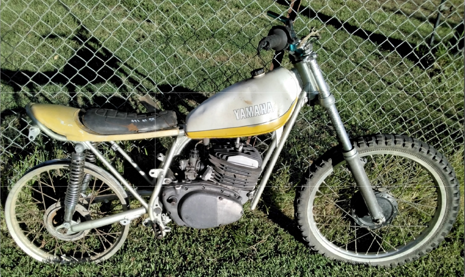

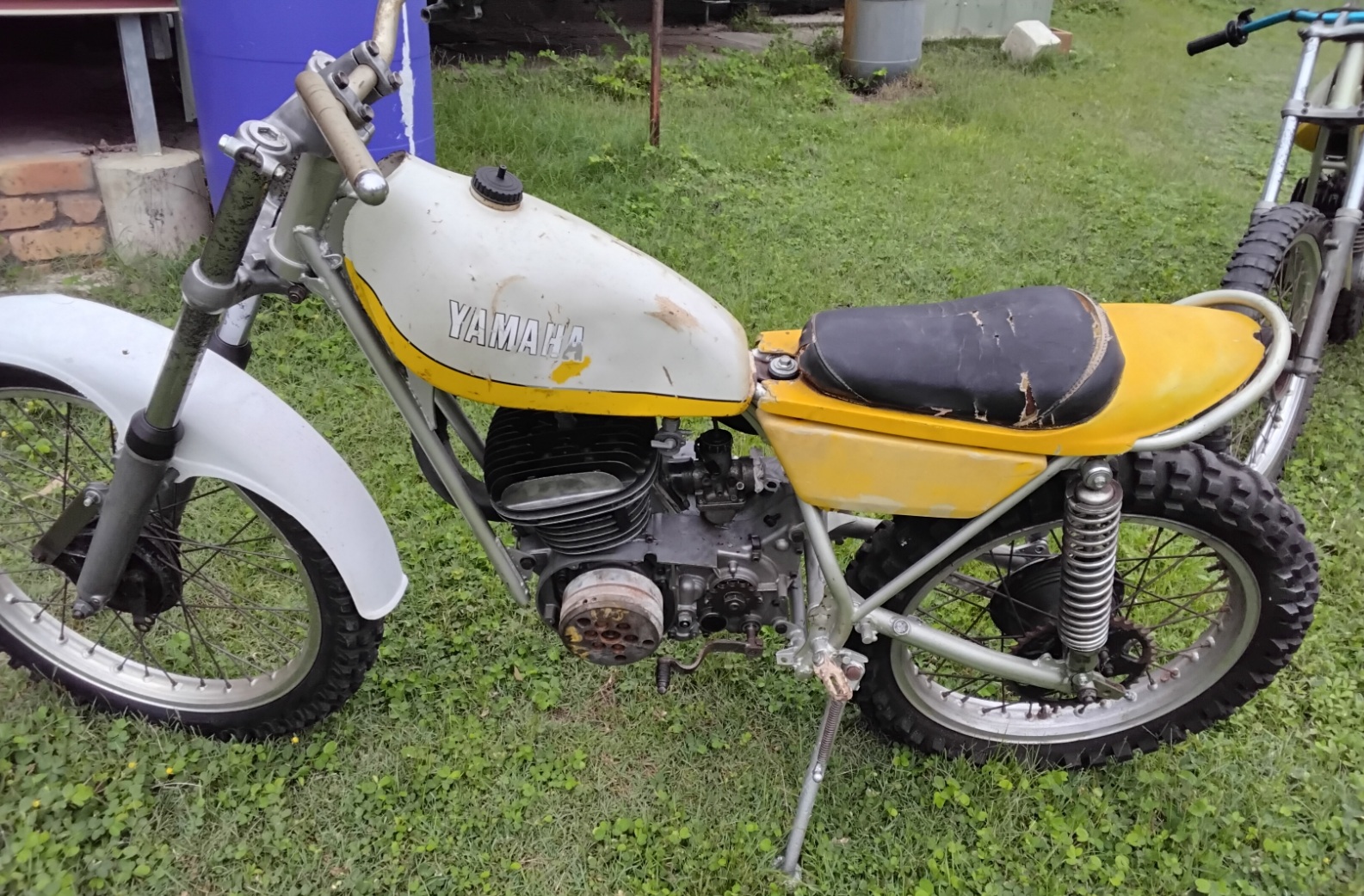

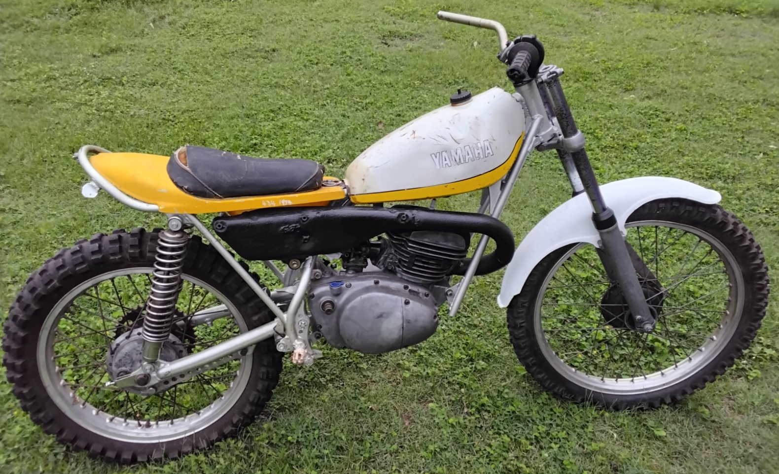

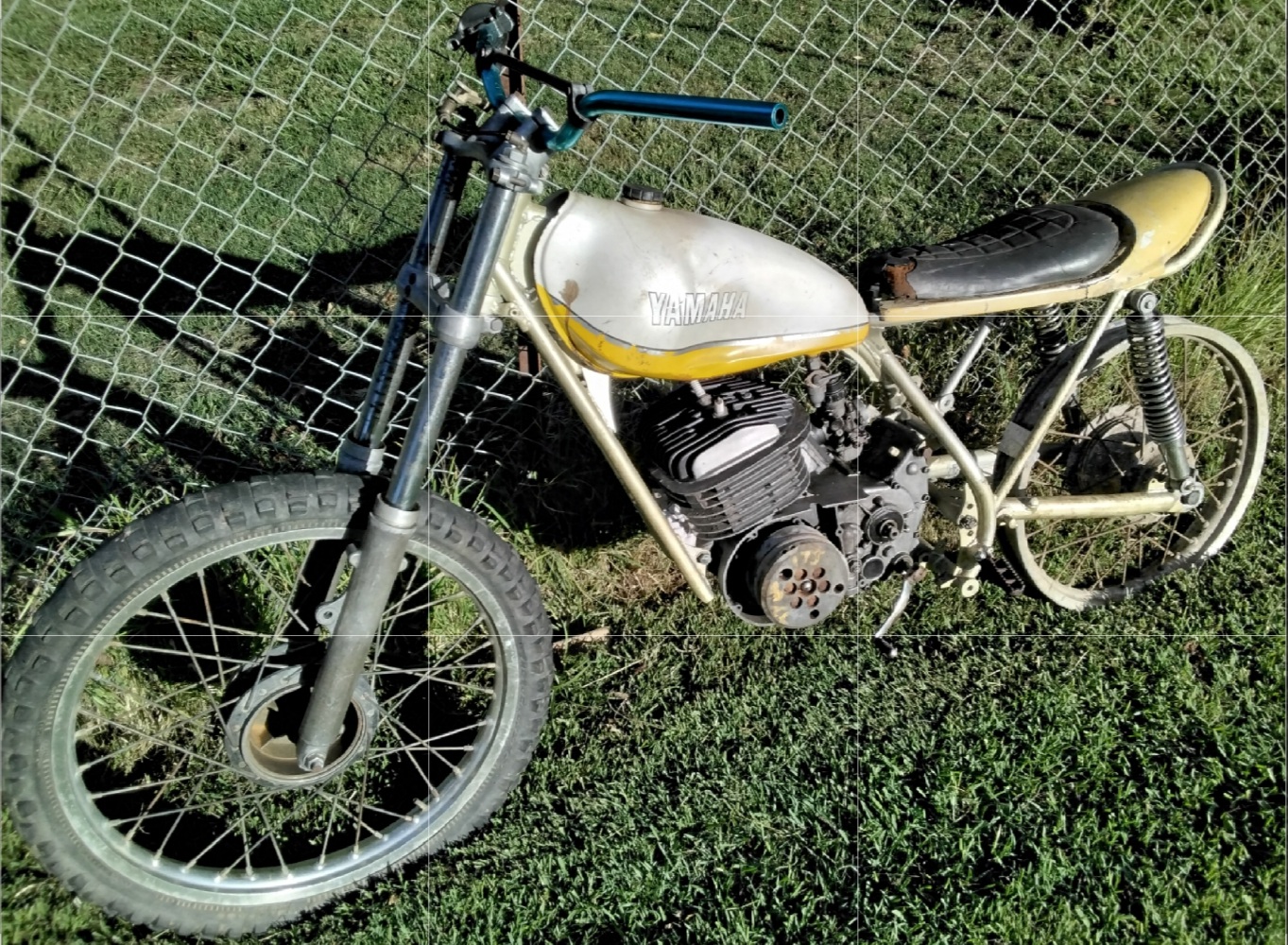

In other news a Mate of mine ended up with these 2 :yamaha TY 250s:
He wanted to keep the matching numbers "A" model and make it more complete. So I supplied him with most of the missing parts and in exchange I ended up with the "B" model:
Screenshot_20250316-203955_Photo Editor.jpg (731.96 KiB) Viewed 3963 times
Screenshot_20250316-203909_Photo Editor.jpg (677.08 KiB) Viewed 3963 times
It is not matching numbers and quite a few parts are wrong, can anyone identify the non genuine :yamaha TY 250 B model parts?
