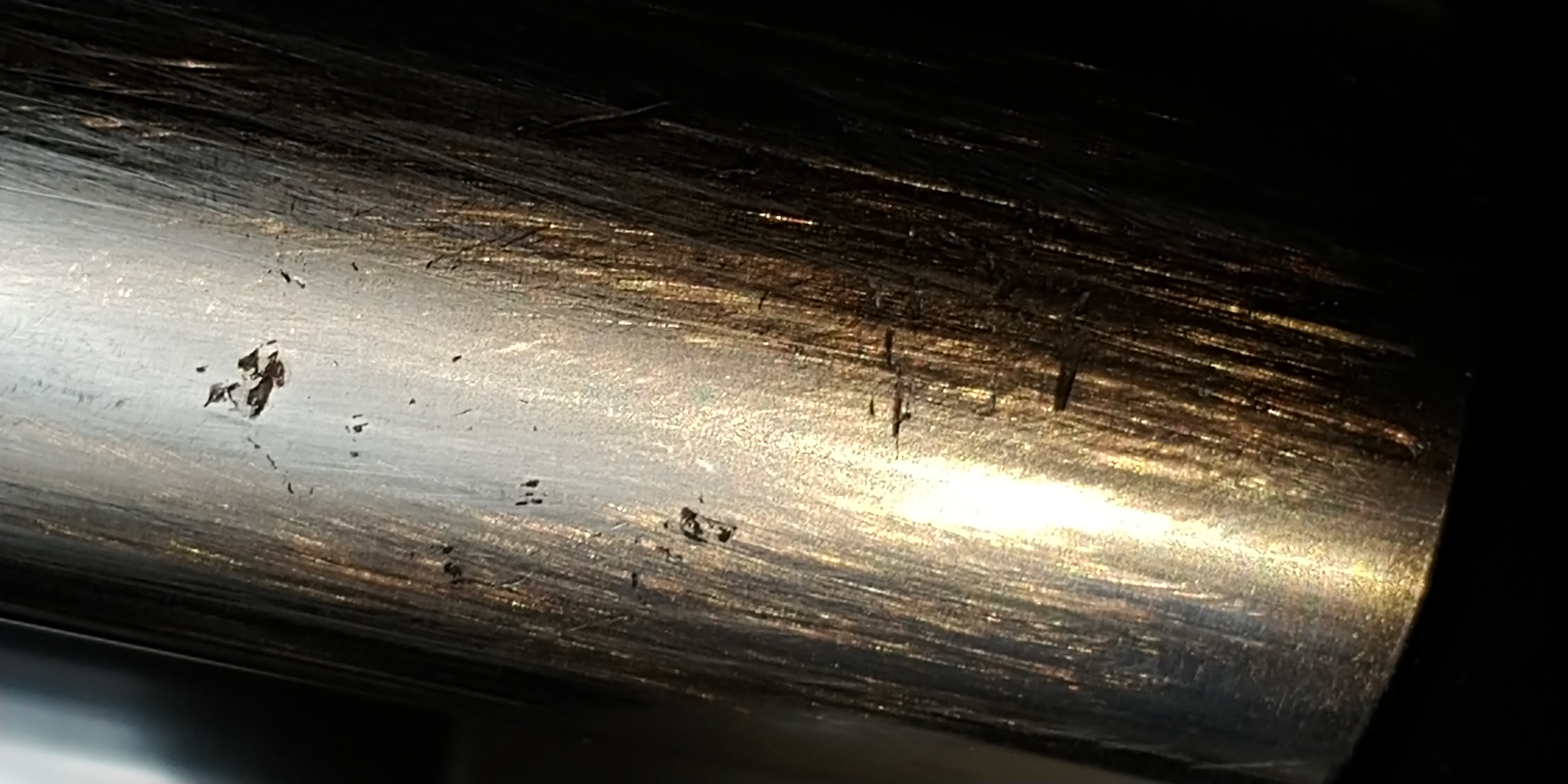

Last weekend I took a tumble amongst some very scratchy granite rocks and one fork tube got some gouges. A few of them were deep enough to expose the steel under the chrome. I rode the bike back to camp so that fork seal is toast.
Today I decided to try a home remedy for the gouges that I had heard but not tried for myself.
First I removed the high bits along the edges of the gouges using a hand oil-stone.
Then I degreased the damaged area and filled the gouges with Araldite.
Then I removed the excess Araldite with a well-worn file.
I could feel that a couple of the gouges still had an edge. I was going to put some more Araldite on but decided to try superglue instead. So I degreased the area again and put on some super glue. When that set I used the worn file again to remove the excess.
I then smoothed the area with some 5000 grit wet and dry paper.
In the photos it looks like the gouges and pits are still there but that's only because the Araldite and super glue are transparent. It feels fine with no detectable edges to damage the new seal I'm planning to fit.

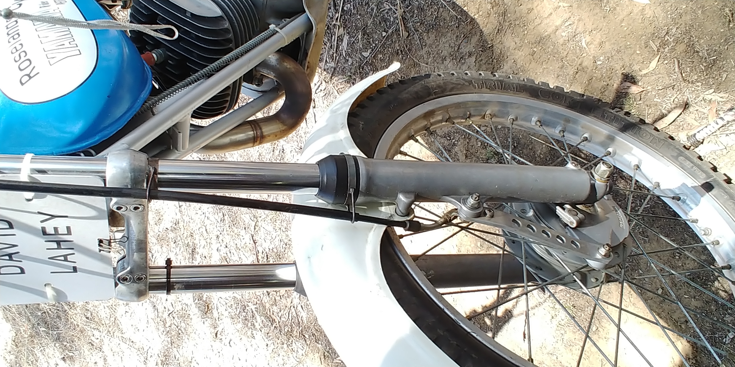

Today I replaced the wrecked fork seal then took it for a test ride. No leaks so far.
I also did a bit of suspension tuning while I was at it, reducing the fork spring preload.
