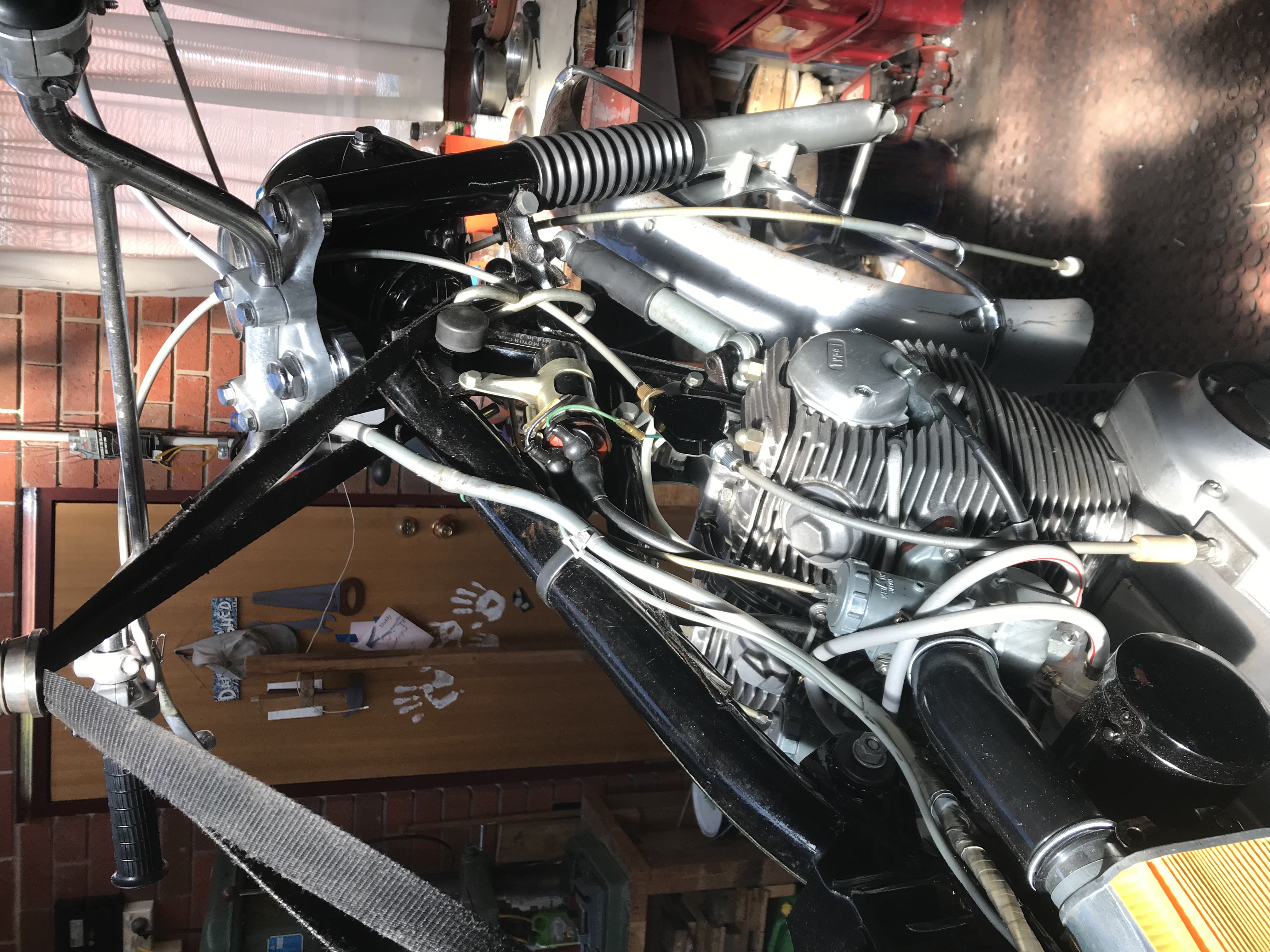

The dirt has been washed off and you can see the storage related weathering.
And after cleaning
I like it it’s a good look it’s definitely a Tioli look

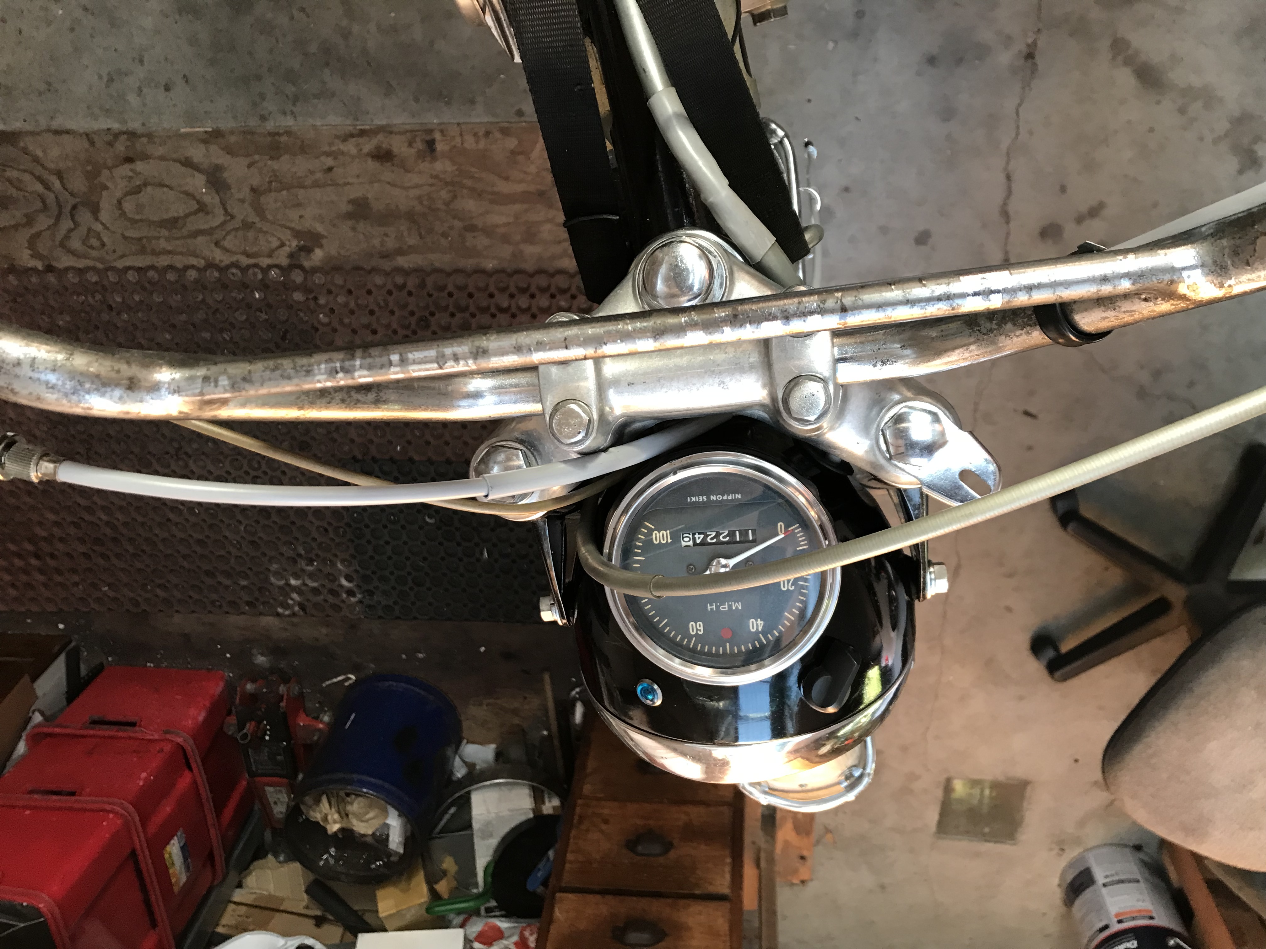

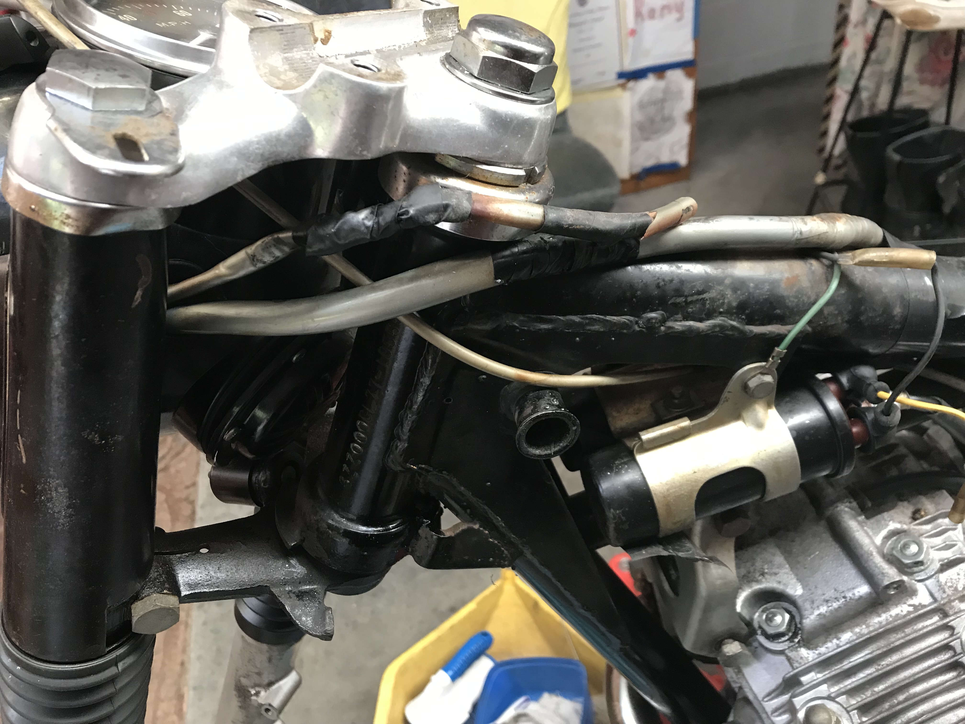

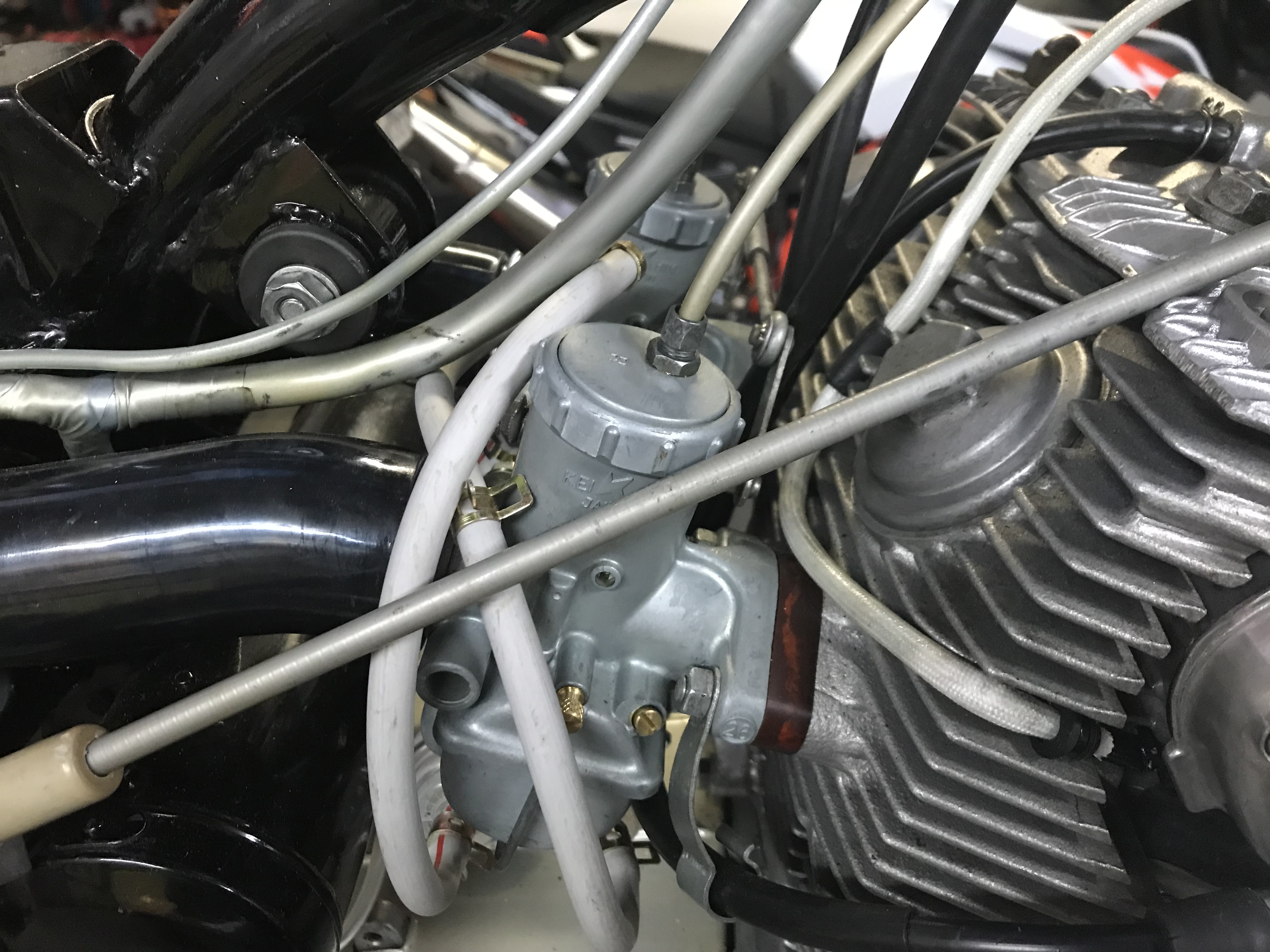

The top draped cable is to the handle bar controls. It’s been taped up in a few places the housing looks UV damaged and brittle.
The bottom main wiring looms housing is cracked round in one place caused by age stiffening yet required to bend while stearing, it’s been taped up.
Main wiring looms housings brake is supported with electrical shrink
The wires to the handle bar controls are now housed in a shrunken silicon heat shrink.

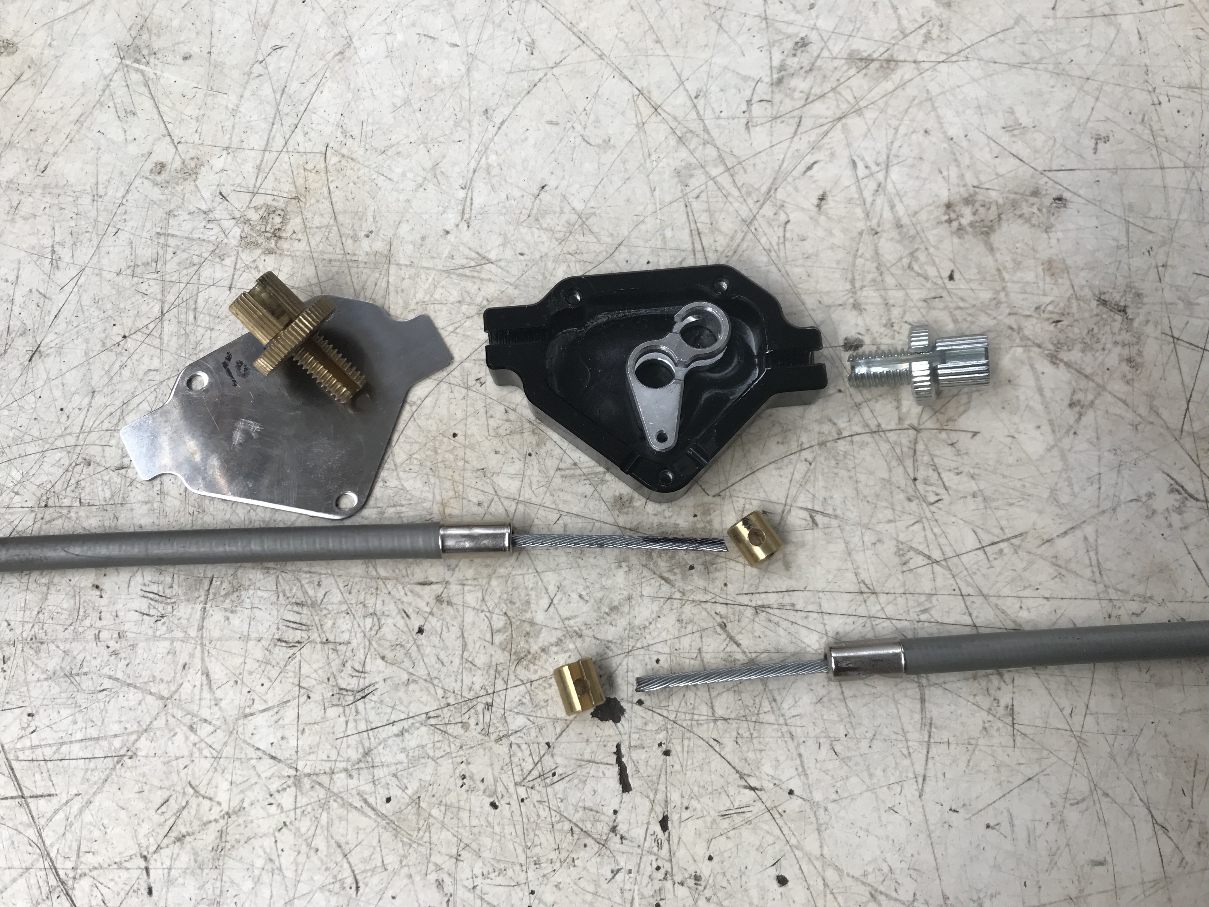

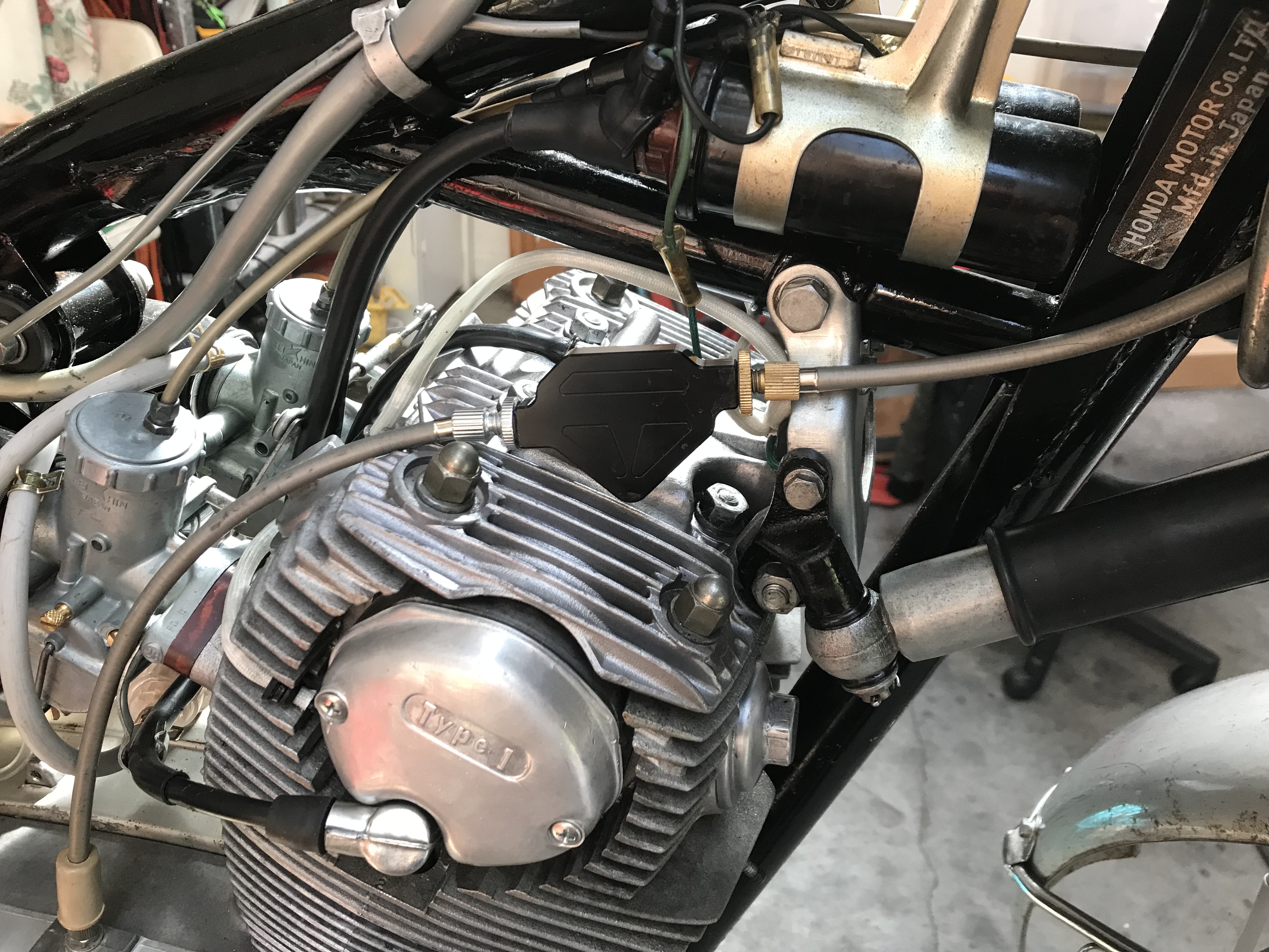

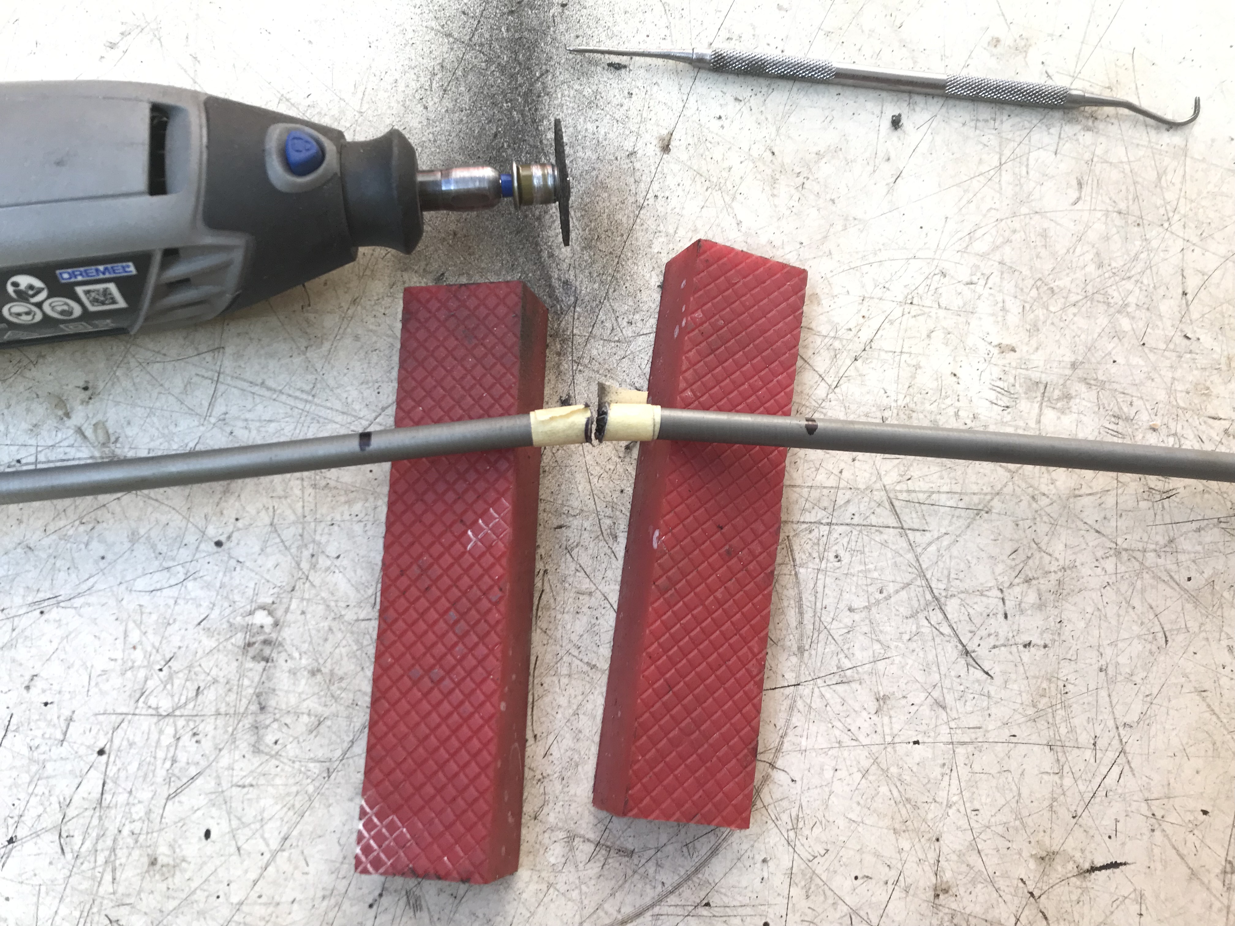

One of the problems I have to solve is clutch leaver pressure. To me this has a very heave clutch it’s running as smooth as I can make it and it’s just about unusable. I blame the inefficiencies in the way the cable transfers its energy. Not much I can do there.
So I have a plan and it’s to hide an easy pull clutch under the tank.

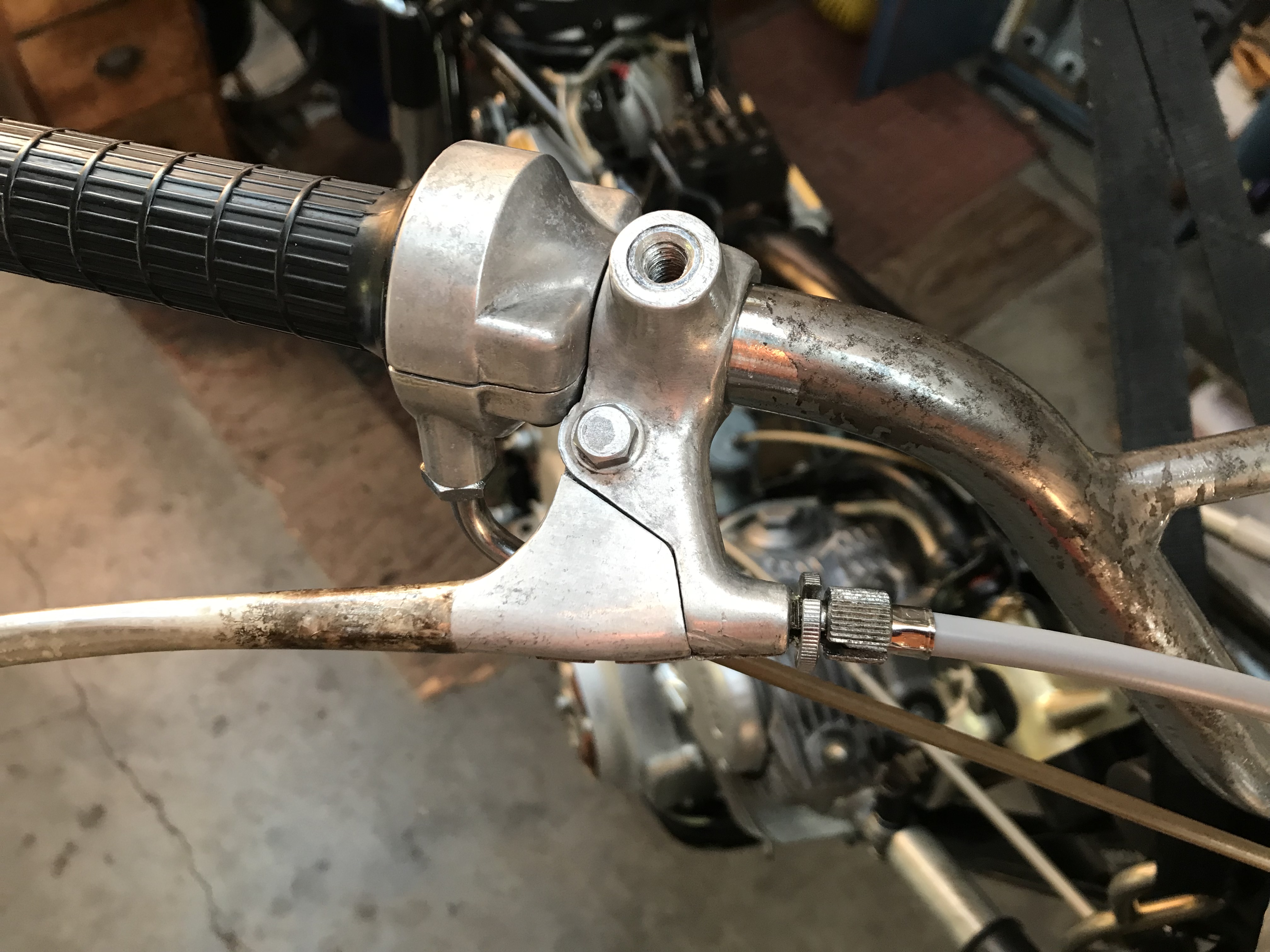

Post by Tioli »

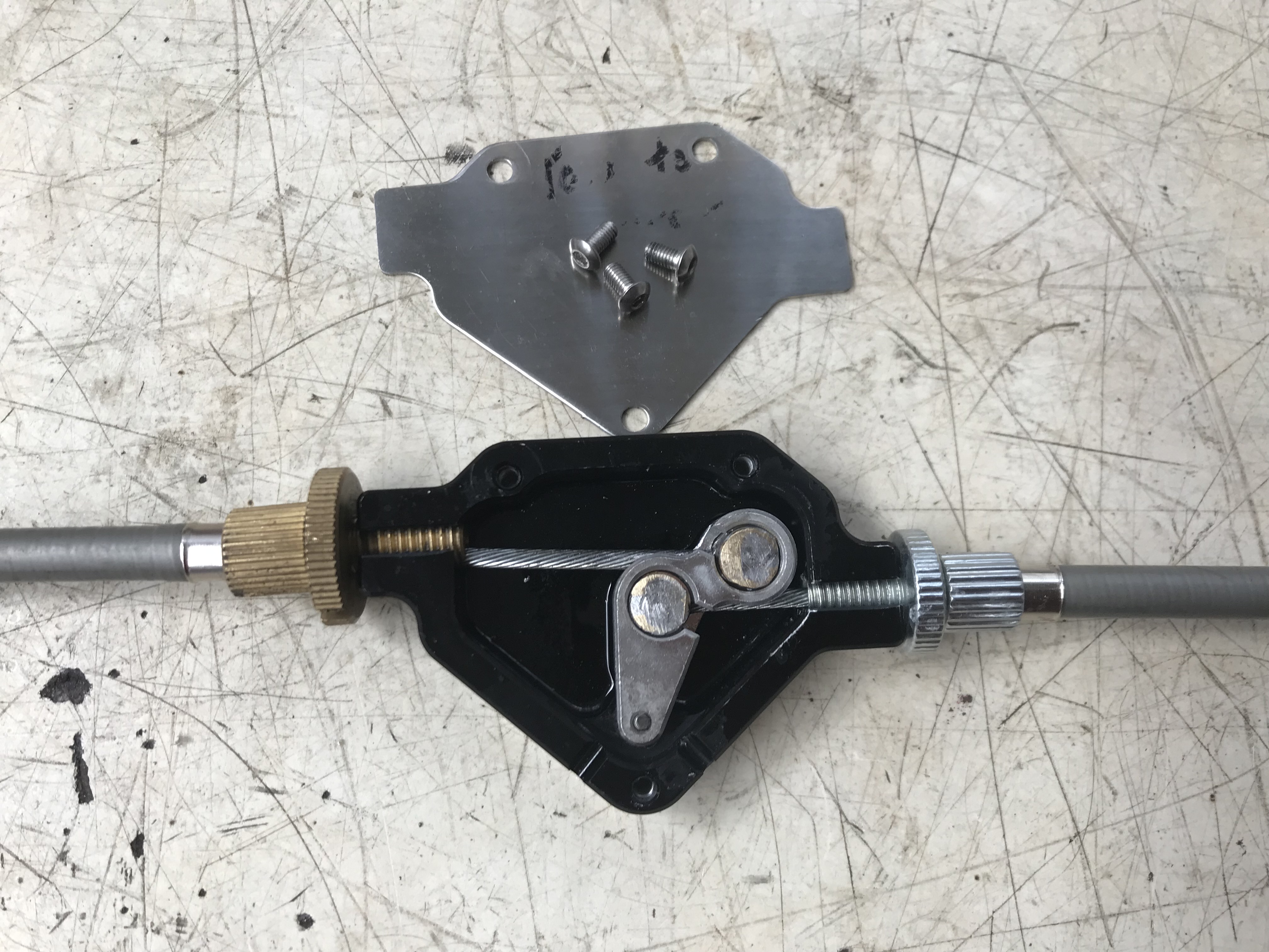

The clutch leaver adjuster is locked in place by a spring tensioned ratchet system. Works well very definite clicks

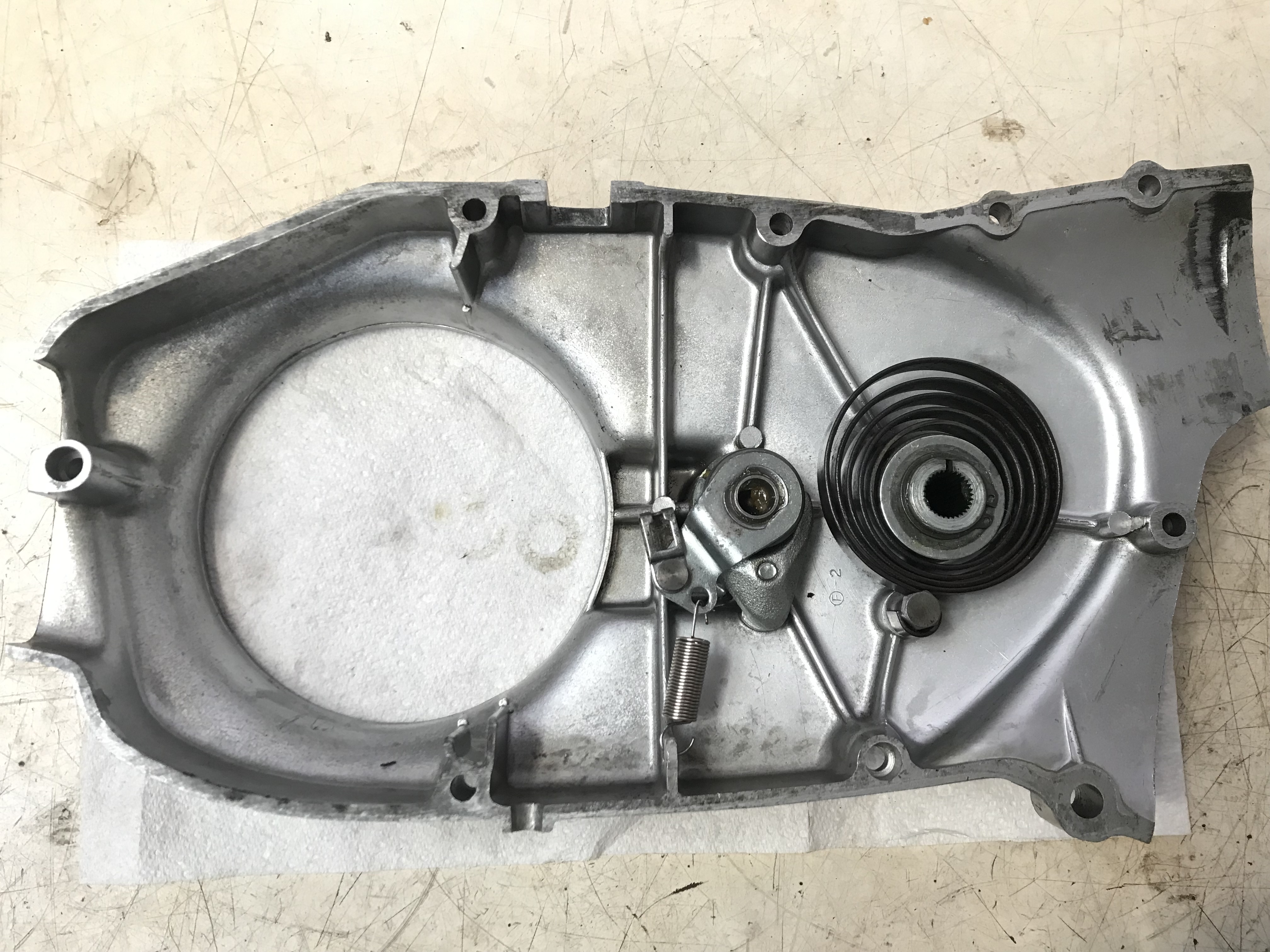

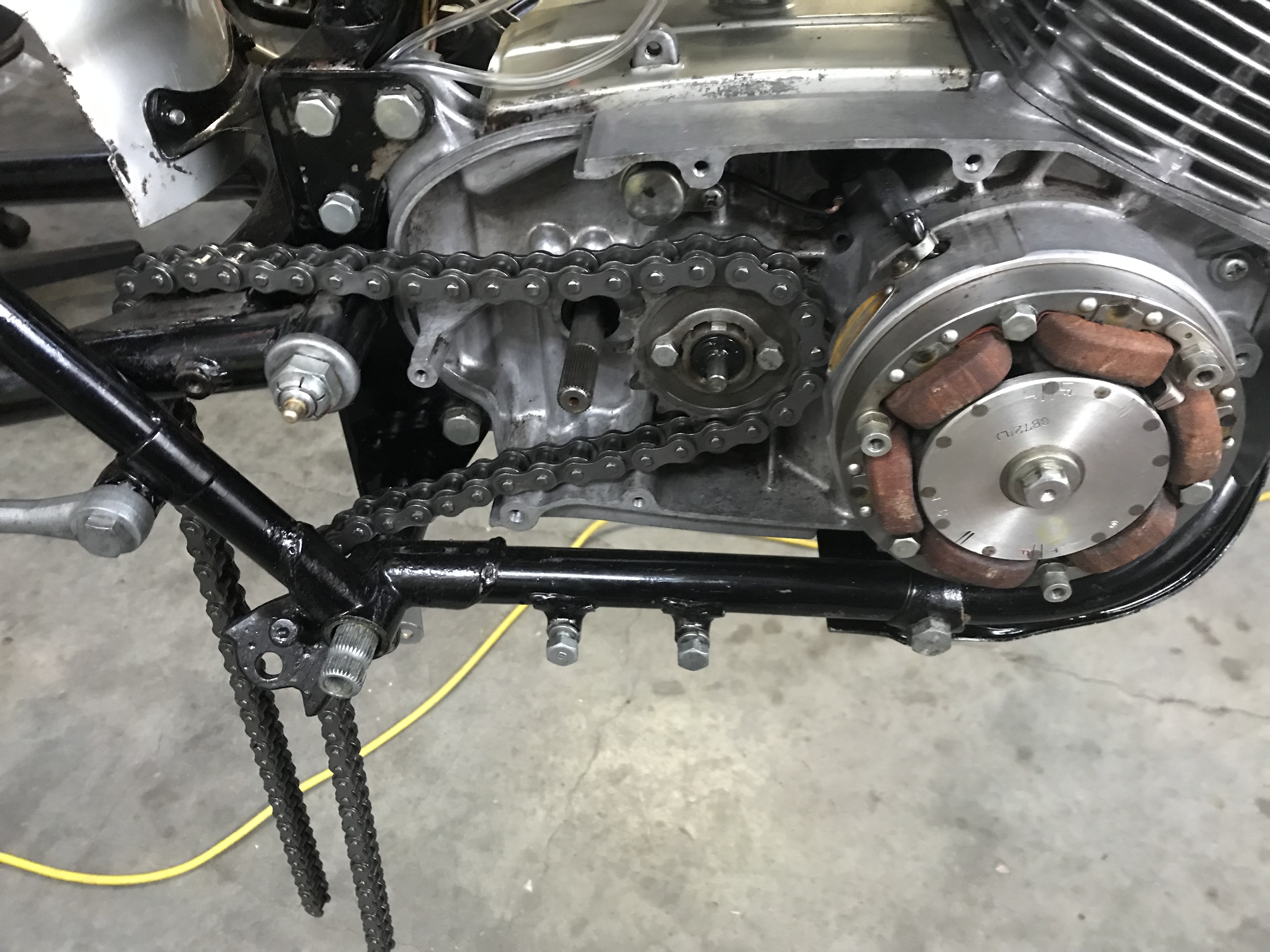

Odd that the chan is on the right side. I think that idea ended in the 60’s
Starting at the back is the kick starter shaft then clutch push rod (centre of the sprocket)
Kick starter
Before
After

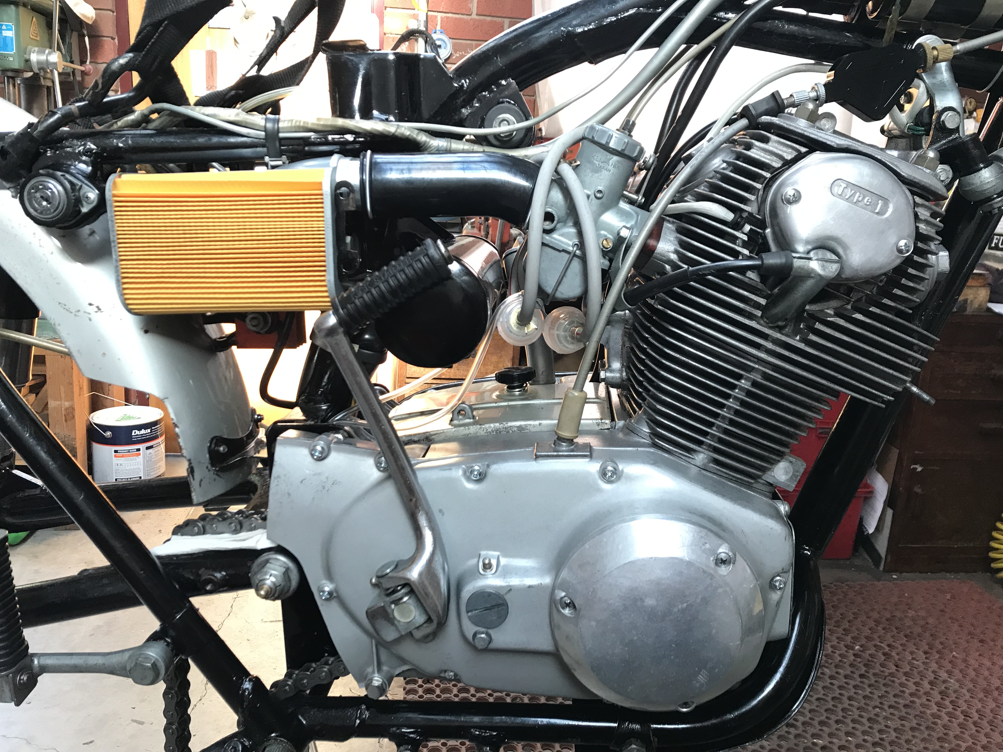

This design was around for a while

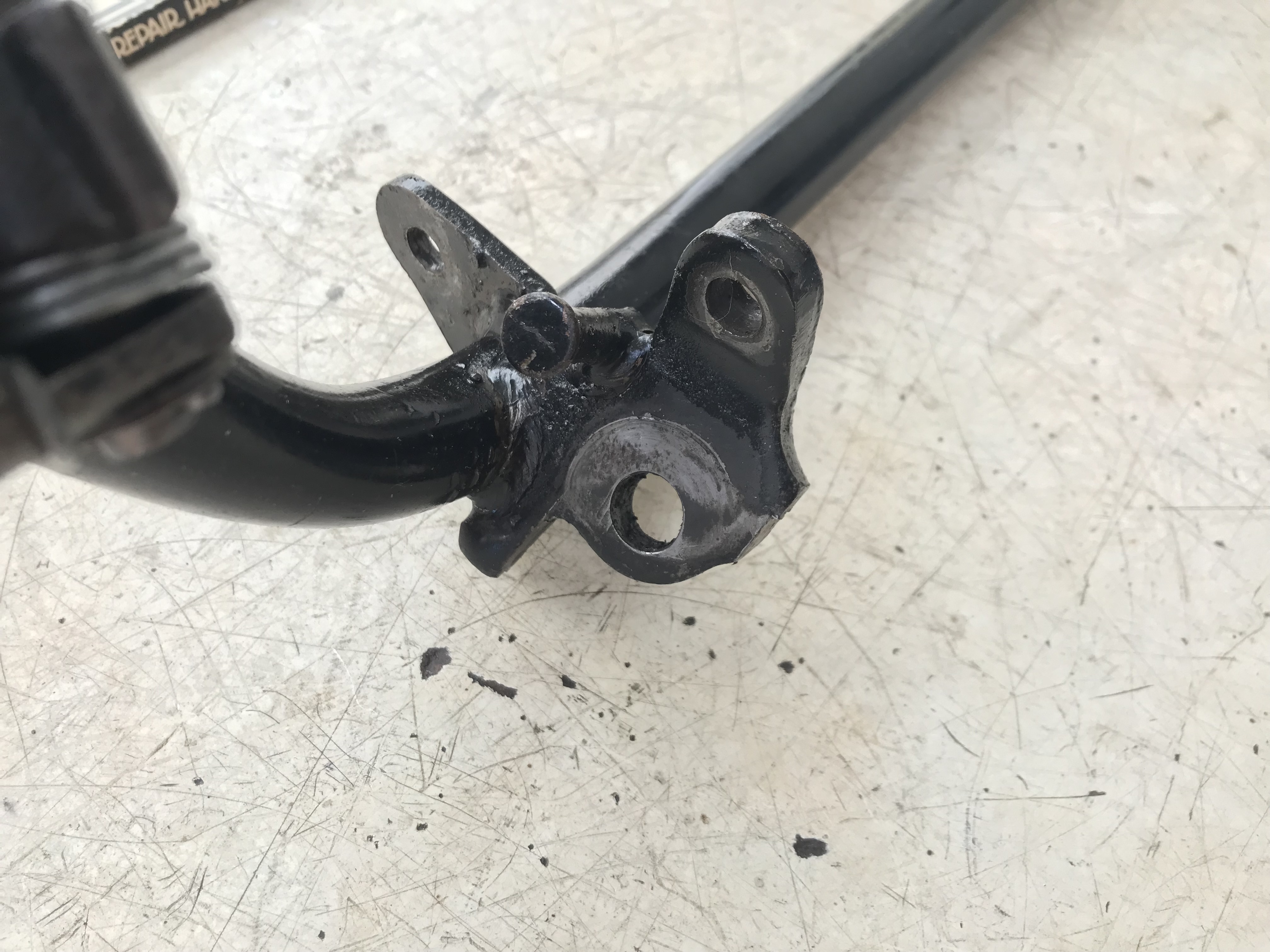

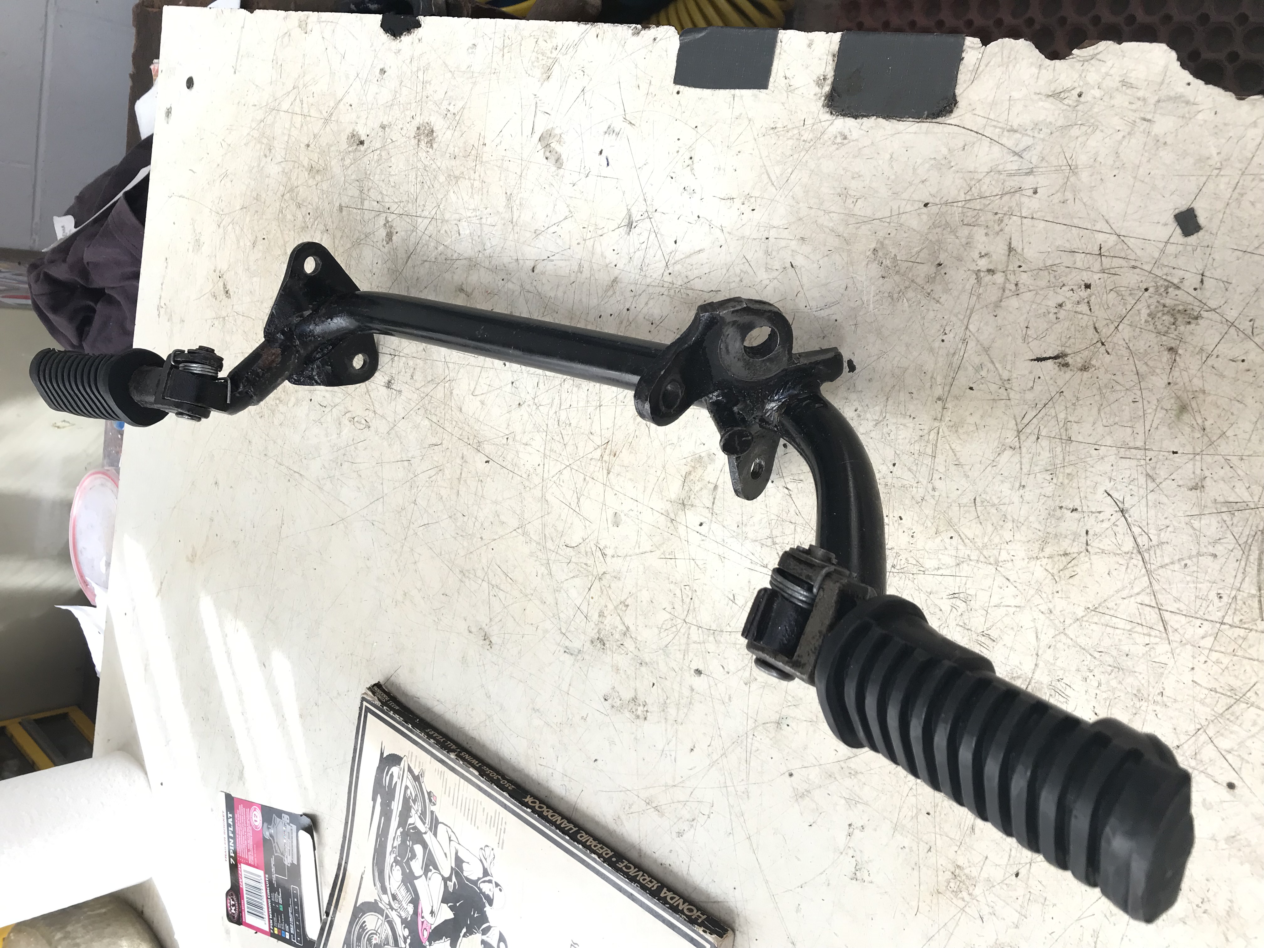

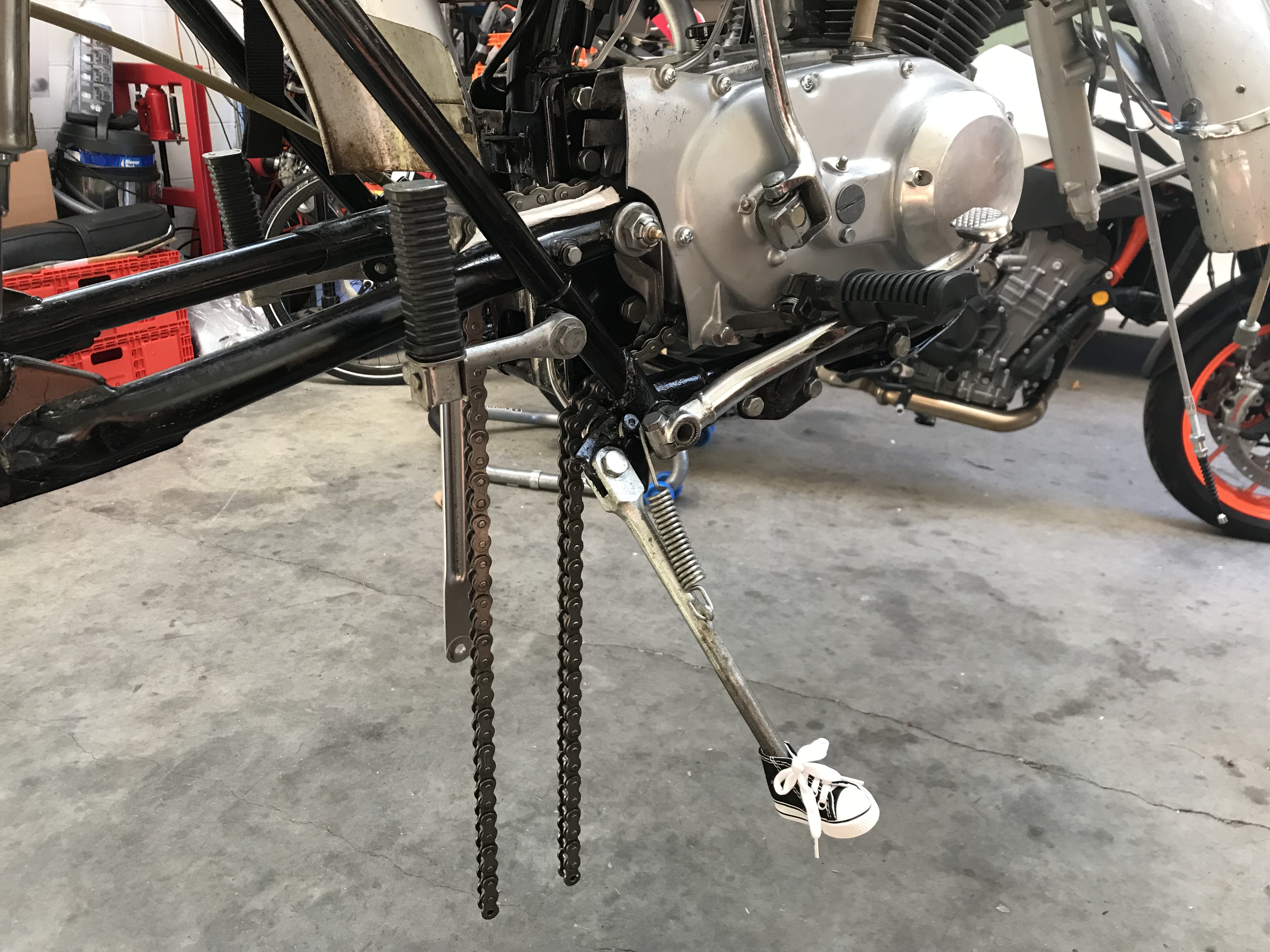

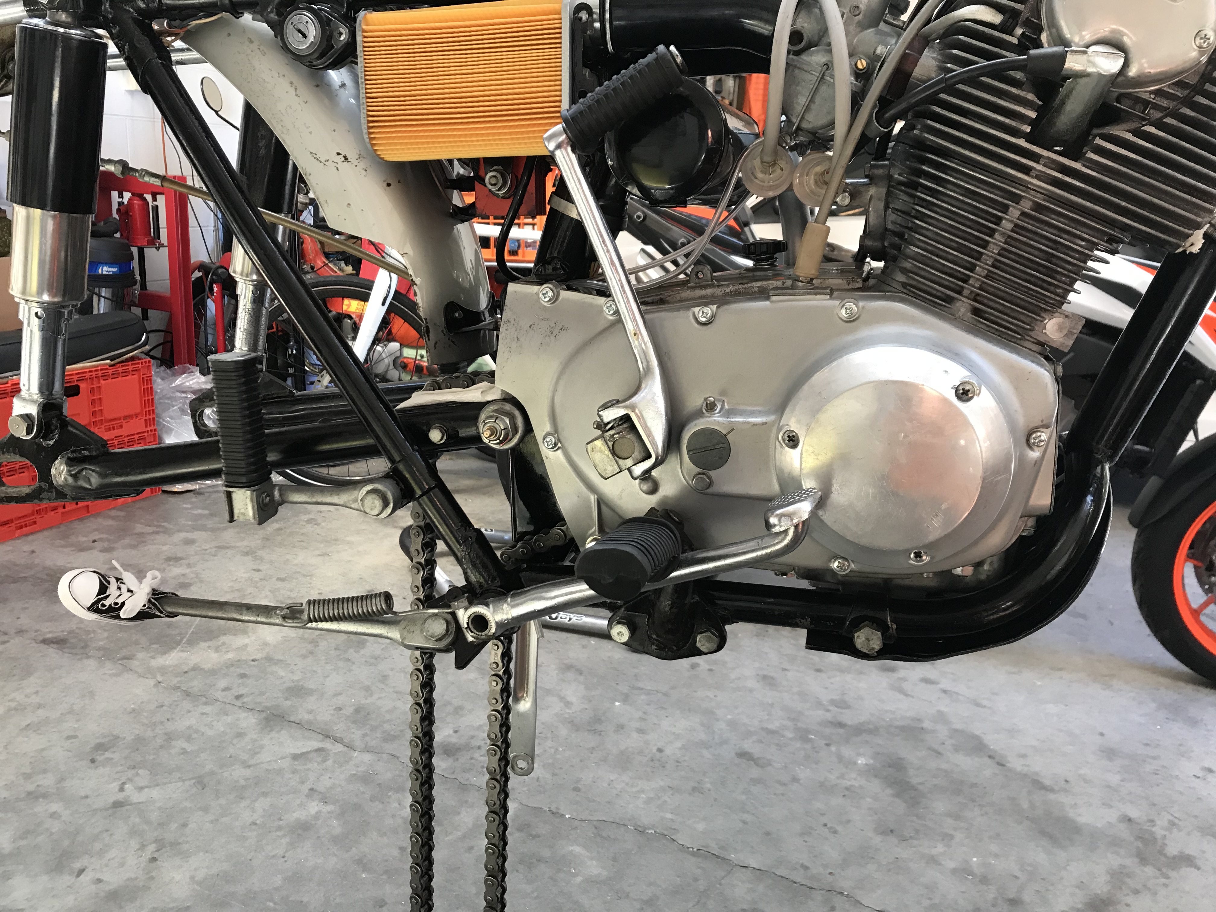

Side stand mount on the left side
Extends like this
But it doesn’t have to. Back in the day some bikes did not. It’s not ansuall to have the side stand on the same side as the chain.
Most photos of this model high light the exhaust which is on the left side. When the side stand is down it puts the exhaust on the shade side. So if I duplicate the stand mount on the right side and bolt it to a centre stand mount. It puts the exhaust in the sun and you wouldn’t know what I did.

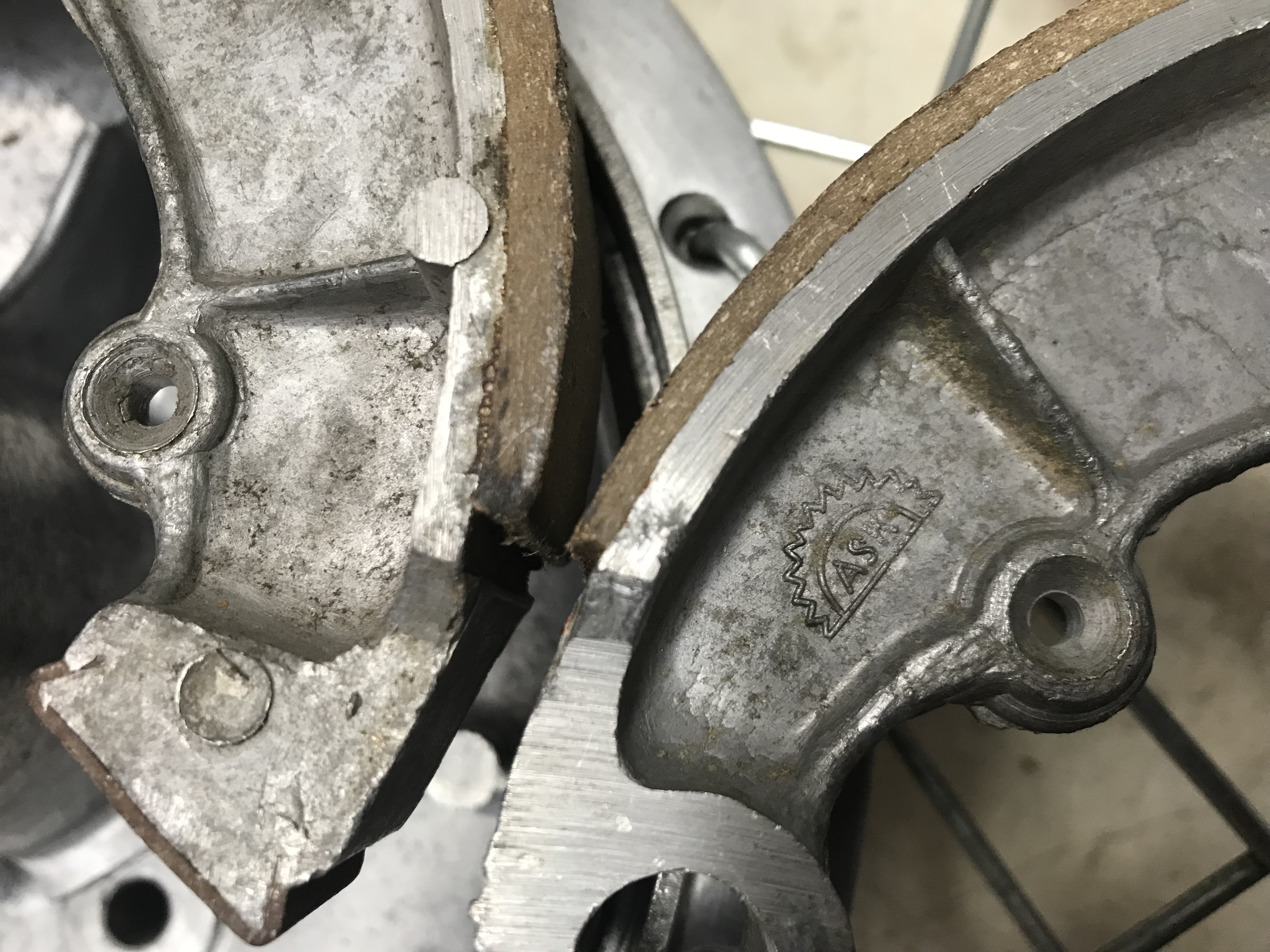

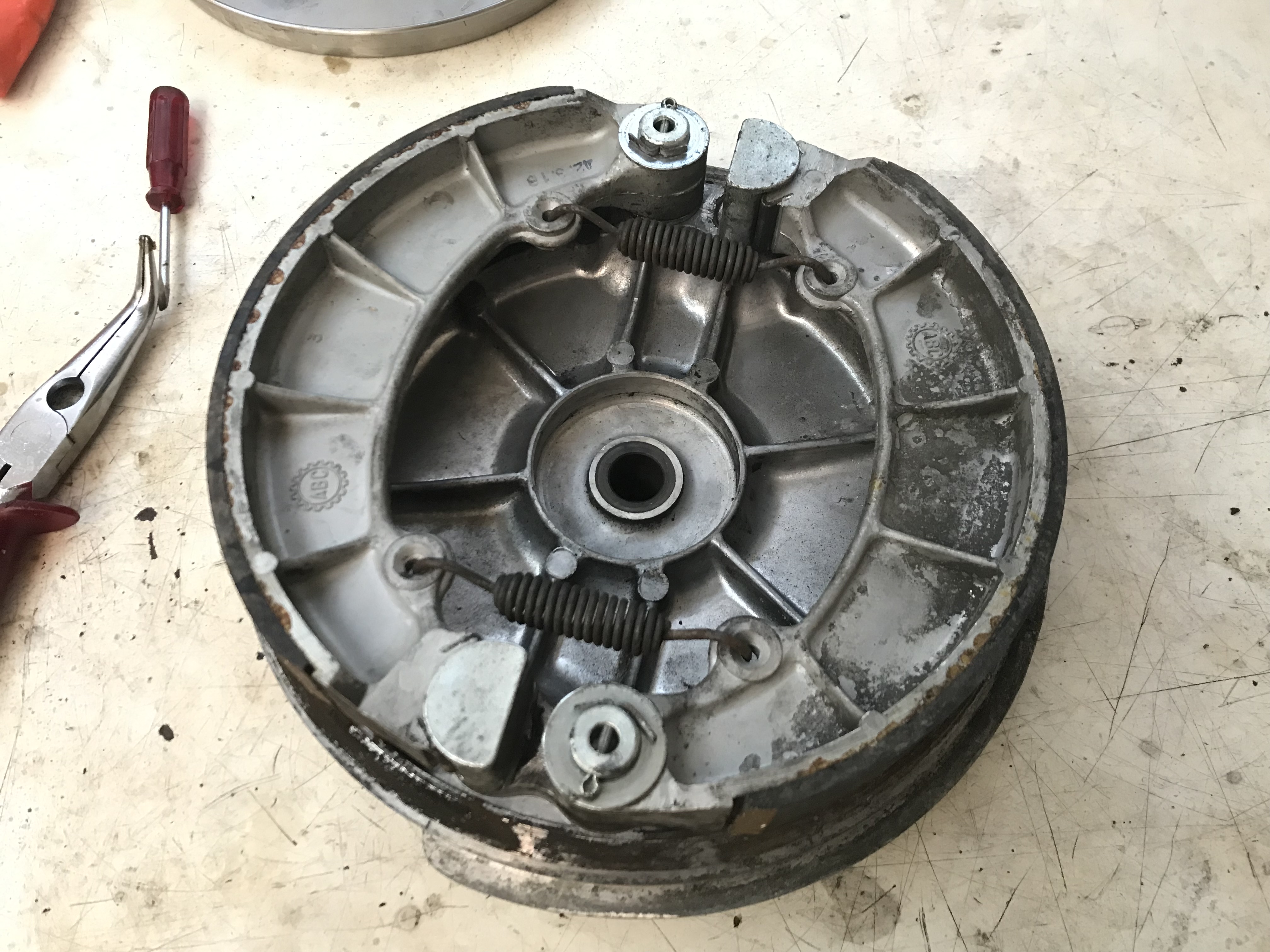

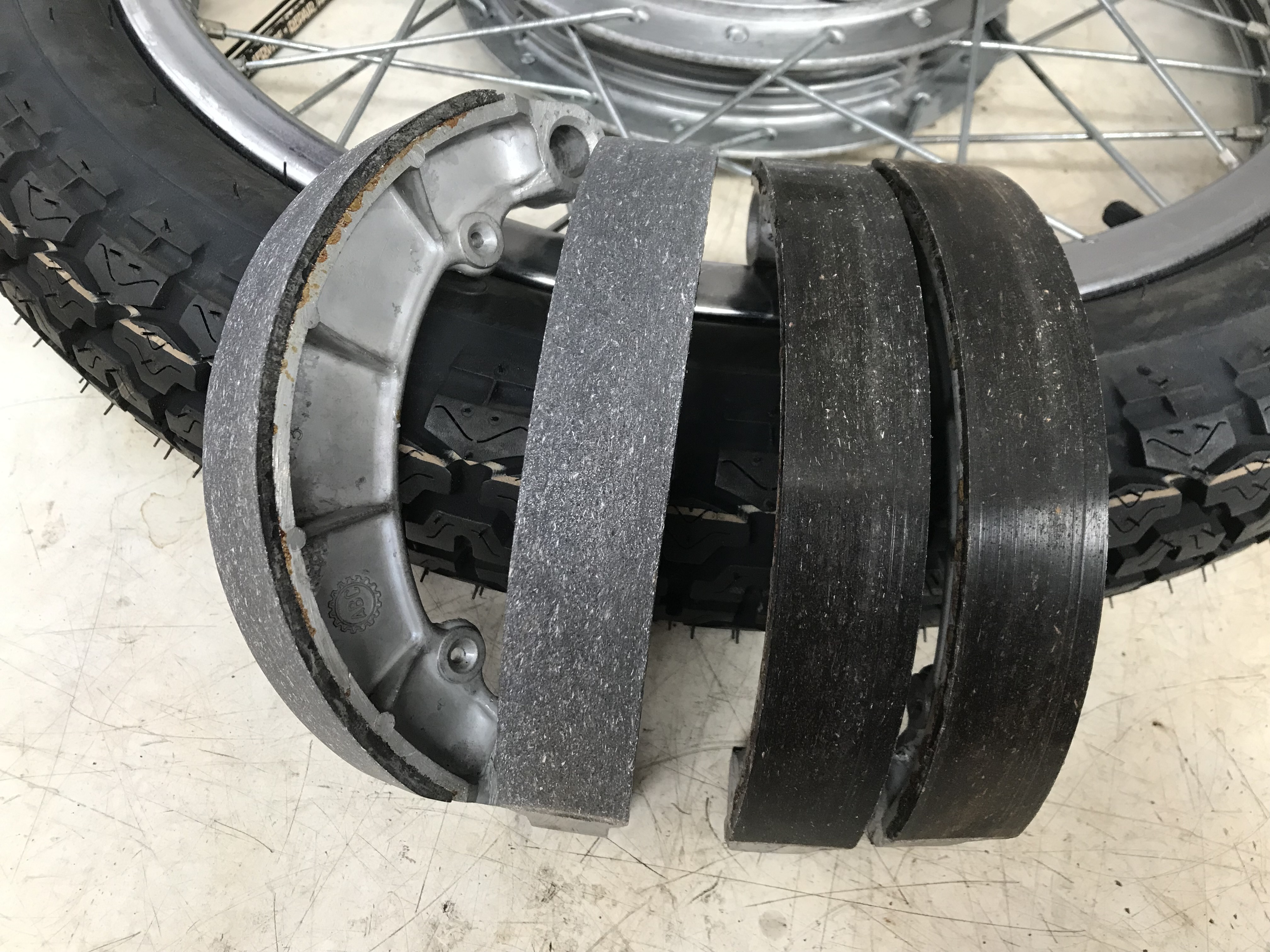

I bought 4 aftermarket brake shoes and I’m not impressed.
Rough and poor everywhere
I pick the best two and sand them to shape
The best of the old ones were the front hardly used. Cleaned them up to use on the back.

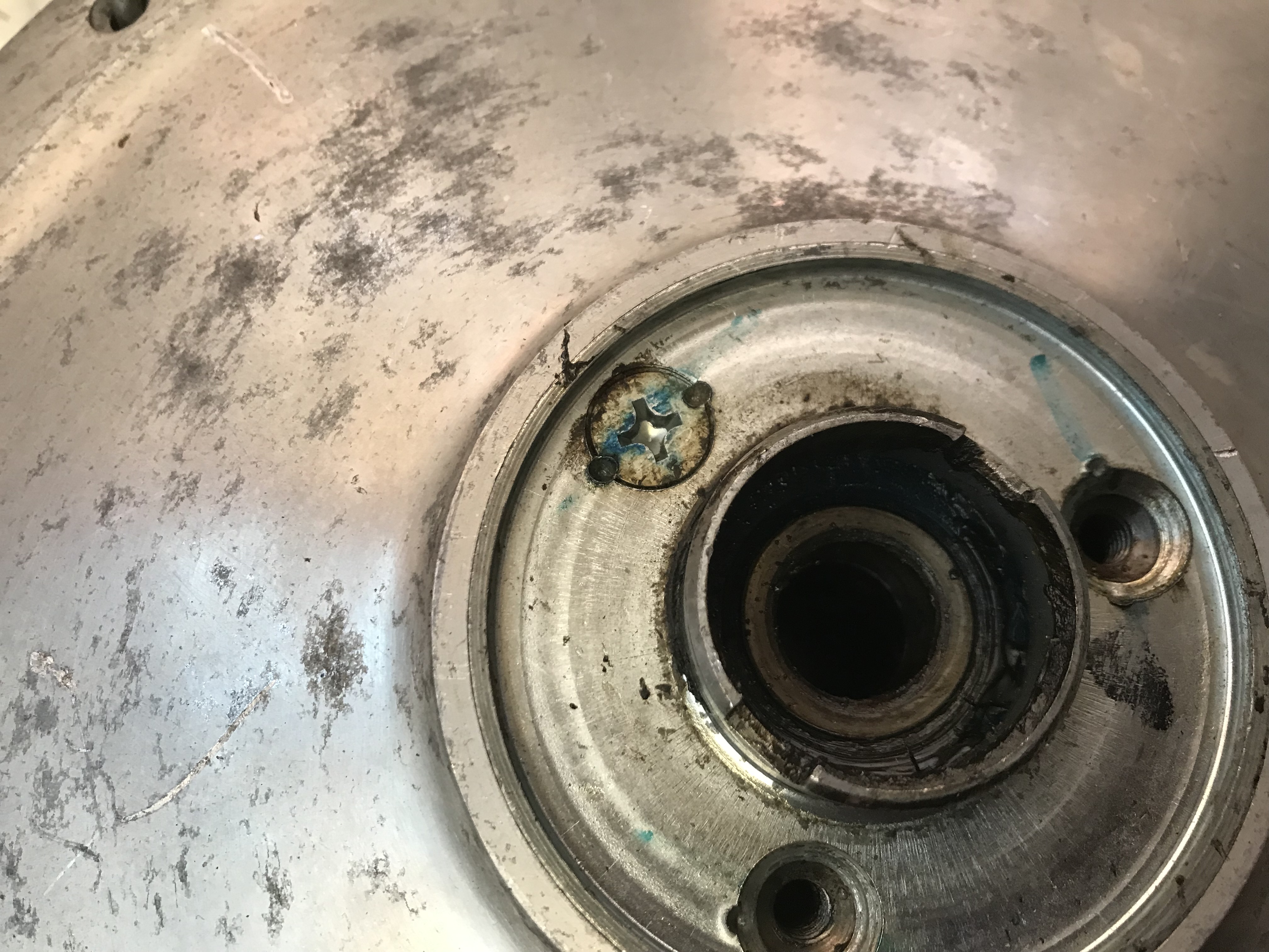

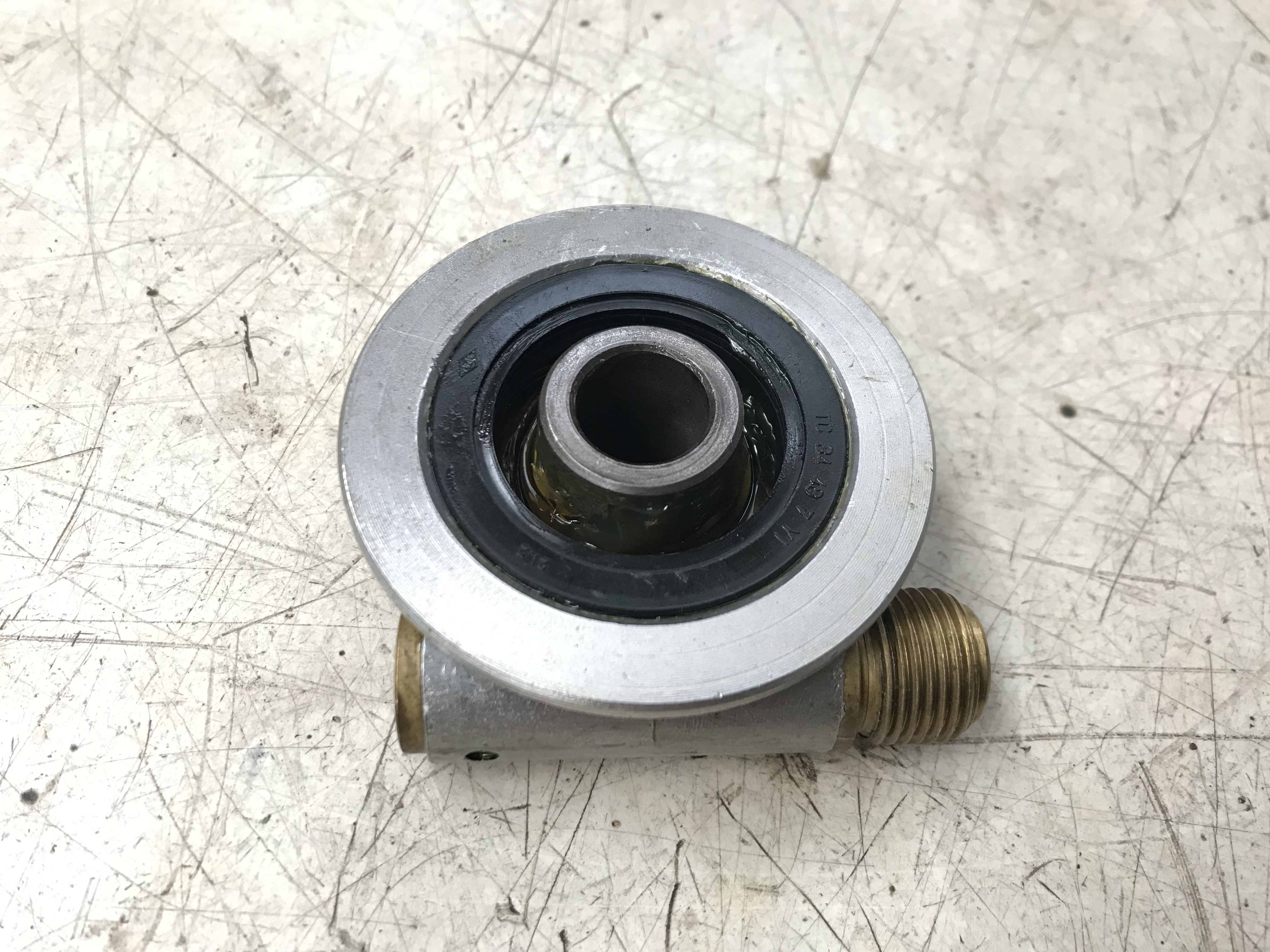

Speedo drive
Cleaned up

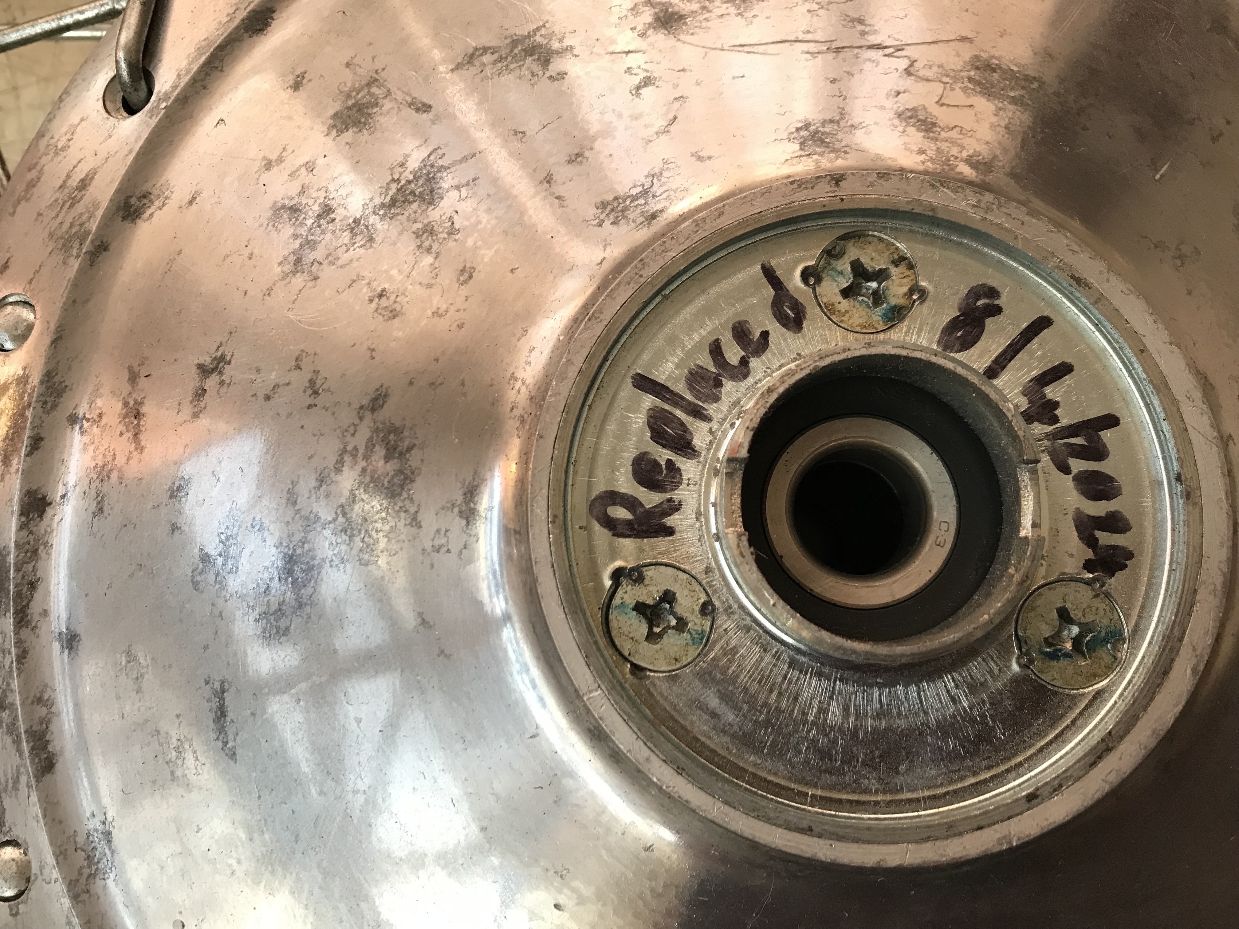

Wheel bearings cover
Before
Tioli
Posts: 756
Bike: ty175je , KDX/KX ,,,
Location: Tas
Post by Tioli »
After
