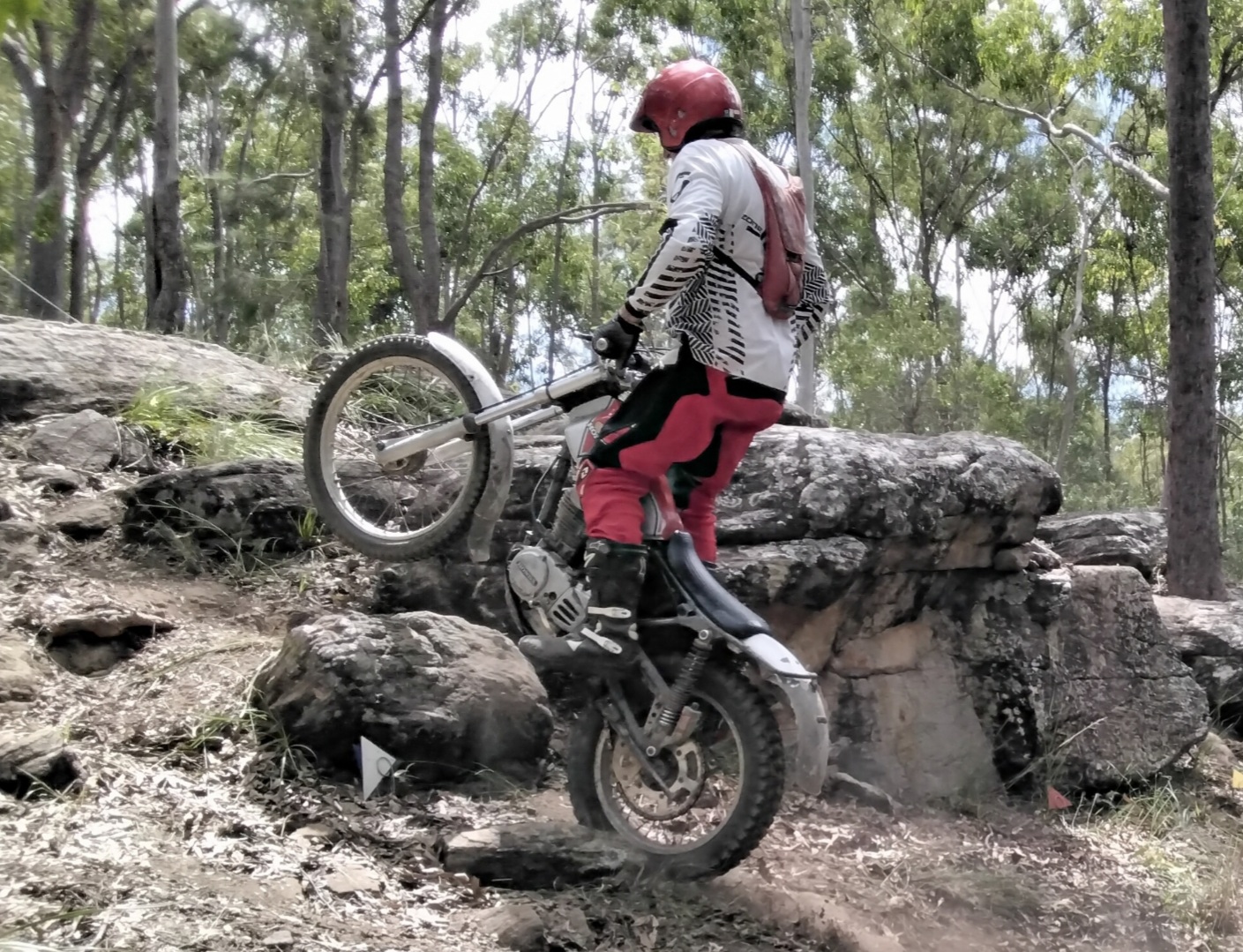

So I am really happy with all of the little modifications on my TL 250 and I never would have guessed that to make it better, you first must make it heavier!
The grips no longer slip.
The clutch and brake cables have a much nicer action.
The throttle is smoother and less vulnerable to interference.
A more substantial fork brace now holds the mudguard.
The 600 gram heavier flywheel really makes it much more rideable especially in tight turns and boulderfields.
Practice has made me better at predicting when it wants to lay down and have a rest!
Likewise with counteracting such desires, sometimes simply by slide of hand......
One of the other things that made it better was slightly more preload in the forks and new seals. When they made these, they were not cutting corners on quality or materials used:
2 kilos per leg!
2 kilos per leg!
These fork seals came to me with another TL 250
Here is something that I have not seen before in bikes from the mid 1970s, the sliders have guides as standard, this might be an option for worn sliders on other bikes.
Here are some action shots:
