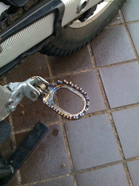

Re: Pivot Pegs
I've got them on my Sherco and they're great! I can ride my bike better than a mates bike of the same model and I suspect the foot pegs have got something to do with it. I still ride the same stuff on his bike as I do mine.
But, if they didn't come on the bike I probably wouldn't get them as they're expensive. next best thing would be a set of jitsie pegs or something larger than the standard ones.
definatly get them if you can afford them.
'02 Sherco 290
Re: Pivot Pegs
My brother runs pivot pegs on his Montesa and swears by them... From a practical view, it means that he does not have to take his foot off the pegs as much when changing from decline to incline (and vice versa) and, as his foot stays in the same position, it does not affect his centre of gravity. Granted there is not much movement required here, but when you are learning, as we are, any advantage is still an advantage.
Having said that, I too run a Cota 4RT and I do not like the feel of the pivot at all. Even worse are the standard Montesa pegs though, so I have upgraded to the Raptor Ti pegs. Sure they are expensive, but when it is a bit greasy, they give me great comfort as to my foot position without having to glance down. Also, given the considerable size difference, on a long ride, they reduce the ache in my foot arch.
So, not much help here except to say pegs really are a personal choice, I love mine, he loves the pivots, so who knows?
Greg
One foot note (pardon the pun) though, he did spend many years as an enduro rider and ran pivot pegs then so he does have a disposition toward them.
Greg

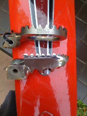

Re: Pivot Pegs
I've got the 4RT aswell ever since I saw the Jitsie pegs, I have been riding with them. It takes a few rides to get used to them, when you try to slide the foot across the peg it grips the Tungsten insert, so you have to really think about lifting your boot totally off the peg or else you'll get stuck and take a dive.
It really helps you in the mud.
- jitsie footpegs.jpg (3.57 KiB) Viewed 6077 times
