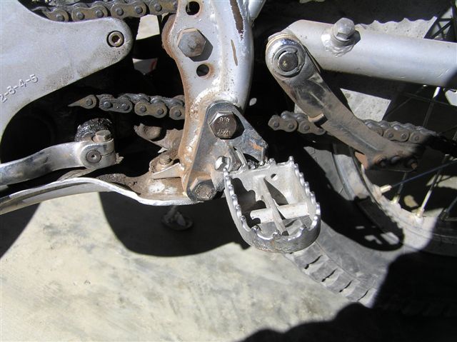

Have you Lowered you pegs? I made up some adapters and have the pegs in the lower cross tube. Also extended my pegs. Last trial I had some issues with clearance in tight rocks ( both of the things I did dont help) so want to optomise the size and position. Any ideas on this?
The pegs on my B model are only 25mm lower than standard and the handling is terrific and the bashplate still hits before the pegs. Let me know if you want a closeup photo.
As for how far the footpegs stick out sideways causing a problem with clearance to rocks, surely they can be made to reach to the outside edge of your boots before they become a limiting factor? If there is going to be a scrape against something, there is always the option to just lift your foot clear and allow the peg to be pivoted by the passing object.

Yeh send me a picture of you peg set up please . Mine is almost at the bash plate. Bash plate hits first. Maybe I need to chamfer my pegs a bit more so they do pivot more easily when they hit.
