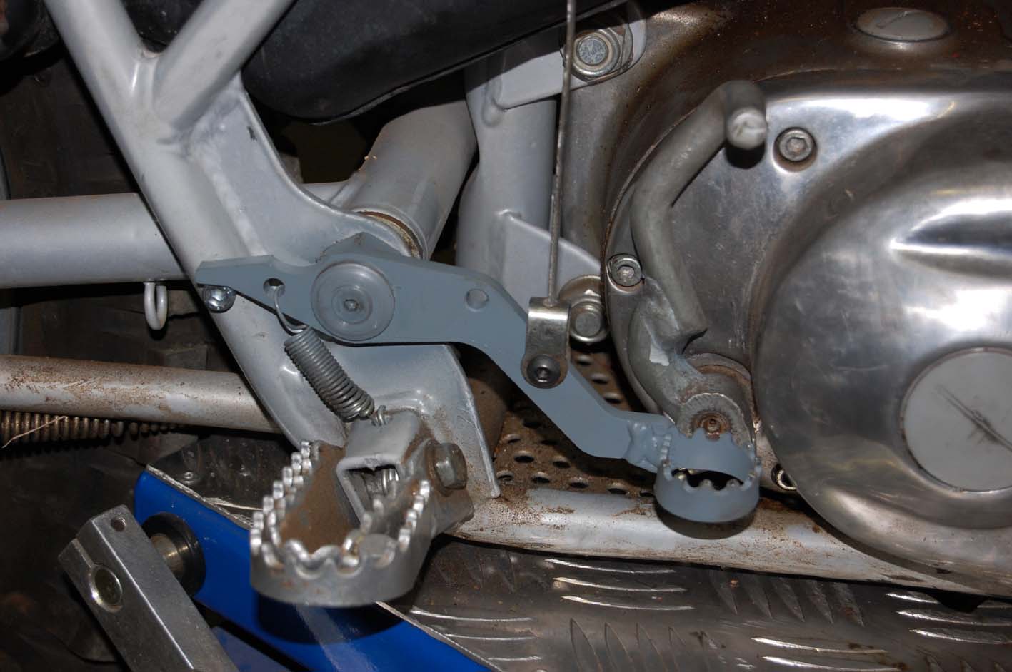

David,

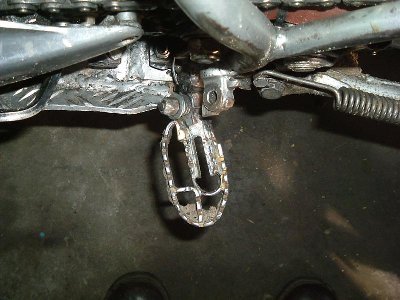

What brand of pegs are those on the TY? Is the pic of the 175 or the 250? I had to modify a set of unknown pegs to fit my Ty ages ago and they have no return spring. This was pointed out to me at the trial on the 1\7\07 at Mt Kembla. So I gotta get them fixed before the Pacific Park ride.
TY 250 Improvements
The original TL125 setup had a spring that clipped onto the end of the footpeg to hold it up for kicking. Most people took both that spring and the footpeg spring off and lived happily ever after.
Note that the rule in the MOMS says "self-returning". It doesn't say "spring loaded".
Gravity can be made to provide the self-returning action with careful design of the up-travel stop for the footpeg combined with a free pivot.

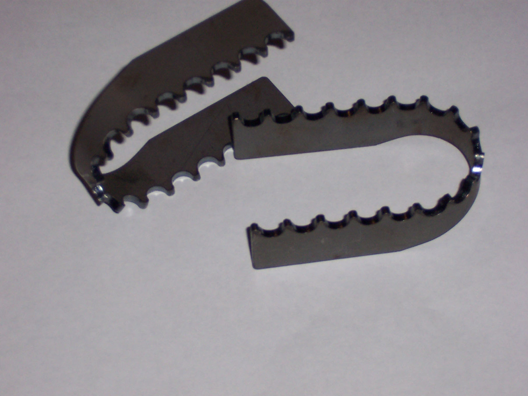

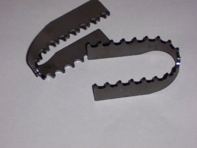

I would like to let you know that I make weld on foot peg loops
for your early model bikes in the same style as Hebo pegs.
We have these loops also fitted to late model Betas,Montesa and Sherco
to increase the foot peg size.
If you would like any more info you can email me at.
[email protected]
Or give me a call on 0415 861 036.
Cost: $27.50 inc GST plus Postage.
The second photo is of my 1972 M92 Sherpa T fitted with foot peg loops
and brake conversion.
Thanks.
Phil
PTR Engineering.

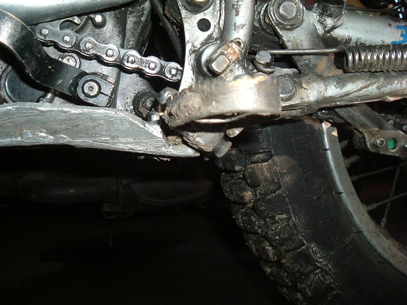

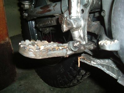

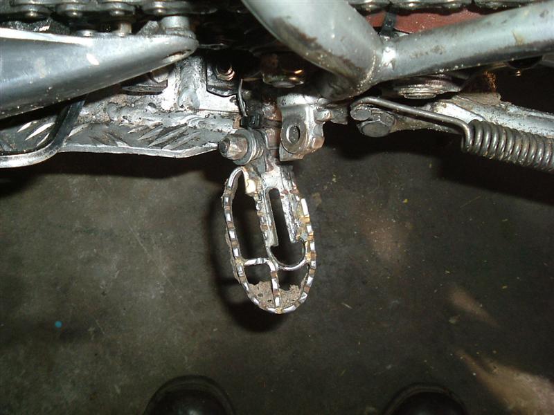

Your peg set up looks good. I made my extensions myself and bronzed them on to the originals and welded an adapter into the bottom cross tube. My Pegs are 50 mm lower than the standard set up. May be to low but still have the option to put them back to the original mount which I think I will try and see if their is much difference.
I noticed your back sprocket is much smaller than mine. I could make a significant weight reduction here. Is yours set up 520 and what is the gearing? Would this be the same for an A?
Are you able to post a photo of your footpeg mounting setup? Lots of people want to try lower pegs but dont want to cut off the original peg lugs.

David
Picture below shows the set up with the existing mount above. I used a solid bit of bar that fit nicely in the bottom cross tube and ground it away to get near to the same shape as the original mounts and built up some spots with weld as required. Then you need to tack weld the new adapters into the bottom tubes.
The 428 sprocket is much smaller than the 520.
