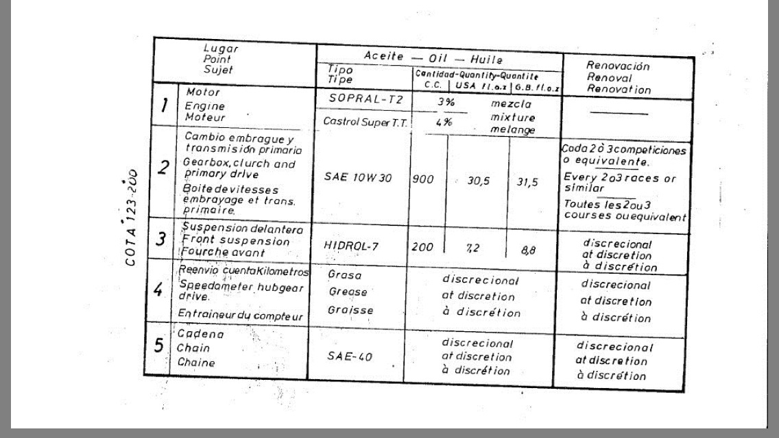

1982 COTA123/200 Quantities
- image.jpg (167.5 KiB) Viewed 8720 times

I have just had additional confirmation from Jared Bates from South West Montesa;
The correct amount is 900 cc. (30.5 ounces) clutch and gearbox are combined on this model.
