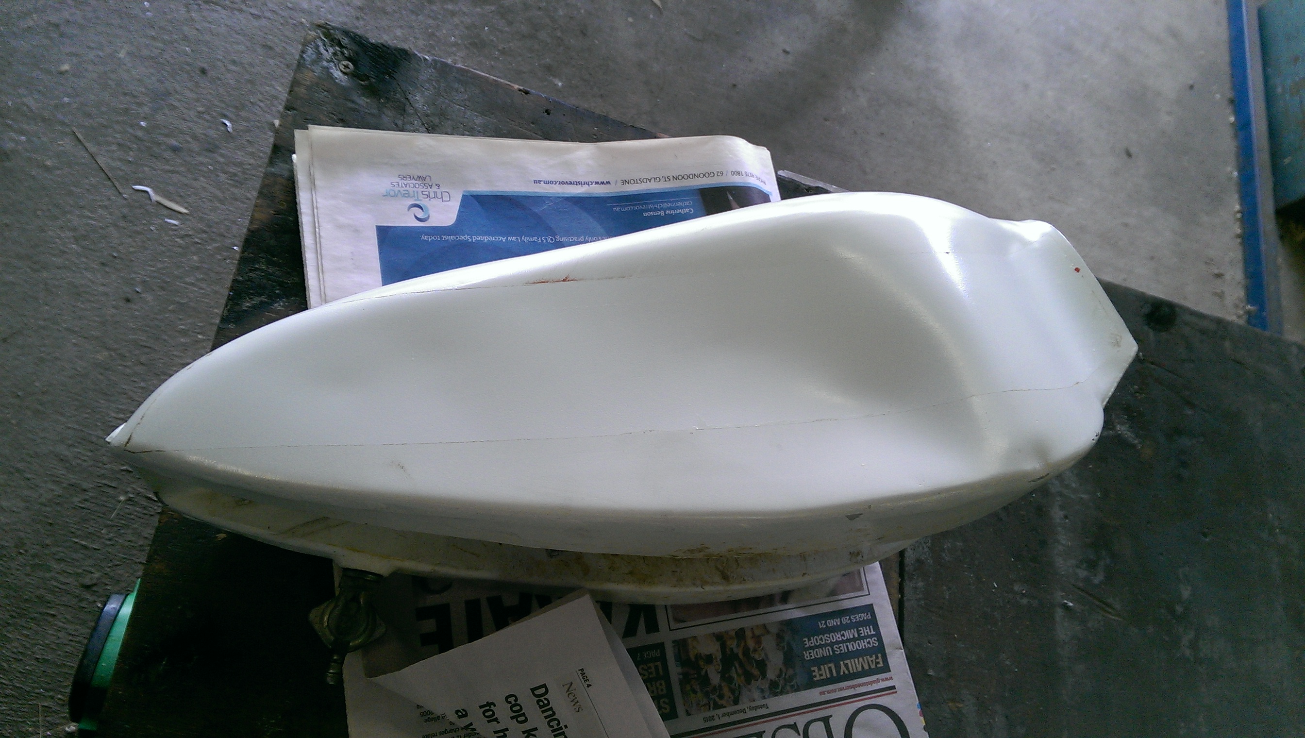

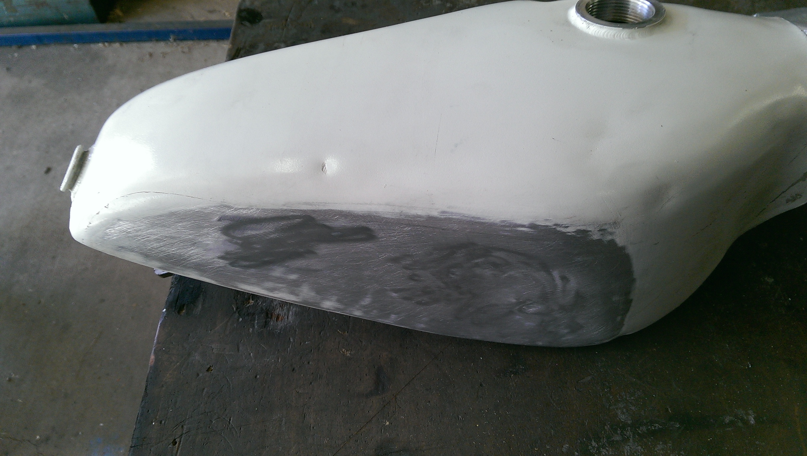

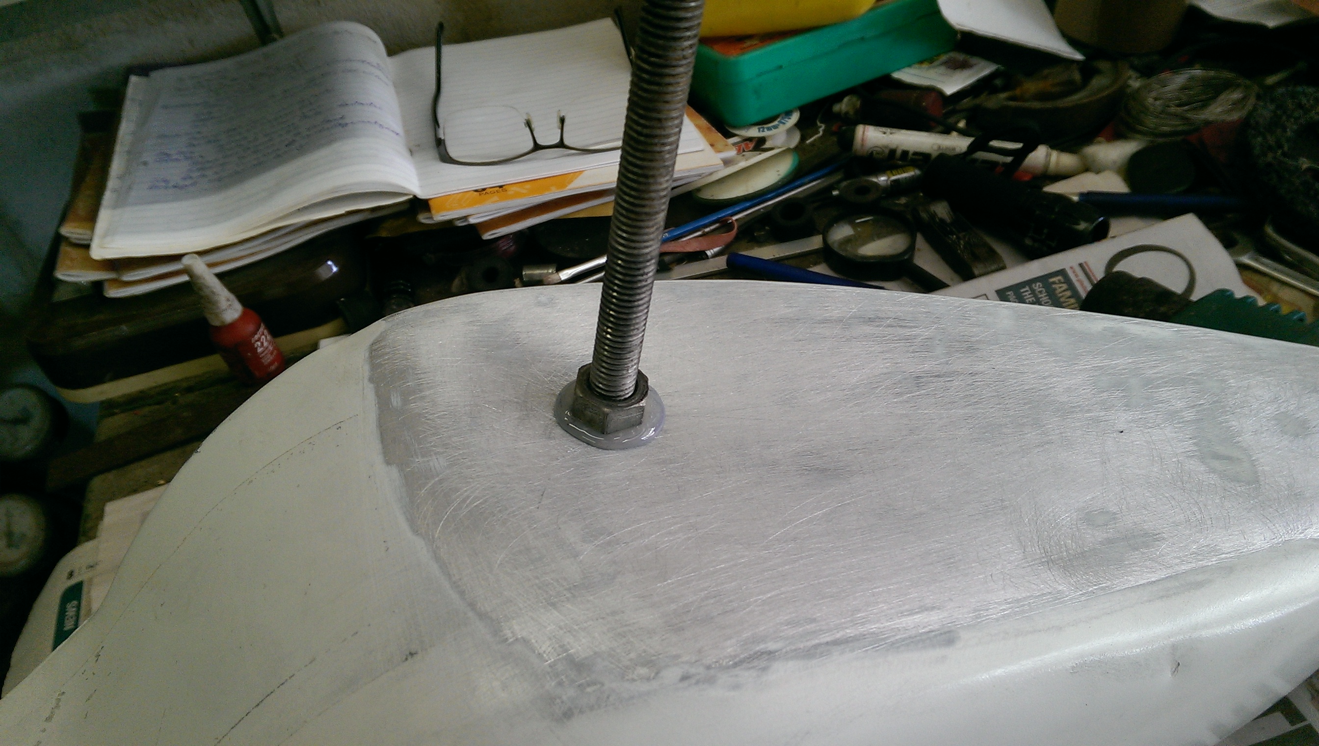

I finally got to use Stan's hot-melt glue method for dent removal today. It worked well on this very lightweight aluminium tank, taking out a knee dent. I pulled by hand (no slide hammer), holding against the tank with my feet just like Stan did. The metal moved at near the limit of my strength and I pulled in four different places to get the results shown.
Luckily my wife has a hot-melt glue gun and was willing to let me loose with it in the workshop. I found that I needed a hot-air gun to get everything hot enough to make the glue hold well. I let it cool for about 10 minutes each time for the whole thing to get cool enough for the glue to hold well.
I stripped the paint off and scratched the surface up so the glue would hold well. Each time while I was practicing the technique, the glue pulled off the nut, never off the tank, so I think if I do it again I will make a special end piece to go on the pulling rod, that has a scratched-up surface for the glue to stick to better.

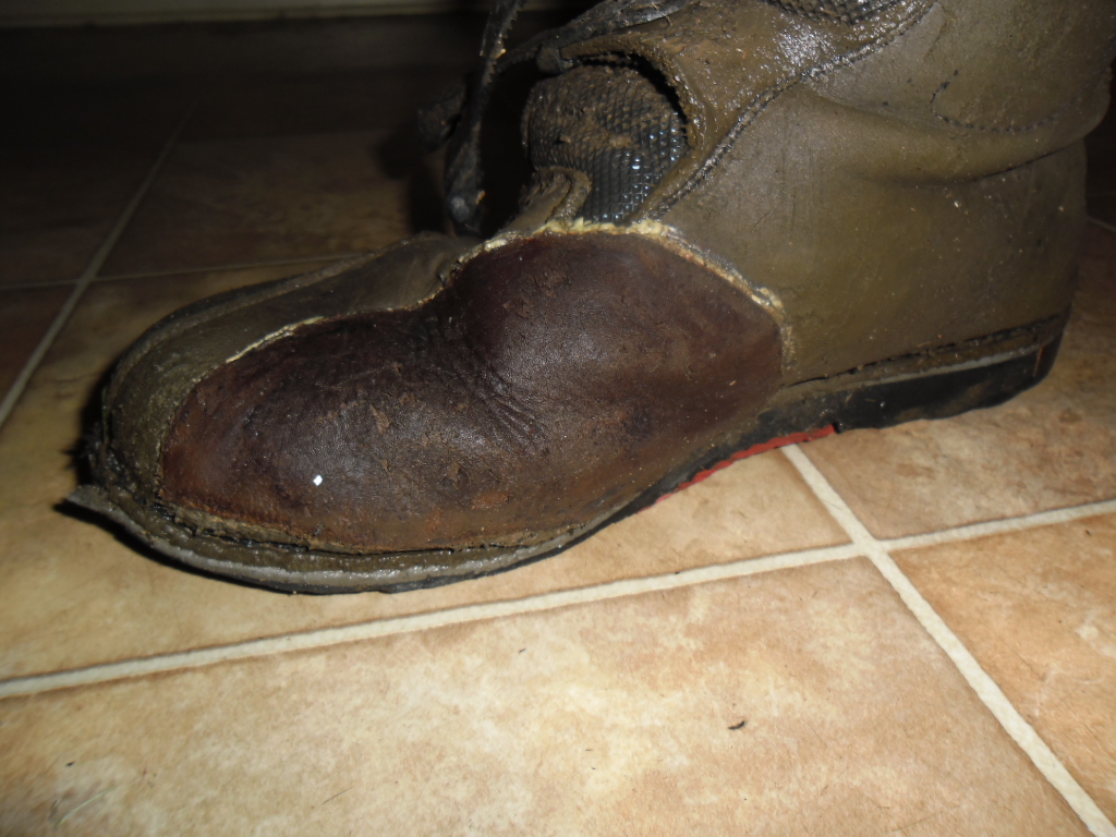

Well glue! That's another topic of interest for those keen to mend things and save a few bucks.
And trials boot being expensive are always something worth fixing with a bit of glue but what glue???
I tried the Kwick grip to glue on my my alpine stars and it lasted only a few rides. Tried it several times and wont use it any more it. Wont work for me.
I have glued my Hebo sole on a few years ago with black poly eurothane and it worked OK but yo needs a long time to dry.
So I did some research recently and decide to try some gorilla Grip. Re glued the alpine stars and so far it looks like it is working well. I also put a leather patch on my sons boots directly over a big hole and it stayed on, So far i am impressed with this glue. This glue need clamping for a couple of hours and is good to go in 24hrs. Clamping was with copious amount of staples.
Any better ideas on gluing out there????

Our stuff in the USA is called "Gorilla Glue" which I suspect is the same stuff, you wet the material to be glued and clamp it after. I repaired some broken stitching on Hebo's about two years ago thinking it wouldn't hold but it is still solid. I'm impressed and have found nothing better. A shoe repair guy told me to use it on the sole if his glue didn't hold but said it couldn't be resoled after.
