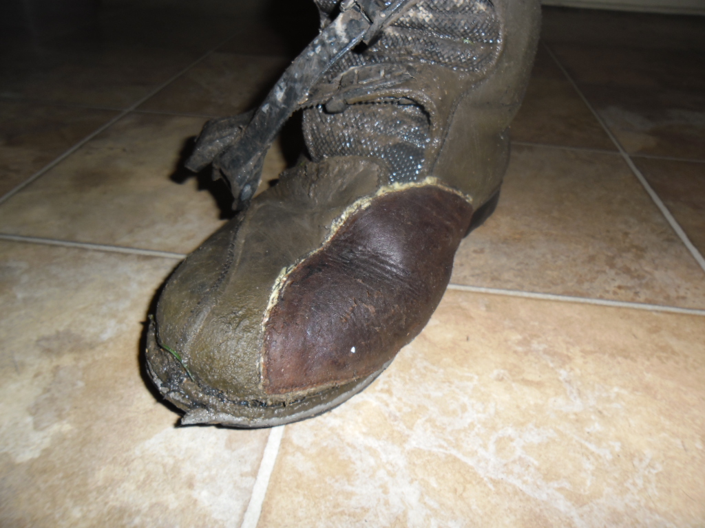

Well glue! That's another topic of interest for those keen to mend things and save a few bucks.
And trials boot being expensive are always something worth fixing with a bit of glue but what glue???
I tried the Kwick grip to glue on my my alpine stars and it lasted only a few rides. Tried it several times and wont use it any more it. Wont work for me.
I have glued my Hebo sole on a few years ago with black poly eurothane and it worked OK but yo needs a long time to dry.
So I did some research recently and decide to try some gorilla Grip. Re glued the alpine stars and so far it looks like it is working well. I also put a leather patch on my sons boots directly over a big hole and it stayed on, So far i am impressed with this glue. This glue need clamping for a couple of hours and is good to go in 24hrs. Clamping was with copious amount of staples.
Any better ideas on gluing out there????
Our stuff in the USA is called "Gorilla Glue" which I suspect is the same stuff, you wet the material to be glued and clamp it after. I repaired some broken stitching on Hebo's about two years ago thinking it wouldn't hold but it is still solid. I'm impressed and have found nothing better. A shoe repair guy told me to use it on the sole if his glue didn't hold but said it couldn't be resoled after.

Iv tried most glues on boot soles, the only one that worked for me was superglue gel, but only if no other glue has been used, apart from original, which could be something similar. Has to be clamped for a day minimum.

Glue - for boots, I have used Sikaflex, it's a polyurethane and is flexable and high bonding. Needs the usual set time overnight clamped etc. only downside is cost, need to buy as caulking tube and gun, don't really get the value out of the tube as it goes off by the next time you find a use again.

Yeh Pop I know what you mean about the sikafex going off. I keep all my glues in a fridge and the sikaflex polyeurothane still gets wasted. Someone told me that the Gorilla glue has a similar problem and it goes off after a while.
Any way the gorilla glue was tested out on my sons boot in a pretty wet 2 day Vic championships. This patch of thick but soft leather was put over a large hole on the side of his boot. Two day of wet comp and no sign of coming off. I don't think I know any other glue that would produce this result. Now I am really impressed.
