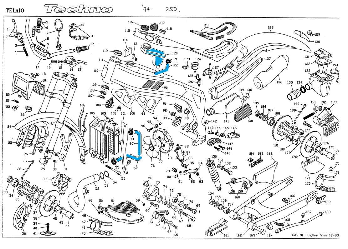

Prior to ride
Prior to ride,I am studying Techno.
As she is my first 2 stroke motorcycle.
I was wondering where I should fill cooling liquid.
Cap of EVO locates top of radiator.
But Techno has no cap at top of radiator.
I found the tank cap locates next to fuel tank cap.
Wow,I have to mix fuel and engine oil by myself.
I thought filling separately and mixed automatically.
Real competition motorcycle!
updated.
updated.

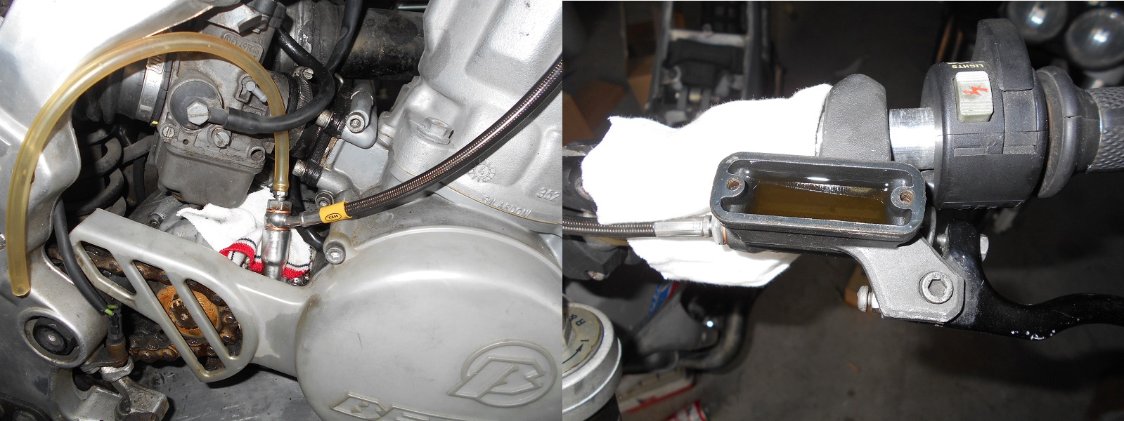

Received Hydraulic clutch hose from HEL in UK
I replaced damaged hose with new one from HEL.
I filled DOT4 but DOT4 did not flow and no air came out.
Spring could have wasted or rubbers for piston could have wasted.
Or cylinder housing could have wasted.
Nevertheless I will replace with complete Hydraulic master cylinder with lever.

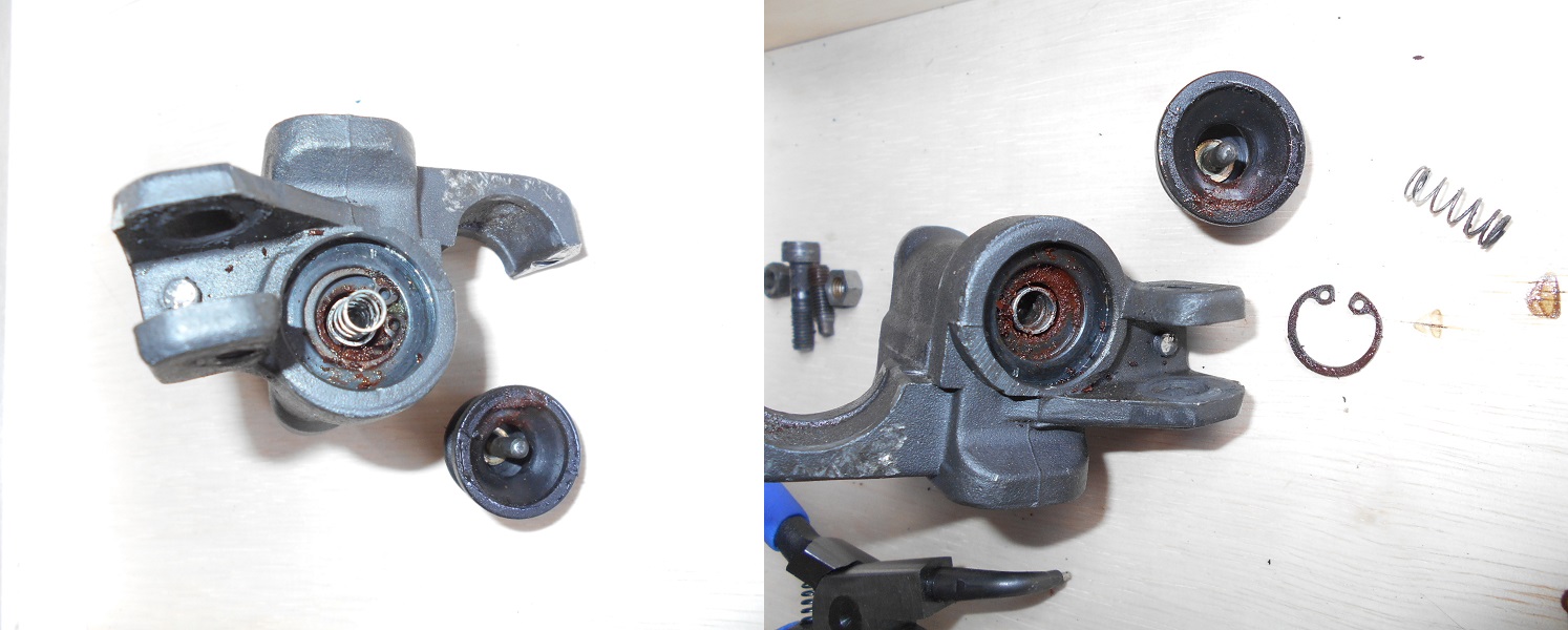

Clutch repair
I decided to overhaul master cylinder.
When opened,rust came.
Umm..
Spring receipt cup stuck at entrance.
Umm..
- Techno油圧レバー修理-2.jpg (246.21 KiB) Viewed 33594 times

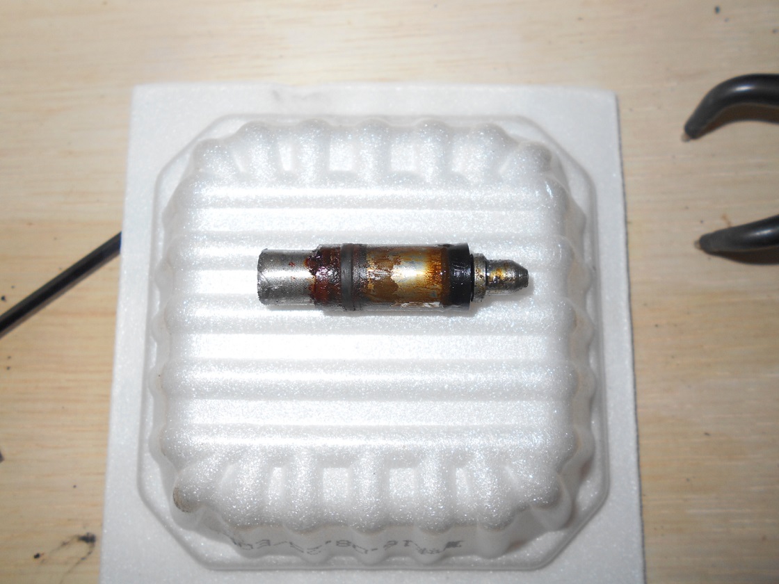

Re: New from Japan
Finally I could get out piston which rust worst.
- Piston got rust.jpg (258.45 KiB) Viewed 32861 times

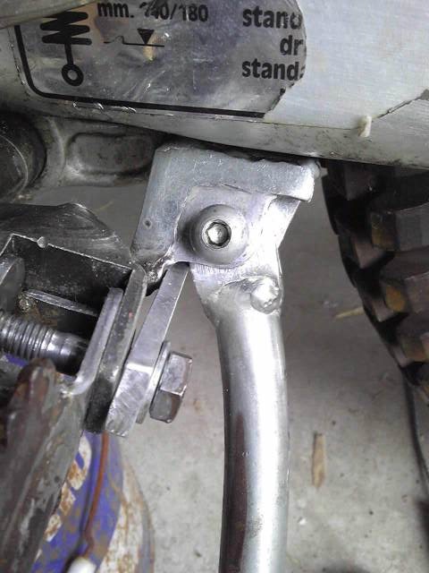

Worn side stand
Side stand receiving part worn so that body could not stand alone.
I made a aluminum spacer in order to go side stand backward.
It is not bad. When worn again,I will replace it with steel plate.

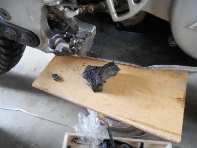

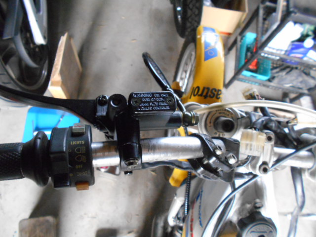

Hydraulic clutch issue
I gave up replacing with new seal kit and HEL hose.
Finally I got Chinese master cylinder and hose as shown on picture.
I assembled them onto Beta and filled DOT4 fluid.
Then I found a piece of chain slide block lie down on bumper plate.
Every parts seemed to be worn. Chain tension block is as well.

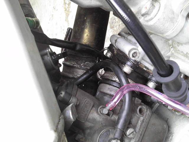

Gas leaked at petrol cock
As I finished installation of new clutch system,I filled mixed gasoline to Beta.
But gasoline leaked at on position. I will replace with new petcock for Techno.
