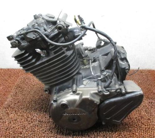

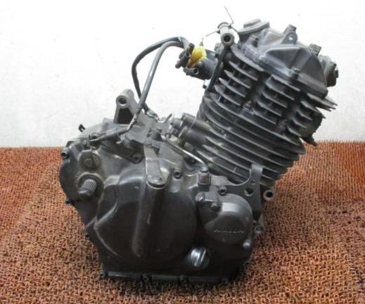

I believe the TLR250R is unique, not the same design as TLR250F, Rtl250 or XR250 it appears to be made and sold mainly to the Japanese market.
Note where the kick start shaft is up high and the cam chain is on the RH side
Honda tlr250r LH side.jpg (43.07 KiB) Viewed 14486 times
Honda tlr250r RH side.jpg (42.59 KiB) Viewed 14486 times
