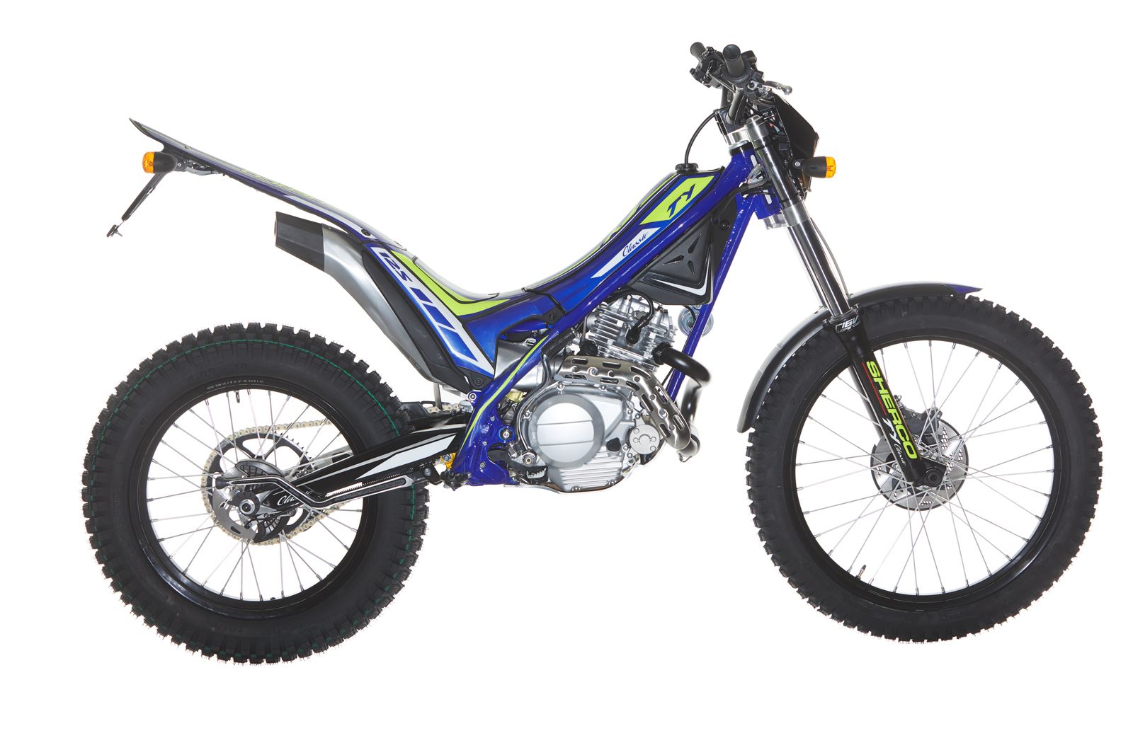

TrialTech,
I see a horn but no mirror in the images.
I assume these bikes pictured meet VicRecReg requirements and meet the concerns outlined by Hell Team around importation.
Full reg would be a better option (eg Gas Gas Contact) but I live in Victoria and we have the rec reg possibility.
Peter

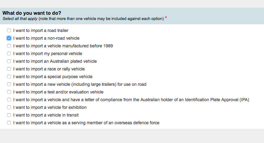

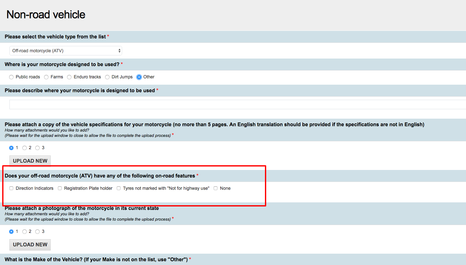

I have imported well over a hundred consignments of bikes from Europe and Japan over the years. I am trying to offer sage advice to help.
Please see below excerpts from the import application that must be filled out when importing any vehicles into Australia.
Firstly you are asked the type of bike you are importing. If it does not have plate approval then you chose "I want to import a non road vehicle"
The importer is then asked a series of questions about the motorcycle.
One is "Does your vehicle have any of the following "on-road" features:
Direction Indicators, registration plate holder, Tyres marked Not for Highway use, none.
If you tick anything but None" that's the end of the line for that application.
You also have to submit a specification sheet, and photos of the motorcycle, amongst other information.
The photos you posted of the two Shercos do not meet those requirements. So they cannot be legally imported into Australia. That's all.
As I stated do the research, and you will make the correct decision. You can ring The Department of Infrastructure and Regional Development and they can advise you of the requirements if you are unsure, or need clarification on anything.
This is not "scare" tactics.
