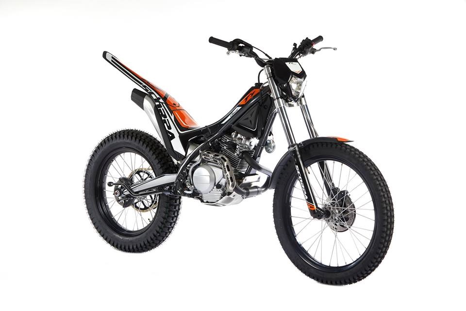

TrialTech,
I see a horn but no mirror in the images.
I assume these bikes pictured meet VicRecReg requirements and meet the concerns outlined by Hell Team around importation.
Full reg would be a better option (eg Gas Gas Contact) but I live in Victoria and we have the rec reg possibility.
Peter

by TRIALTECH
The mirror just clamps onto the bar..
