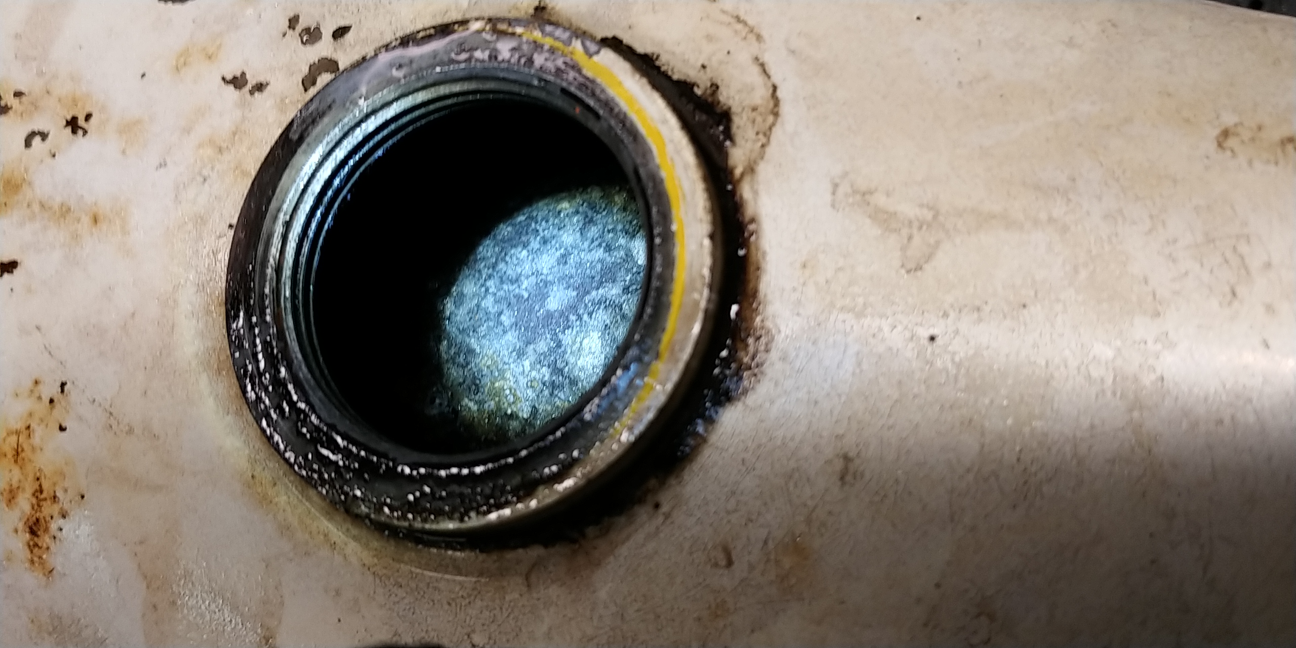

I just had a look at how the
TY250A tank de-rusting was going.
Lots of dark sandy-looking oxide came out when I tipped out the molasses and gave it a rinse with water.
I reckon about half the surface area inside the tank is now bare grey coloured steel and the rest is still coated with dark red-black oxide deposits. Where I could reach with my finger I could rub the oxide deposits off so I reckon it's not too far off being finished now.
The level had continued to go down since my previous posting.
After seeing how much oxide came out I'm a bit
that there might not be much steel thickness left. It hasn't leaked out any molasses.....yet

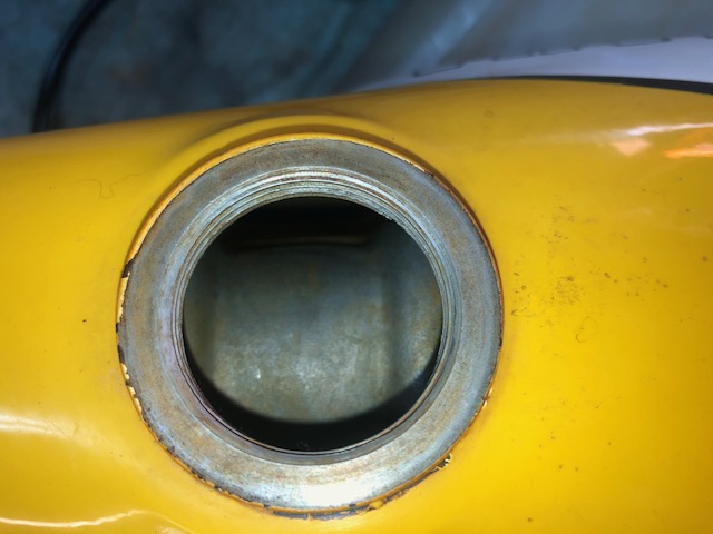

Hi,
I was able to buy my Dad's original TY175 back after he had passed away, the tank outside was still very good.
But inside it was crap. See attached pictures.
I used White vinegar to clean all the rust out. I filled it to the brim, left it for two days, put a short length of dog chain in & shook it round to dislodge the rust.
Emptied the crap out, refilled & left for 3 more days & hey presto.
Just like new.
Just like new.

Well I had another look in the molasses-filled TY250A tank this evening and it is getting pretty close to being finished. I did the Gary B trick today but using 250 large clouts instead of dog chain and it did a good job knocking off more of the remaining scabs of rust. The photo is how it looked after the Gary B treatment. There are still some scabs away from where I could get a photo so it's back full of molasses again. Two weeks so far.
- 20200329_175052.jpg (1.09 MiB) Viewed 3675 times

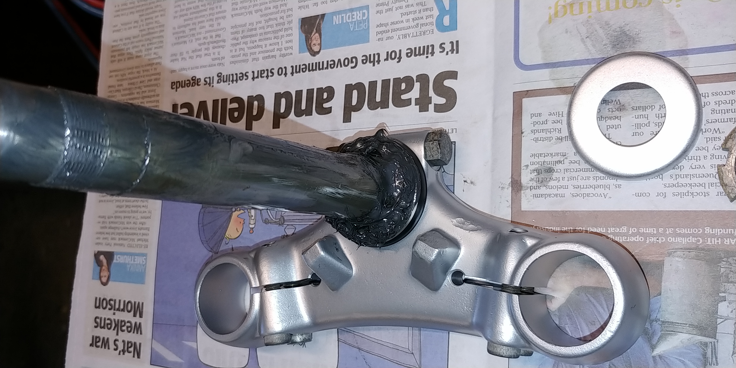

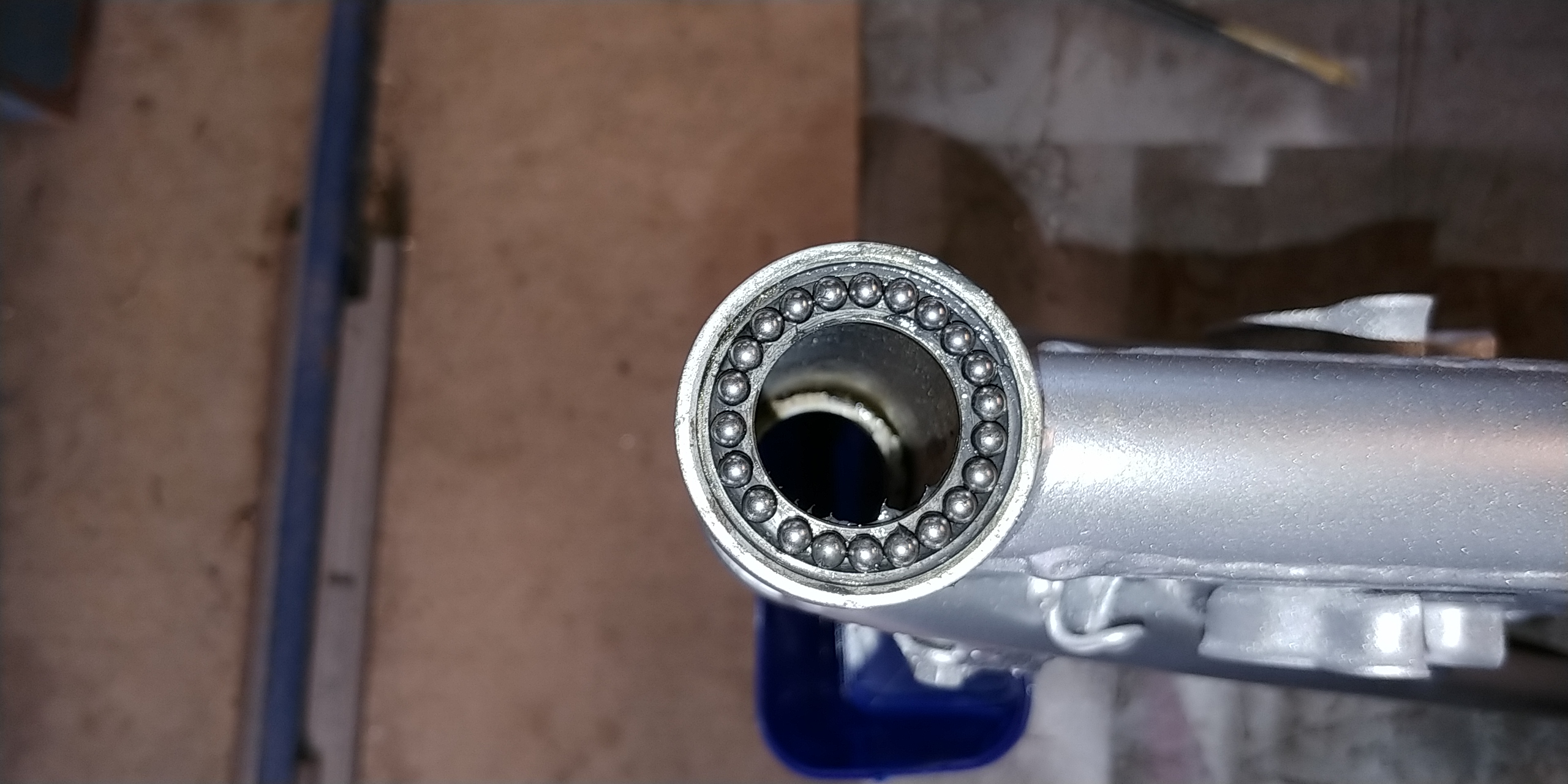

Back on the other TY I'm working on.
I'm reusing the steering head bearings that were in it when I pulled it apart because there was nothing wrong with them.
I've been doing the reassembly like this for many years but am always open to learning about other ways that people do them.
First I stick the upper balls in place with grease (more grease to go on yet).
Then I stick the lower balls in place with grease.
Then I slide the axle up carefully, put the top nut on and then the top triple.
Does anyone do it differently?

That is how I`ve been doing it for years too David. I have put Tapered bearings in my three Sherpas now so I can just add some grease and put it together Mush easier!
Re: Extra home workshop time
Bully fanatic wrote:That is how I`ve been doing it for years too David. I have put Tapered bearings in my three Sherpas now so I can just add some grease and put it together Mush easier!
Ahh that's cheating
