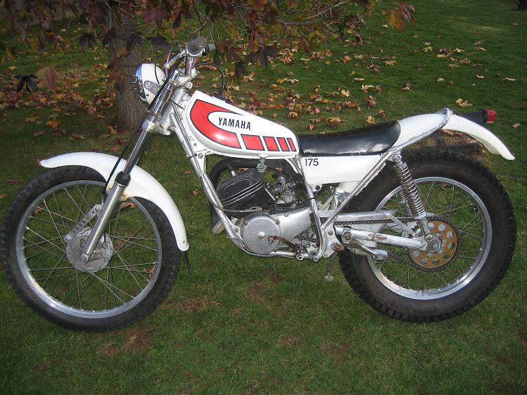

And so it begins:
Don't expect overly rapid progress, as it's one of... let me see... one of four consecutive bike projects*, but I'll post more pics (and questions, no doubt) as it progresses.
*Others are AT2 resto, YZ250K rebuild, and DT175C paddock bike, if anyone cares.

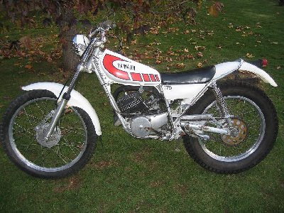

Post by browndog »
The most common mistake made was to let out the fork legs so the top was flush with the top triple clamp. The factory setting is in fact 22mm from the top of the steel fork tube down to the top of the triple clamp.
Chassis geometry is as follows :-
Caster/Trail 63 1/2 degrees / 97mm (from TY175C Owners Manual).
See also attached pic of recently sold TY175D (1978). I owned 2 B models new and have always liked them. Much more nimble than the 250.
Clean out the ports, clean out the exhaust and ensure the points are nor worn as the timing retards as the points wear (so put in a new set and advance the timing to 1.8mm BTDC, this is more important than the point gap, which is stated to be 0.35mm - 0.4mm.
Also it is beneficial to replace the ignition coil (under the tank) with a marine unit from (I think from memory) a Suzuki outboard twin sylinder 20hp model, as the ratio of primary to secondary windings is 70:1, the TY coil is 50:1, so you get better spark at low revs.
