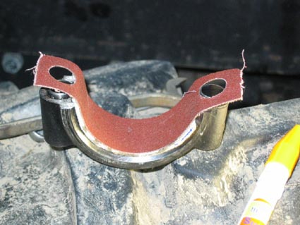

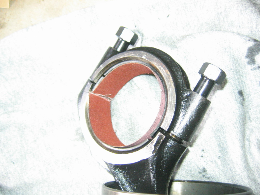

The wizbang in engine crankshaft linisher!!!
Here it is, and yes the crank looks nearly good enough to fit a bearing to and the battery isn't even flat yet! It is a big battery. The only problem I have is I just figured out the engine is oil and water cooled. Instead of having water around the cylinder sleeves it has oil and then outside that is the water cooling in the block. What that means is.... any drop in oil pressure will have an impact on engine cooling because it may not circulate enough oil around the sleeves. The importer is making noises about doing a special deal on new tractor (one that you can buy bits for) so I think I'll leave the second belt sander belt in one piece for now.
The key to the linisher is Super Glue, it holds the emery to the cardboard and the holes stop the emery from spinning. Am I clever or what :P
And no the rod is not bent, it is angled so you undo the bearing cap through an inspection plate in the side of the sump.
The one that didn't work!
The one that did!!!
The one that did!!!
