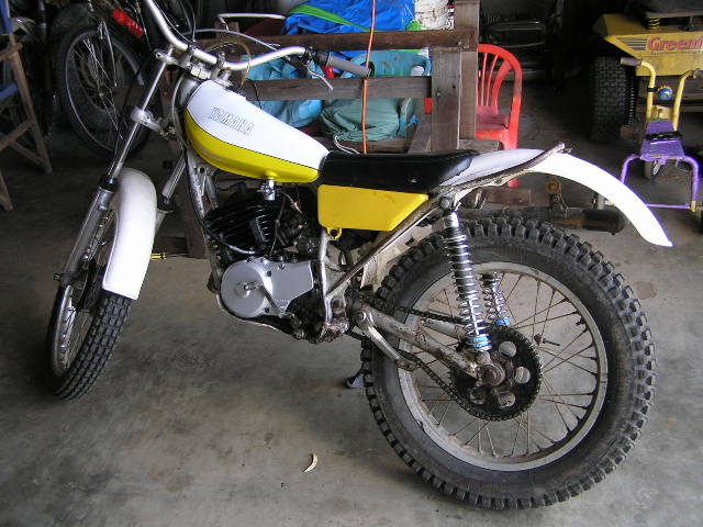

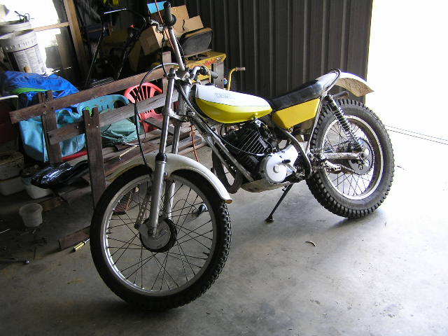

Thanks David. Looks like a straight bolt in fit?
My Videos - My Club
Re: TY175 - DT175 port timing and head differences
Betaman wrote:Thanks David. Looks like a straight bolt in fit?
Almost. There's a section of DT engine casing that requires a little dent put in the left frame tube under the motor for clearance. The person who fitted the motor did it before I got the bike.
Then again maybe that frame was not perfect and the tube under the engine was a little bit higher than standard and a completely straight frame wouldn't need it? I haven't had that motor in a different TY frame yet.

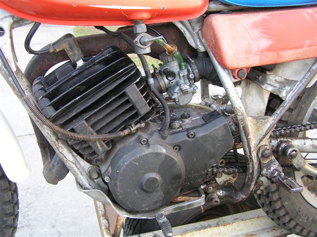

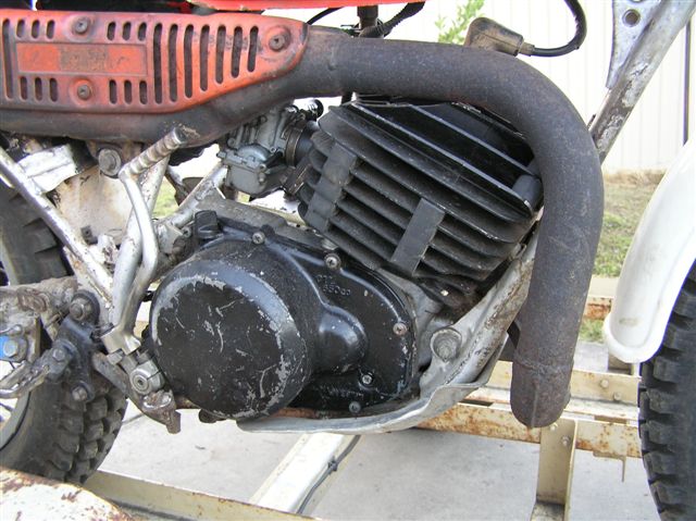

The finning is bigger on that series of DT175 motor making the exhaust is a closer fit and the cylinder fins are closer to the front downtubes.
I'm not sure you picked up from my posting way back about this motor but it has a TY175 crankshaft. This is similar to the DT175 crankshaft but the flywheel taper is bigger. The bigger TY175 flywheel means that the DT175 flywheel cover needs some internal trimming to provide clearance.
The other interesting thing on that motor is that it has an IT175D/E/F YZ125D/E/F clutch cover which are much more plentiful than the very rare YZ125C/X clutch cover that fits the TY175 right side engine inner casing.
I think the DT175 E/F/G motor is quite suitable for fitting in a TY175 but would need extra flywheel mass added to the DT175 flywheel for trials
