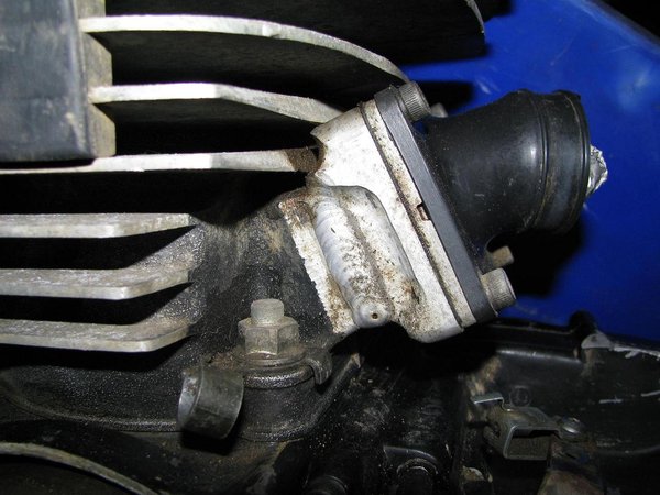

The inlet manifold mod was also done for many top lads by Mick Andrews, he took the standard barrel and shortened the whole thing, machined back the fins and welded the reed block back in as in attachment. The barrel was also bored out to 270cc and it generally made the whole thing a bit more responsive and torquey. This was around 1987>1991 to my knowledge and needed a good carb set up and run on old 4-star high octane petrol. The ports were also modified to put a bit more air/fuel into the back of the barrel and so prevent the pinking experienced by Ty's and similarly on 315R's that were not ported. Additionally the barrel was skimmed top and bottom ever-so-slightly to give more crankcase/scavenge compression and piston compression. Unfortunately with the advent of unleaded fuel it all went wrong and they pinked even worse until super-unleaded came along. Now we can use Shell V-Power or BP Ultimate/Ultra to fuel the Yams. Even so they were and are a proper modified engine and a bit rare these days.

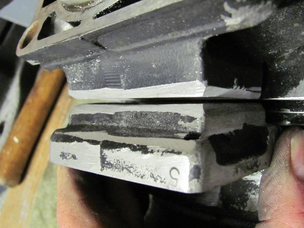

I have been playing with the inlet manifolds and find that the shortening process is not too hard, just need the right equipment. Firstly, find a good barrel that has a near standard bore (then it could be rebored at a later date) and assemble a hacksaw with 18tpi blade, large coarse (bastard cut in english - that's its name) file and a medium smooth file. Objective is to take out approx 12 mm of inlet, so mark it out and cut ..by hand as below.
Start sawing here.
Start sawing here.

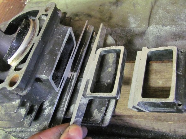

Finish cutting with these 3 pieces.
Discard centre piece.

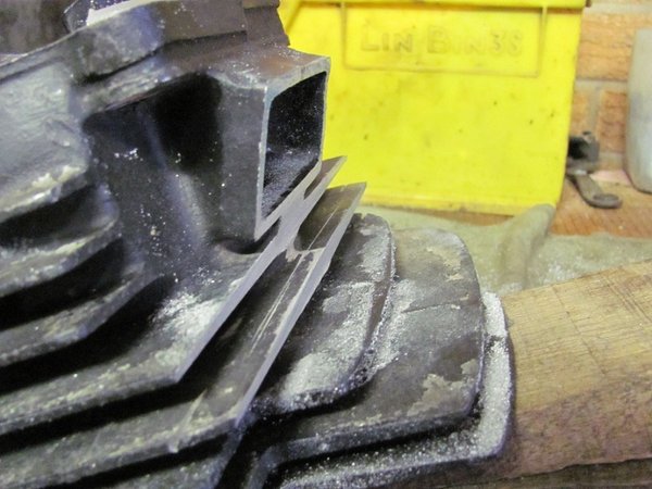

File weld prep onto edges as shown
The welder needs to be skilled obviously .... the top of inlet is welded from the inside, the other 3 sides are welded from outside. So long as it has plenty of prep (chamfer) then the joints will fill-in nicely and the whole inlet must be sealed with no gaps. Just make sure your welder is sober and good at his craft.
