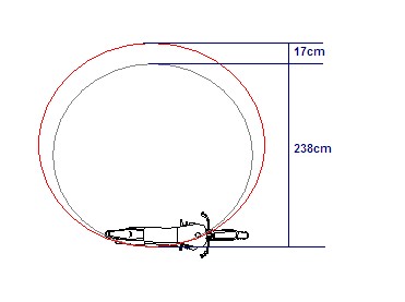

I performed a "turning circle test" today.
No idea if there's a standard.
What I did was a full-lock turn on flat ground, with and without the stopper, and measured the difference between the two maximum points reached by the front wheel.
(Check picture for a thousand words description :D )
Difference is 17cm.
I'd like to remove it permanently, but I'm not totally happy about it. Sharp edges from triple clamp hitting frame = :( !!
I'd like something to protect the frame but not as thick as the standard stopper. Will keep looking.

I'd guess that something made of nylon would do the trick. But I don't know what the point of impact on these new GasGas's looks like. So I don't know what shape the nylon should be or how it could be fixed on.
I don't mean to be funny but have you asked the guys on the TC forum?...They would have had their bikes and bit longer than us Aussies so maybe they already have a tried and tested fix.
