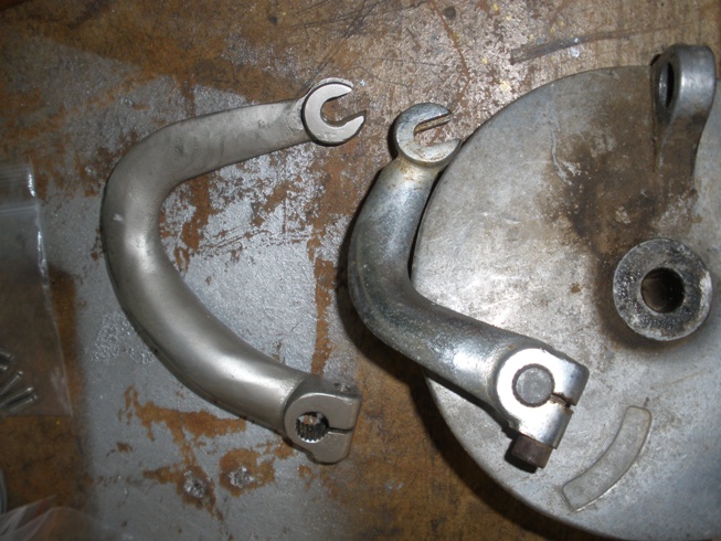

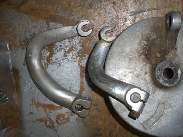

Front brake differences?
Just looking at getting an OEM front brake cable and it looks like there's 2 different style front brake arms for the A and the A2. Mine's an A going by the chassis number, but it has the A2 paint job with the stripes.
Any ideas?
Any ideas?

Re: Front brake differences?
garrison wrote:Just looking at getting an OEM front brake cable and it looks like there's 2 different style front brake arms for the A and the A2. Mine's an A going by the chassis number, but it has the A2 paint job with the stripes.
Any ideas?
Yes there are two different arms. Not certain but I think the standard cable fits both. the difference is in the shape of the arm but the end with the cable nipple hole ends up in the same spot on both. Don't quote me though as my memory is a bit dodgy on this. Scorps went through this only a few months ago and sorted it out. I remember talking with him about it. I think he used a Venhill cable though rather than Kawasaki.

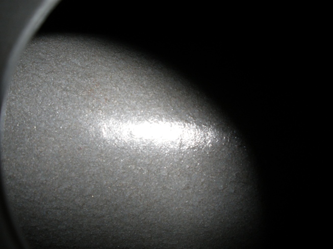

In regards to the tank restoring - you can go with the following kits:
KBS coatings - http://www.kbs-coatings.com.au/KBS-MotorCycle-Tank-Sealer-Kit_p_13.html
POR15 - http://www.ppc.au.com/kits3.htm
I have used the KBS kit and it worked a treat, although I added a few extra steps to get it top notch.
1. Drain tank
2. Give it an initial rinse with hot soapy water - check if the tank has any pinholes. Get these brazed before continuing.
3. Clean using cleaner in kit as per instructions.
4. Go buy some CLR kitchen cleaner, out this in the tank with some small metal screws. Shake this around for a while to hit the heavy rust. Dry thoroughly.
5. Use the derust/primer in the kit as per instructions.
6. Use the sealer as per instructions.
And your good to go. I just bought the POR-15 kit to try on my third bike, but haven't done it yet.

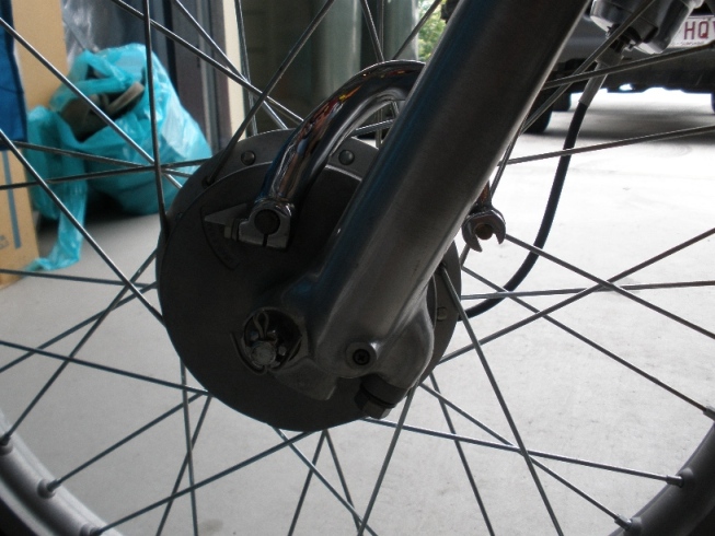

As far as the front brake cables go - there are 2 different arms, to suit 2 different front brake cables. I bought a front Venhill cable and it seems to suit the larger of the arms. The NOS front cable I bought of Ebay also suited the larger arm. Unfortunately the only spares I have is the short arm.
**UPDATE** Just checked my original KT250-A2 workshop manual, and it appears the A2 has the larger brake arm. Also, I just remembered that the front brake plate fits some other Kawasaki (possibly KE125) but can't remember - it is possible that the short arms are from the different bike.

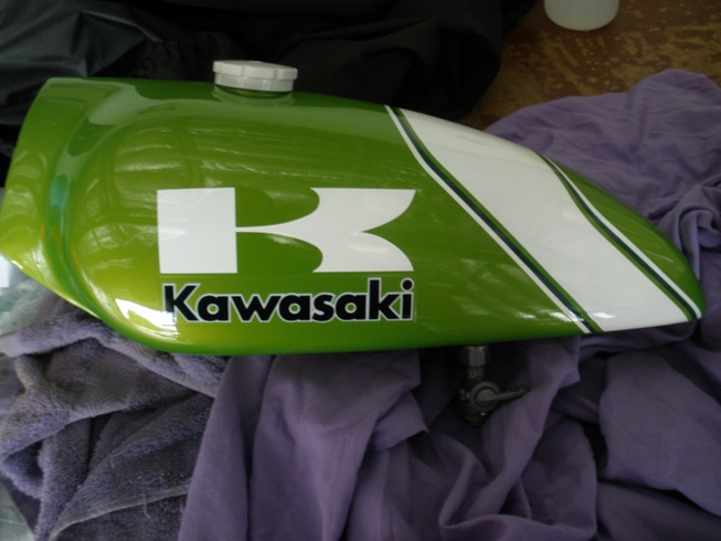

I have attached some pics of various things for your reference.

That different arms pic is exactly what I'm after, Scorps.
