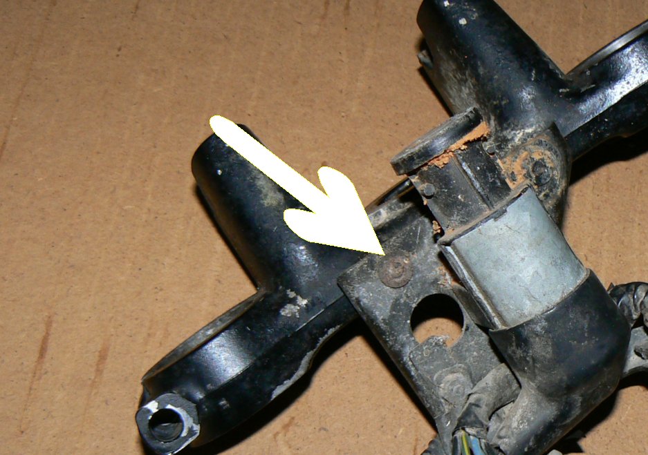

Progress is slow - still waiting on parts - but clean up is progressing well. As I mentioned before I don't intend to refit the lights and so the ignition switch etc is superfluous to my needs however it looks like I need to take a grinder to the top bracket to remove it or can anyone suggest a simple trick that I am missing. The caps arrowed in the image below appear to be bolts threaded into the bracket or do the caps pop off to reveal hex nuts (I did try but nothing gave)
