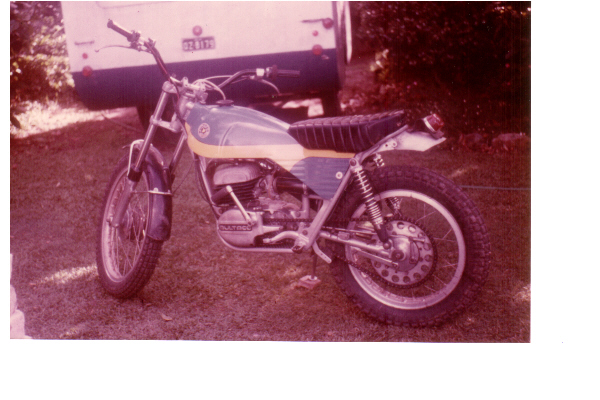

Hey Guy. You were talking about your trialised 350 Alpina. Here is mine in a photo taken in 1975. Mine was the first model 325 Alpina fitted with a big rear sprocket and trials tyres.
Hagsta, you can see those black Inter-Am solid alloy bars in this photo - that's why yours are going on my current Alpina.

Oh God, I don't like to see that picture : low front fender, trial bars, and big sprocket. Where you set up with an 11 tooth front sprocket ( out of a 1972 125cc Pursang ) ? It was a lot of fun to ride. Mine was serial # 116000295 imagine I still remember that number by heart !!! Would you beleve I went to buy tire at Motosport GL in Bedford ( Quebec ) and the frame of that Alpina was lying in the back yard.
Guy
