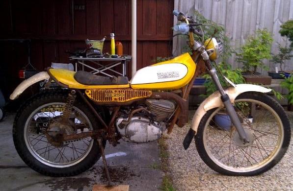

Attached is a pic of the second bike after a tonne of cleaning, and prior to stripping. She's now fully stripped. The frame / swingarm have been professionally sandblasted, and I have the frame primed in 2-pack 1 hour after it had been blasted.
Ive ordered frame parts from Sammy Miller and TYTrials, so this thing is under way! (stupid thing is that this was meant to be my "parts" bike for the other one!!)
Anyway, just thought I'd ask on here before I head over to the "wanted" section..
Questions:
-Can you buy a replacement flywheel cover for these bikes whether OEM or aftermarket? (missing the original magnesium type cover)
-Failing that, does anyone have one lying around they'd concider selling that isnt cracked anywhere?
-Anyone have a rear brake brace arm lying around in very good condition they'd concider selling?
-Does anyone know if "Forks by Frank" in the USA has an email address? All my research can only reveal a phone number...
The info I have received from this thread, as well as this forum have been a massive help, so once again thank-you!
Questions:

Re: TY250C resto questions
horde wrote:Attached is a pic of the second bike after a tonne of cleaning, and prior to stripping. She's now fully stripped. The frame / swingarm have been professionally sandblasted, and I have the frame primed in 2-pack 1 hour after it had been blasted.
Questions:
Yes there are new covers available made in Europe from composite materials but are quite expensive. I haven't remembered who the supplier is yet. The A model cover will also fit if you are looking for second hand. The flat sided magnesium covers ones are much harder to find in undamaged condition due to corrosion and being much more fragile.
It is easy to make a replica of the rear brake brace from standard size aluminium flat bar.
No idea who Forks by Frank are. There are hard chromers who do bike fork tubes in Australia (RAD Hard Chroming in Brisbane is one) and plenty of bike suspension specialists too
