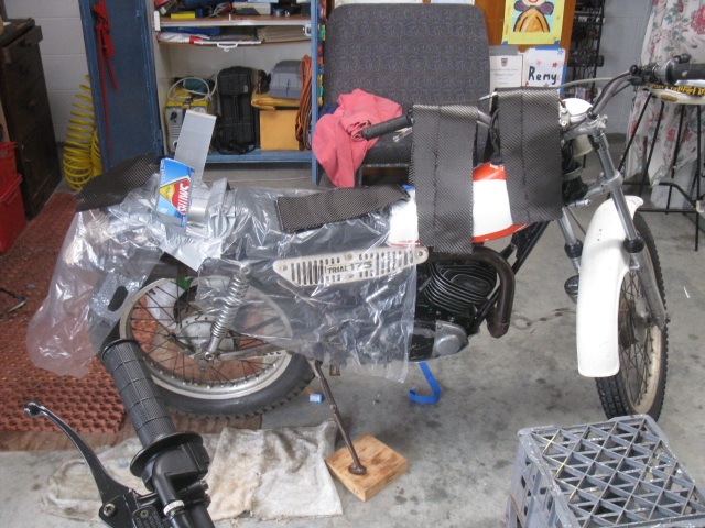

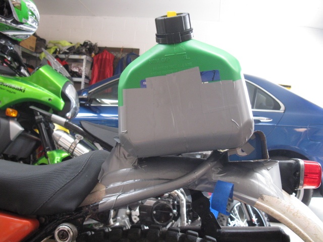

I have a picture of a mate and I going for a ride in the mountains.
I need a long range tank
I just made a seat base and I was pleased with myself
How hard can it be. A strip of carbon fibber and some resin

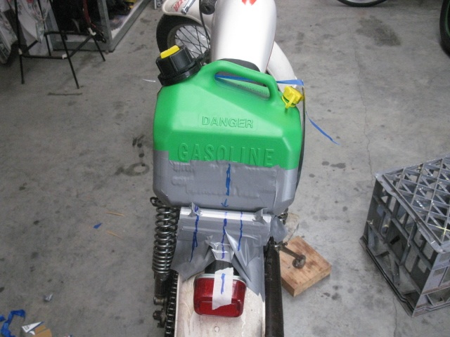

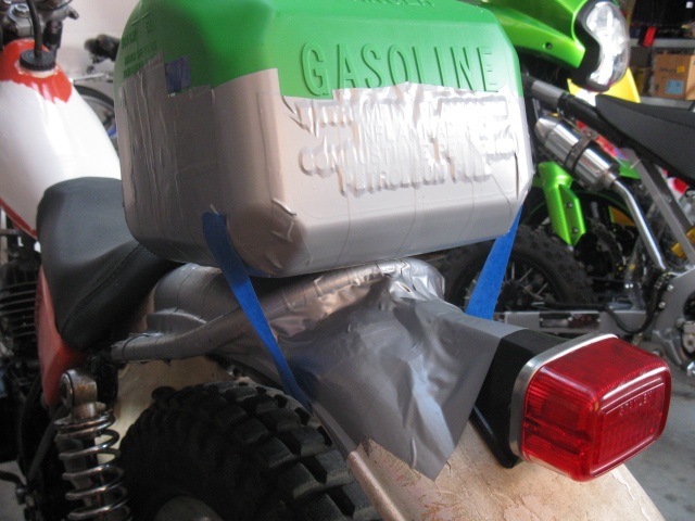

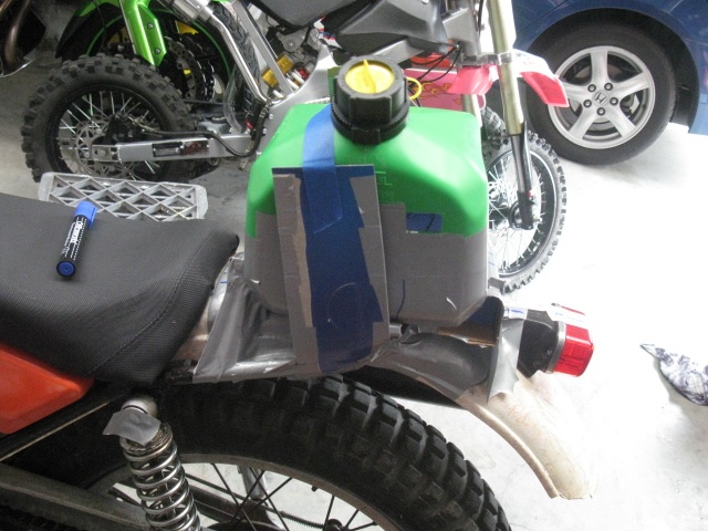

Plan 1 hold a square plastic petrol container onto the back of the bike
Make it light strong and hold the tank down. Look like a F1 front wing

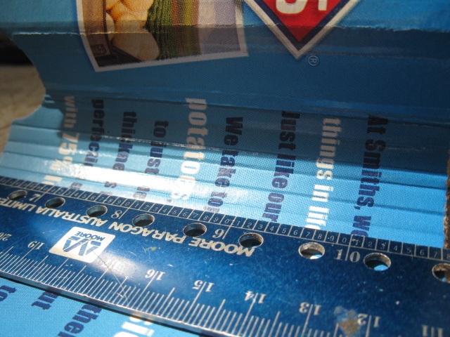

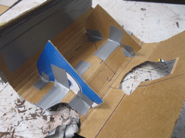

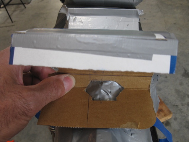

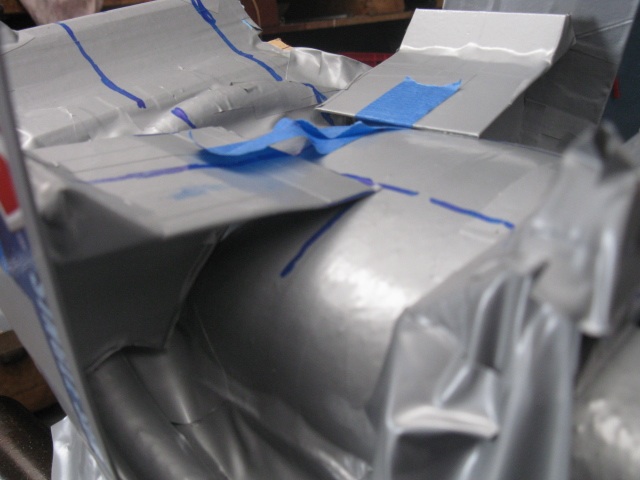

Thin cardboard easy and can collapse later

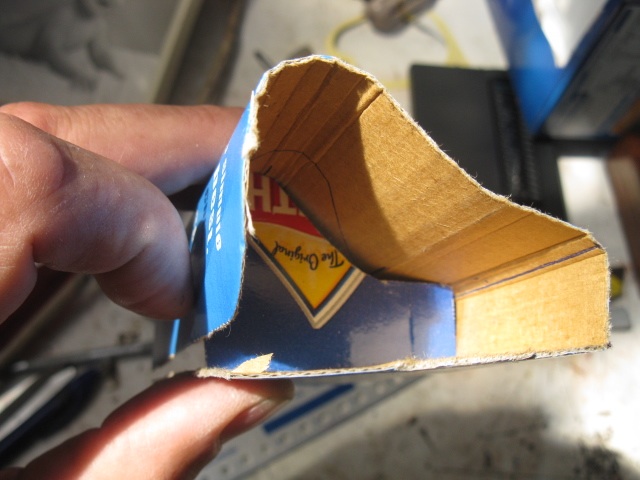

10
10

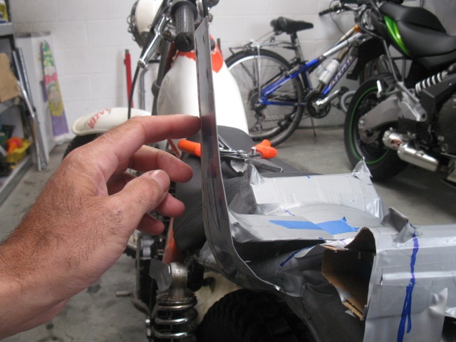

That bend is to sharp and I don't know if the carbon fibre will bend at that angle?

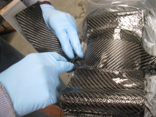

I made this up as I went, seems to be working
Had to invent how to use
Crack the cardboard for a bend

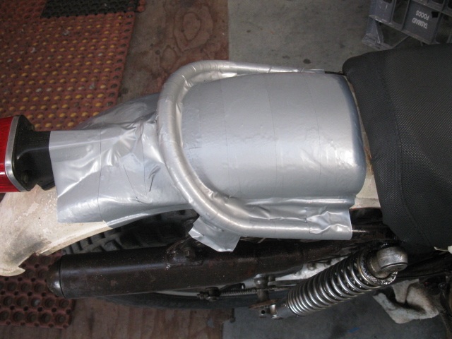

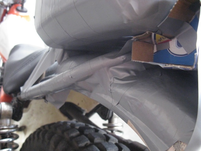

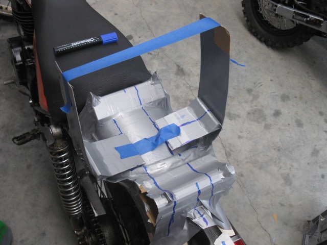

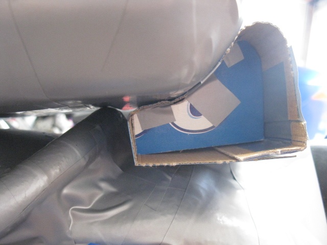

24 remade front one again<br />Did not like the sharp bend on the front one so made a new one with what I learned from shaping the back one
25
25
26
26

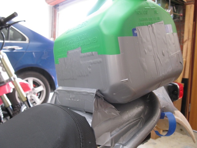

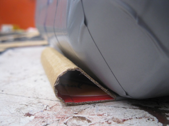

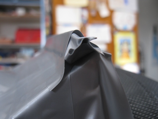

At this point I was only going to strap it down front and back with ocky straps and only have a small side support. The tips are for making a bit of shape for the straps so it won't Frey the cord.
Tips
Tips

I have a ideas of making loop with the sides. I will see how it developers

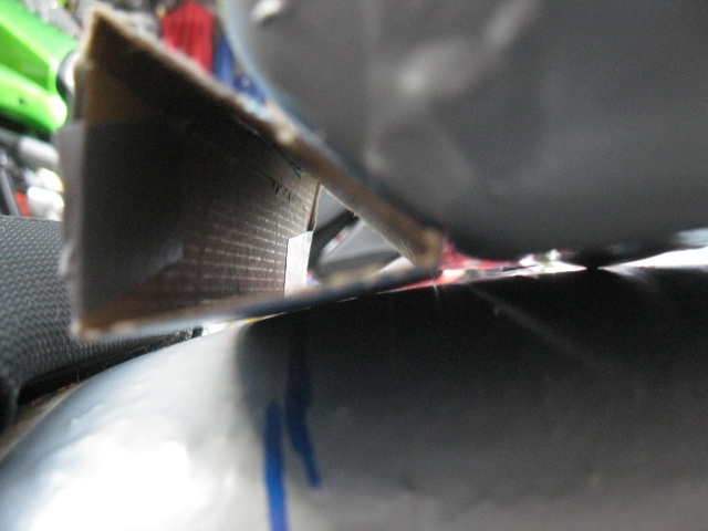

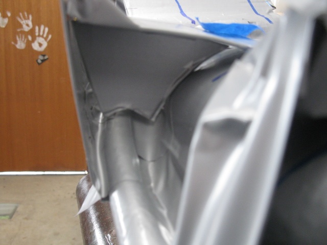

Internal support
Internal support

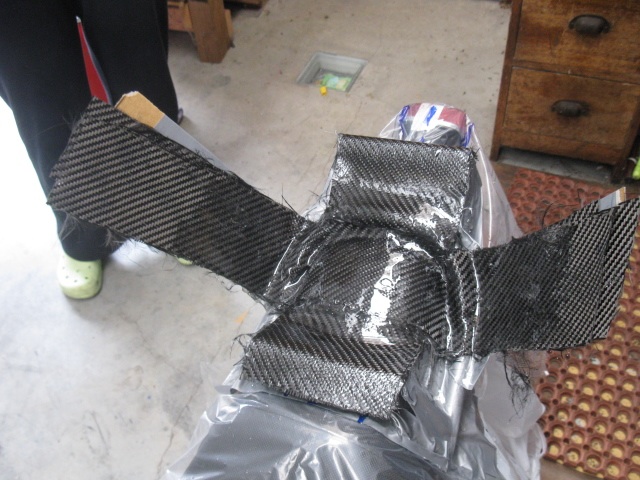

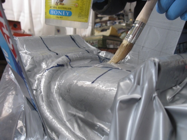

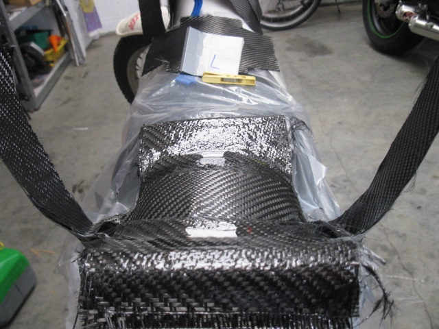

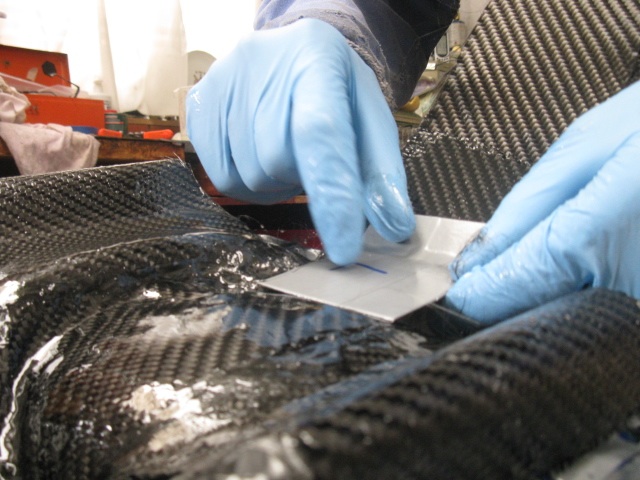

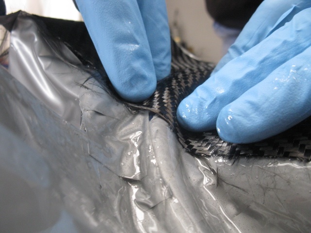

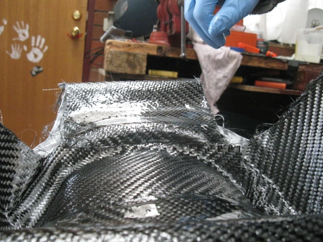

!!!spray with silicon !! I did this with the seat but forgot this time which is going to cause problems later light cote of resin
1
1

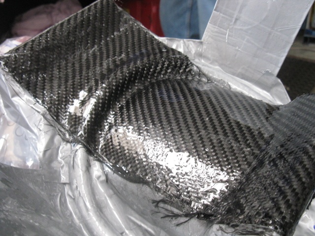

Pres into shape
Pres into shape
3
3
4
4

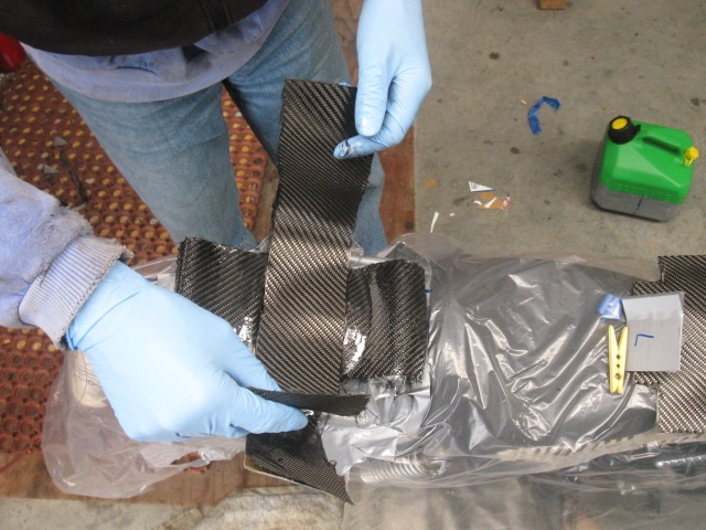

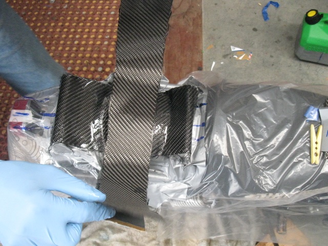

Layer, brush, layer , brush for 3 layers
5
5
6
6
Tioli
Posts: 756
Bike: ty175je , KDX/KX ,,,
Location: Tas
Post by Tioli »
4 layers this way as I need it stronger
