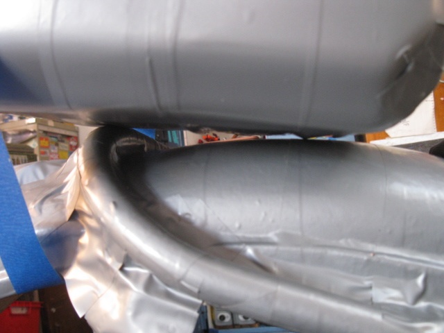

I made this up as I went, seems to be working
Had to invent how to use
Crack the cardboard for a bend
16
16
17
17
18
18

24 remade front one again<br />Did not like the sharp bend on the front one so made a new one with what I learned from shaping the back one
25
25
26
26
At this point I was only going to strap it down front and back with ocky straps and only have a small side support. The tips are for making a bit of shape for the straps so it won't Frey the cord.
Tips
Tips
28
28

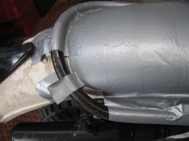

29
29
I have a ideas of making loop with the sides. I will see how it developers
30
30
31
31
32
32
33
33
Internal support
Internal support
35
35
36
36
37
37
38
38
