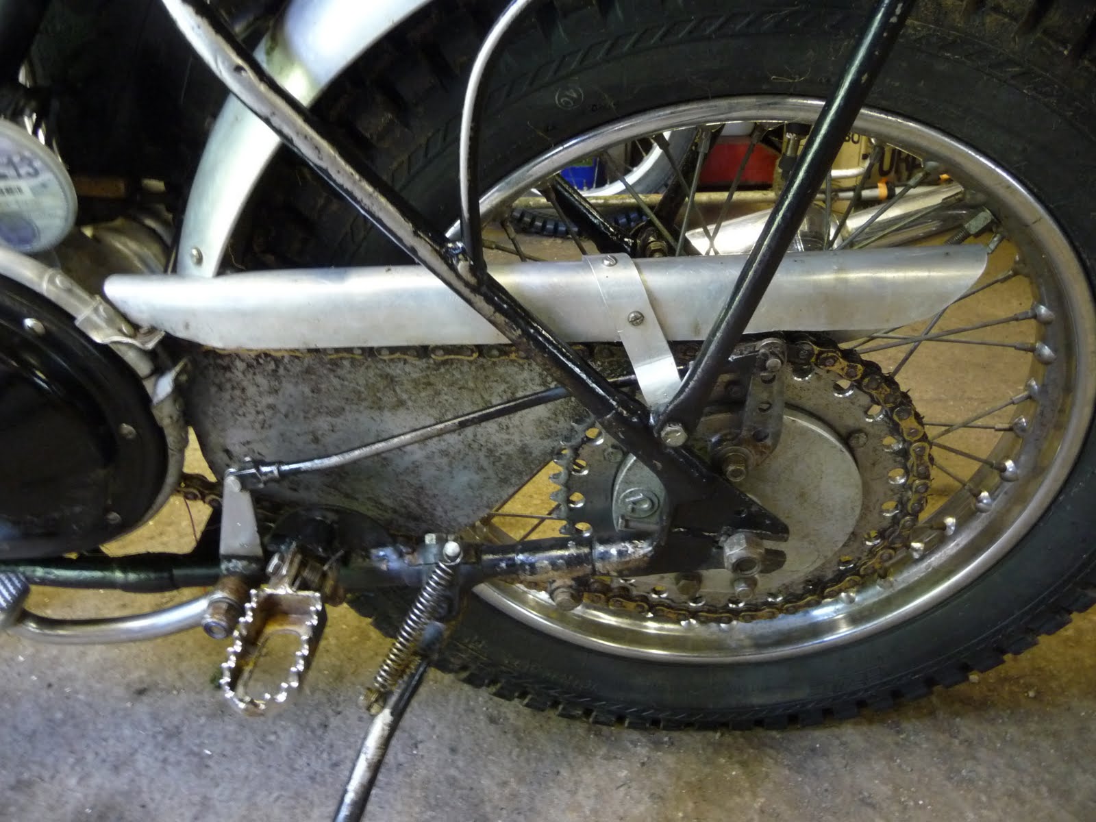

I have a solution for leaking shocks,or for those who dont know which ones to choose - Get rid of them and go rigid !
