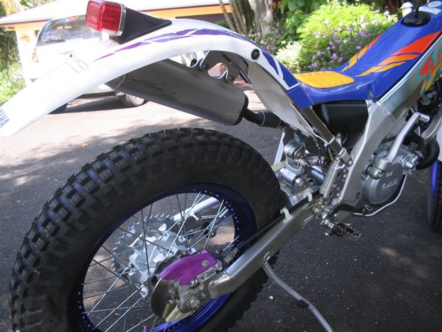

What about those tubeless rear rims that have the central flange as fitted to Yamaha TY250Z? (and the Cota 315R)
Surely they could be used on a drum brake hub by having spoke adjusters somewhere along the spokes length. I think I have seen a bike done that way but can't remember where.
Re: tubeless tyres
Ahhhh I just found a decent photo of a Cota 315R wheel and it is the one with the adjusters halfway along the spokes, but it is 32 spokes. So much for that idea #-o

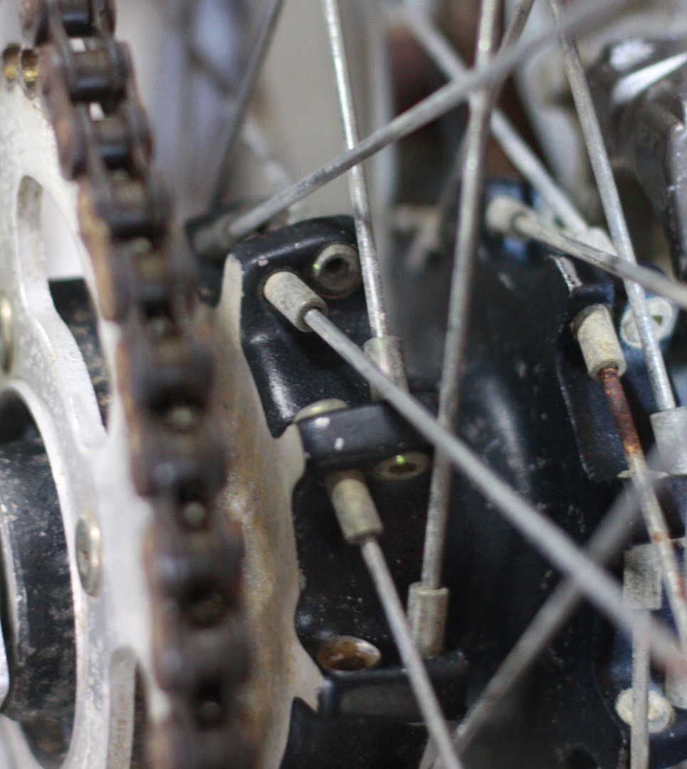

The 88 & 89 Honda RTL 250 uses the flanged rim, thought the hub has been designed to take a much longer and larger diameter spoke nipple.
If you are going to fit a raised flange type rim to a twinshock I think you would need to use a turn-buckle type spoke.
