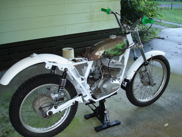

Post by straightpipe »
hi, progress slow while i wait for steering bearings. Really like the white frame :D . also white inner rear mudguard is a replacement as the old one was rotted through in several places. Black footpegs stand out. In the background the mudguards are in a sorry state (front one cracked and poorly repaired, both very discoloured, rear guard with lots of black paint overspray). Need to source replacements ???. Cheers Ross
Re: KT250 project
Gonelli guards fit OK with a bit of thought but the Fred and Deb replica KT guards look much better in my opinion. Not sure about white guards on your bike though?

Re: KT250 project
Hi, thanks for the reply David. Last time i spoke to fred (Email) he said the guy who had done his fibreglassing (side covers and mudguards) for the last 20 years had retired and he was still looking for a replacement. Good news, steering head bearings have arrived but are 16.5mm thick instead of 16mm. Oh well just have to press them in and see what happens. Cheers Ross
Re: KT250 project
I just bought new front and rear guards from Fred and they smelled pretty fresh so maybe Fred found a new builder. Fred also has a new batch of carby to airbox hoses

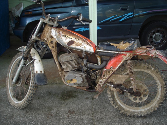

Mike
straightpipe
Posts: 28
Joined: Sun Nov 11, 2012 6:18 pm
Bike: TLR200, KT250
Re: KT250 project
Hi , been a bit distracted lately but have exhaust back on bike. Had to find brake cable adjuster (fits into bracket on left hand fork). Seat is away getting redone and hose clamp to air filter is in the mail. Waiting on the side covers to be fabricated, and then start to think about tank/sidecover paint 8) . So what distracted me, my next project ( what a mess =D> ) . More photo's of KT to follow. Cheers Ross
