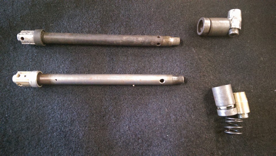

Re: TY250 Fork Improvement
JC1 wrote:When I got my KT going recently, I intended to try this very thing, but first I compared its damper rods to those of a spare set I have from a TY250B. The TY had only two holes (6mm dia ea) whereas the KT had four (ea slightly larger than the TY's if I recall correctly but like a dill I didn't record what dia!).
I measured the holes in the damper rods the other day but am having problems getting photos off my phone so a description will have to do for now. Both TY250 and KT250 have the same holes in the top end of the damper rod where the oil comes out while the forks are being compressed (in the aluminium part above the piston that the spring seats on). They both have four 5.7mm holes in a cross pattern in that aluminium part. That part looks identical on both bikes
The holes in the bottom end of the damper rod where the oil goes in during fork compression are different though. The TY has two 6.3mm holes while the KT has four 5.7mm holes
The TY250 damper rod is slightly longer than the KT damper rod, but the TY rod has an anti-topping spring that reduces the effective travel to about 6mm less than the KT, before the anti-topping spring starts compressing
It sounds like the Yamaha rods I have measured are a bit different in the bottom hole diameter to those that JC1 has measured. I think mine are from a TY250B or TY250A
Just worked out a way to get the photo up here
- damper rods.jpg (141.17 KiB) Viewed 7970 times
