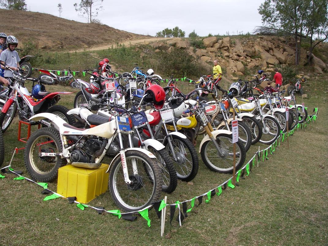

What a great Trial the TY Challenge was again, even more TY`s this year, and a better selection of models! More competition in `C` grade to make Daniel work for the perpetual trophy! Daniel has won it both years and is a very deserving winner with excellent bike skills and determination to be envied!
Below are some photo`s of the machinery in parc ferme and some riding inspired by Naturally Free!

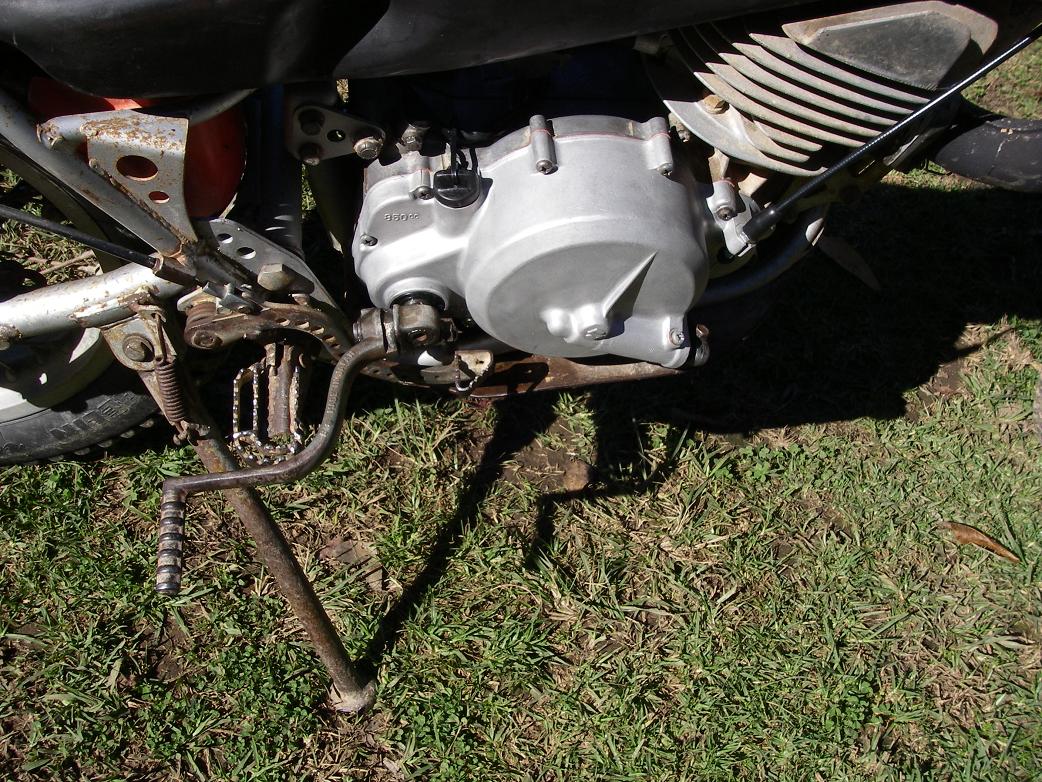

I have decided to give an update on the RL loan bike. One of the things that has been bugging me is how heavy the clutch was, even with a free sliding cable, the drag of the pushrods combined with the ratio made it hard work. The first thing I tried was to file the lever and perch to move the fulcrum which gave some success, but still hard! Next thing, off to the wreckers and bought a later model TS clutch cover and pressure plate which pulls out instead of being pushed from the other side. All beautifully machined and a spline outside the case, so you can mount the lever in the sweet spot.TS185 clutch cables are cheap and about the right length. Another bonus is the kickstart has a needle bearing instead of running in the case. Very impressed with the result as the RL has gone from being the hardest clutch to one of the easiest! Also in the photo, you can see an example of my modified footpegs.

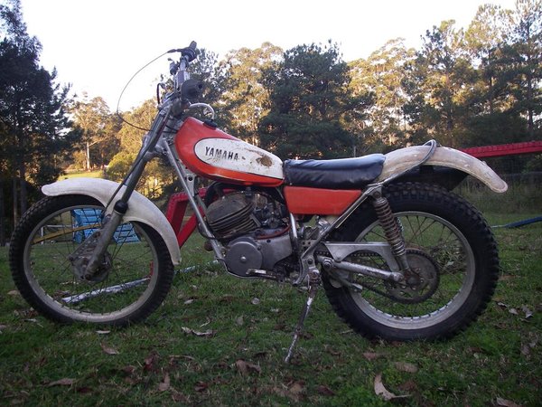

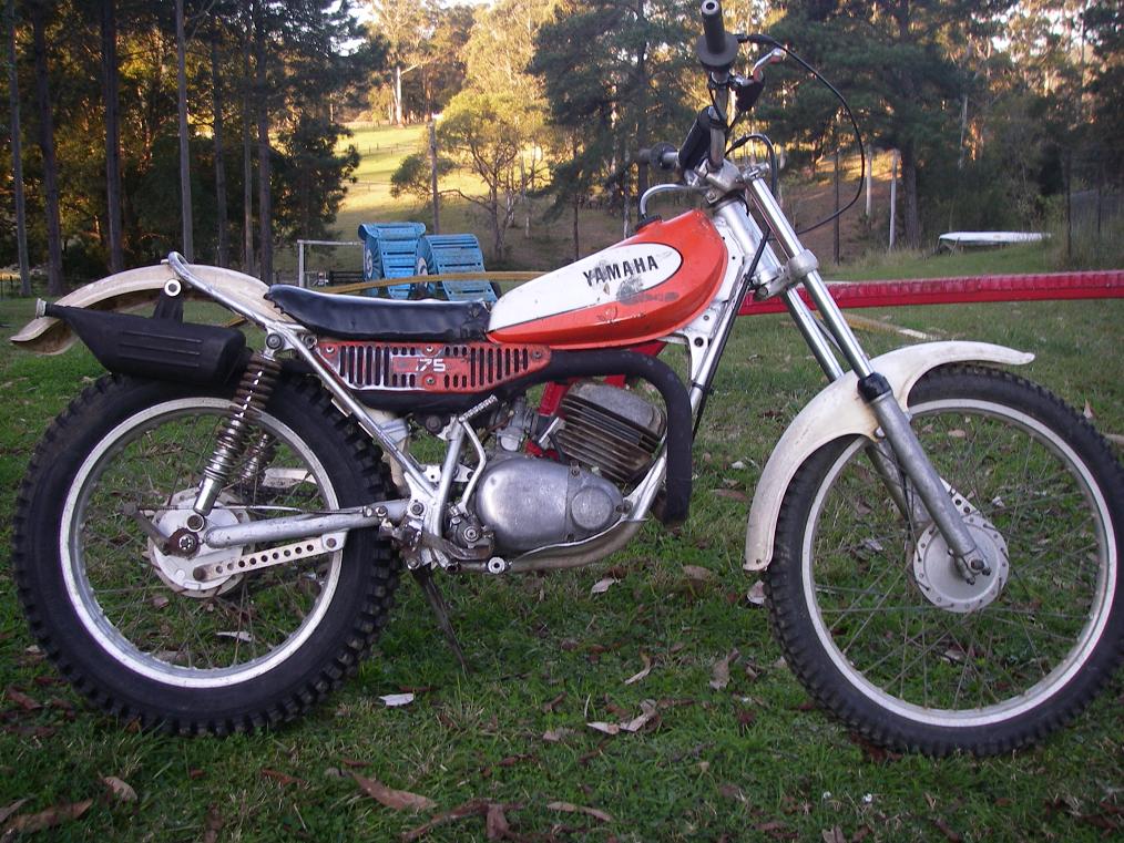

Just sharing some photos of one of my loan bikes that several people have borrowed of all ages. Mitch Jackson has borrowed it to ride Post Classic in the Aussie Titles, hope you have fun and go well Mitch.
