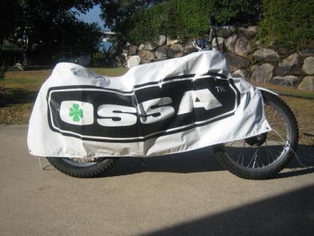

Well I have finished another restoration, the 1975 Ossa MAR 350. It has the more upright rear shocks compared to the 1976 model MAR 350.
I must thank again all that has had some involvement in getting this bike ready.
Tricub, here is another photo for you, but it will be revealed at Conondale Twin shock masters this weekend.
Hopefully I will get time to run it in!!!!

Now if only I had X-ray vision I would be able to see through that cover. Does anyone have a X-ray vision app or software?

Posted: Wed Oct 29, 2014 7:21 pm
by Mark K
It is all a bit of a worry .....
That cover is lumpy in some of the wrong places for anything that I know.
Are you trying to disguise it, or has this strange machine been crossbred with a camel?

Is that a modern OSSA banner or has someone gone to a lot of trouble for this weekend and had one made?

Hi everyone,
No xray apps that I know of Tricub.
Mark, no camels in sight.
David, some people to to great lengths to get custom items for their bikes!!
