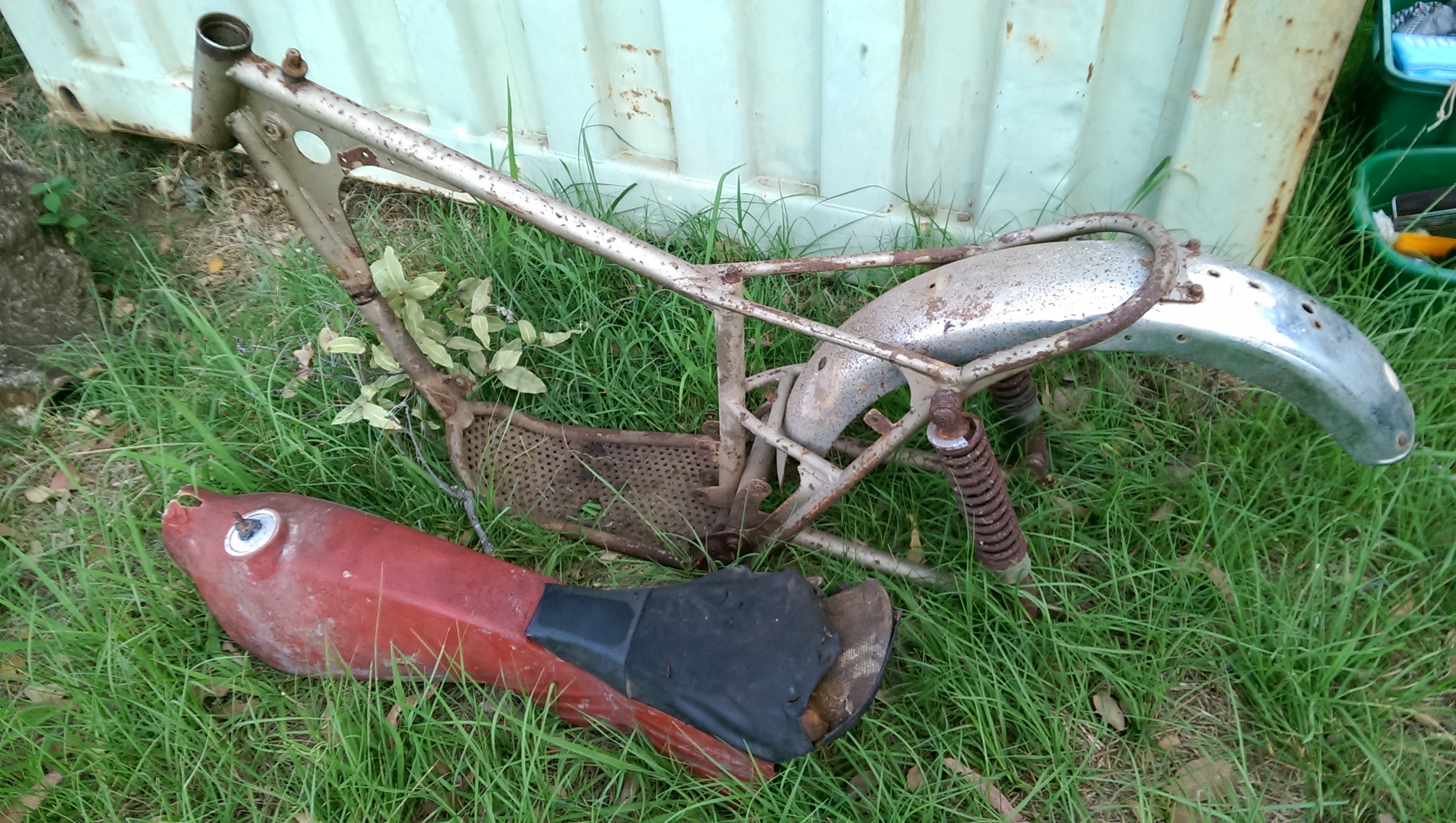

I hope that came with more parts than what's in the photo. There seems to be a few bits missing. Maybe I didn't look close enough, but it seems to be missing a clutch cable. Oh, and everything that goes at either end of that and every other cable.
if you OSSA guys started swapping parts about you might get close to an origional bike.
TriCub
- Posts: 273
- Bike: Triumph
Mark K wrote:I hope that came with more parts than what's in the photo. There seems to be a few bits missing. Maybe I didn't look close enough, but it seems to be missing a clutch cable. Oh, and everything that goes at either end of that and every other cable.
What!!! Can't you see the other parts , they are hidding under the rust and dirt.
He has plenty of Yamaha bits. Maybe he will make a Yamataco or a Bultaha.
