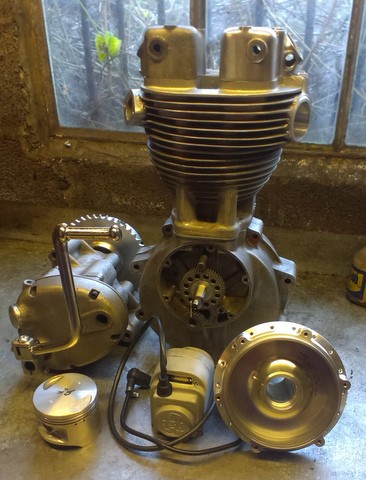

I've recently started a new project,a short stroke 500 Ariel based on a John Bartram frame and swinging arm.Should be so light it will need tying down in strong winds... Alan Whitton is supplying hubs and forks etc,and it will have a Holtworks tank.Mick Ash has supplied a new cam and timing gears,and the Burman gearbox I bought recently has his gears already fitted.Costing a few quid to do,but should be nice when its done.... Hopefully a picture is attached of what I have so far.

Sort of interesting. Is that type of machine classed as a classic or just something with an old engine.
