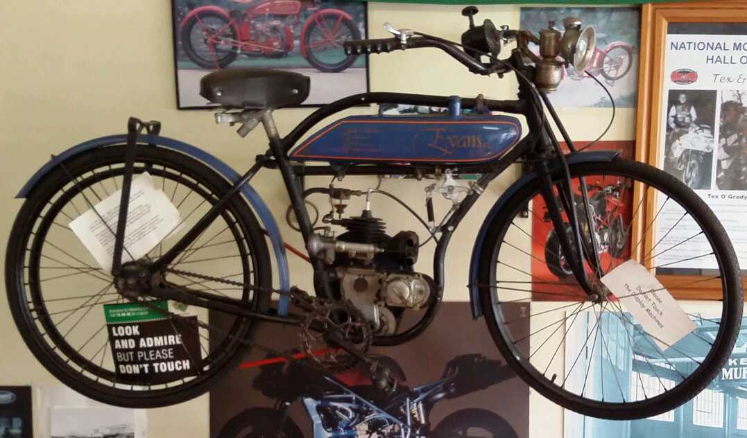

Just sharing a photo of the third bike at Juan's, how things have Progressed!
