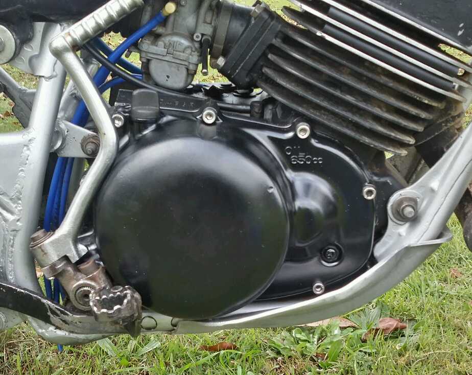

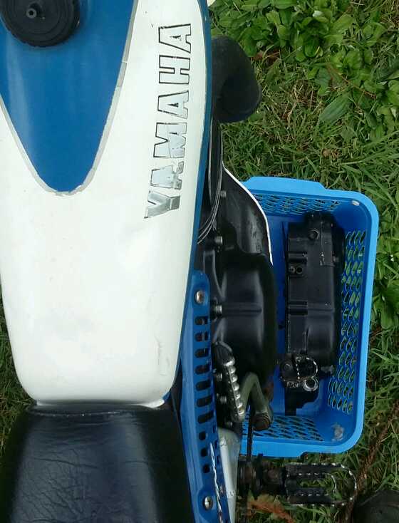

Well the time has come to prepare for the TY Challenge. One modification I have wanted to do for some time is to fit a YZ 125 clutch cover as I like the minimalist slim look
Easy to fit as it bolts up without modification except there is no lug for the brake pedal height stop and 3 off the mounting screws are shorter making them all the same length.
The bashplate protruded so I reworked and trimmed it a little.
Oh yeah, don't tell Chippy!
Very swish Greg. You really do have a thing about using alternate clutch covers. The TY175 motor is spoiled for choice for clutch covers. I'm fairly sure you can even fit a DT175ABCD clutch cover on them and display the manufacturer's name in bold, negative relief - but with that tacho drive at the front end, and the oil pump cover bulging just as much as the TY175 cover, it is probably the opposite of the sleek minimalist YZ125 cover

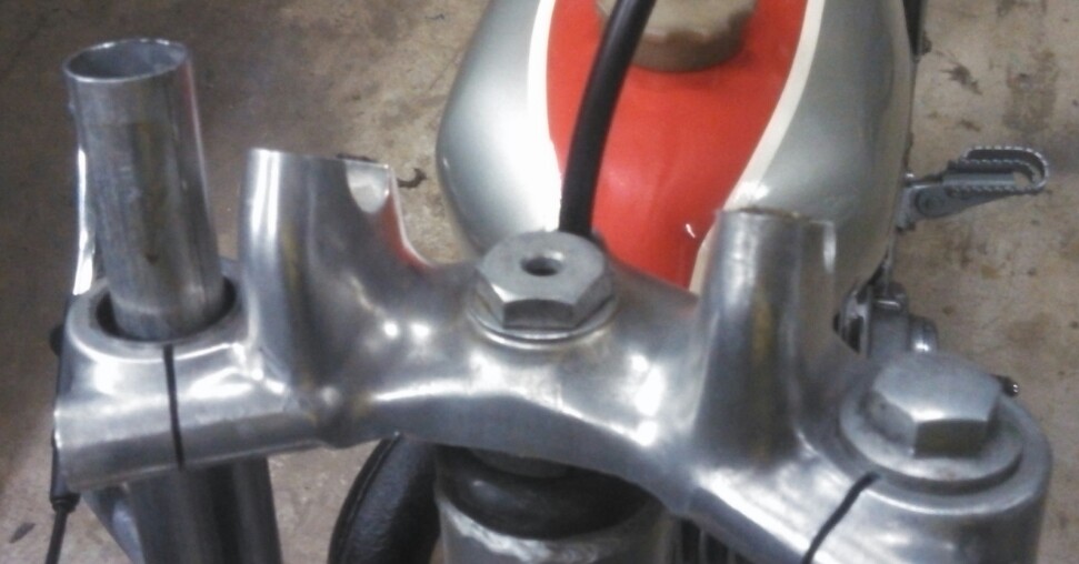

Bearing in mind i've never ridden a trials bike before, i love this bike. The engine is fantastic, you can tell it has the extra flywheel weight as it just rolls over obstacles on idle. It seems to turn nicely, the steering head mods and chopping a little off the lock stops on the frame allows a pretty tight turn.

This is peak trials season so there are plenty of trials being run. Am I remembering right that you live in Brisbane? The TY challenge near Brisbane on 26 July would allow some feedback from suitable riders and there will be at least one (Greg Harding) who is very familiar with riding RLs. I would love to test ride it and will be there too. Have you softened the forks since CD11?

David Lahey wrote:Hi Have you softened the forks since CD11?
Ummm...yes....may have had a tad too much preload? :D
I blame my mx background

Haha good one. I'm amazed you could get the caps on. About 25 to 30mm preload is usually about right for twinshock era trials forks

Yeah, don't know what I was thinking there. Pulled apart the donor forks and used the shorter spacers they came with. Lightened up the oil while i was at it.

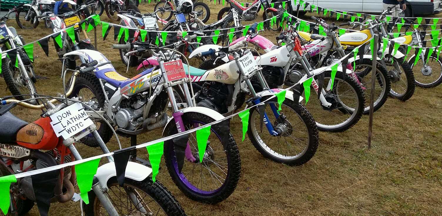

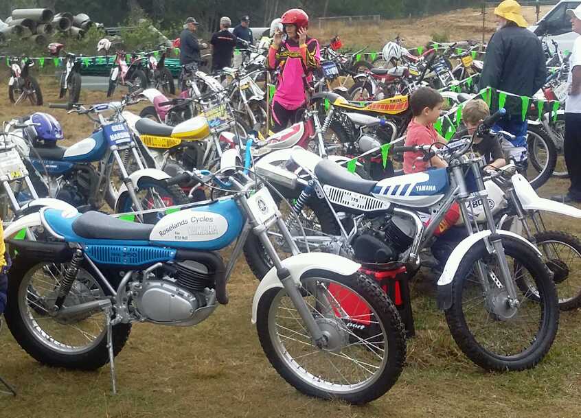

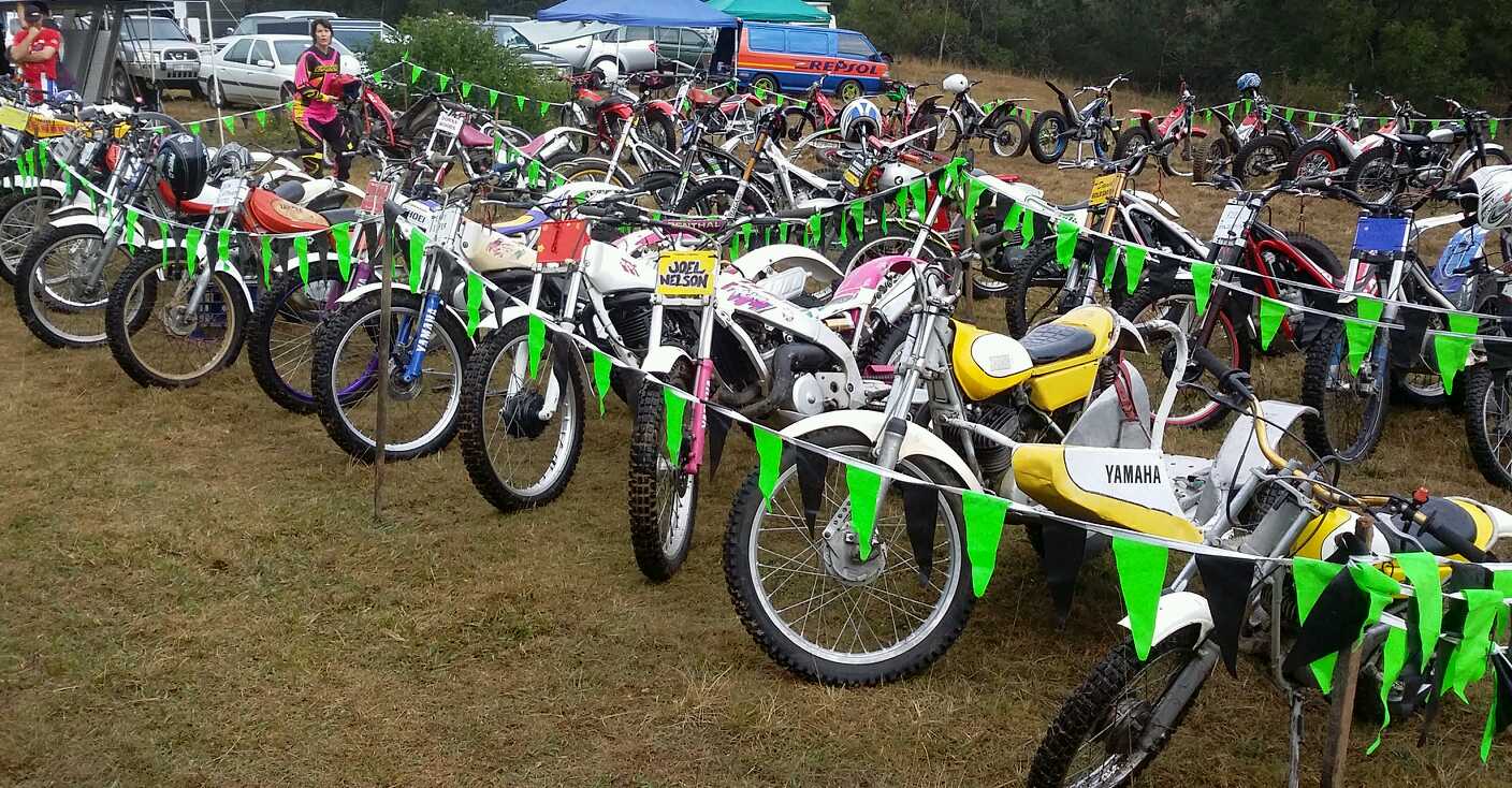

What a great Trial!
How good is it to see so many old bikes being ridden?
Only snapped a couple of photos as I had a few parts to hand out and collect:
Plastic tank for JC1
KT back wheel & :montesa tank for Chippy to seal.
RL engine mounts for David.
