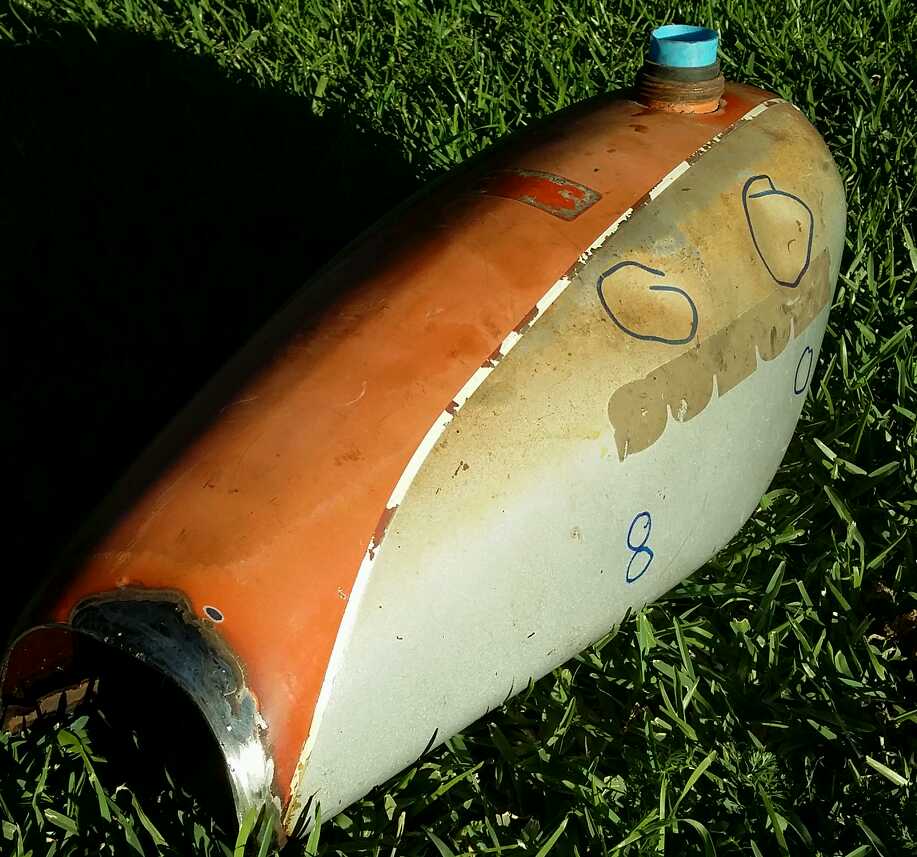

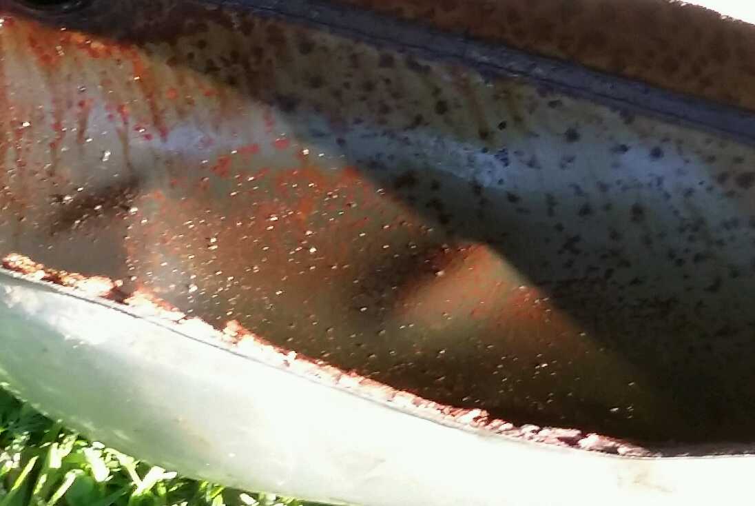

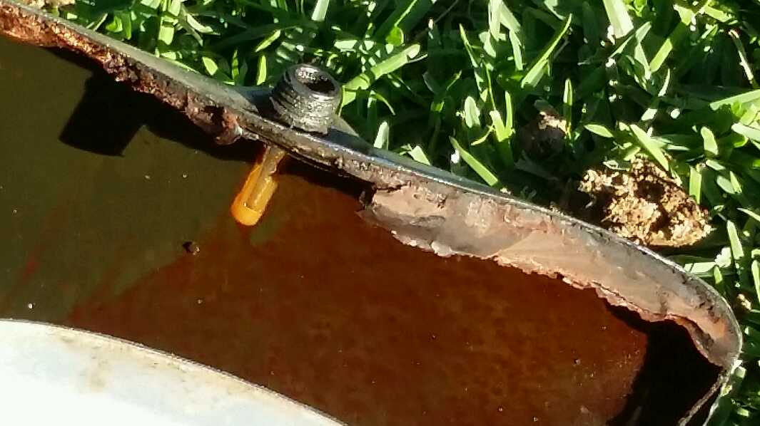

Chippy, Thankyou for the Collars! There is not much of a weight saving, every time I put on weight, the bike has to take one for the Team!
In the last lot of :suzuki RL parts I bought, there was a butchered tank with a lot of mig welding, 1 run of weld would have fixed it, if only they removed the paint.
I decided to separate the top and bottom after grinding the excess weld off.
This proved a little difficult due to the excess stale fuel.
Then off to my mate Jim to beat out the dints.
Final inspection before going back to Jim for Paint!
Nice repair work Greg and good to see another tank resurrection in progress. There has been quite a bit of tank repair dialog on the OZVMX forums recently too including some quite bizarre techniques for dent removal discussed, including freezing water in the tank. Apart from the craziness aspect, the ice method would never work at our place because the freezer is always chokka-block full
That rubbery-looking stuff that was in the bottom of the RL tank looks like the same stuff that had come loose inside Darcy's TY80 tank and took ages to get it all out using a hooked piece of wire. Why it was in there I don't know because the tank didn't leak after I took the rubber stuff out.

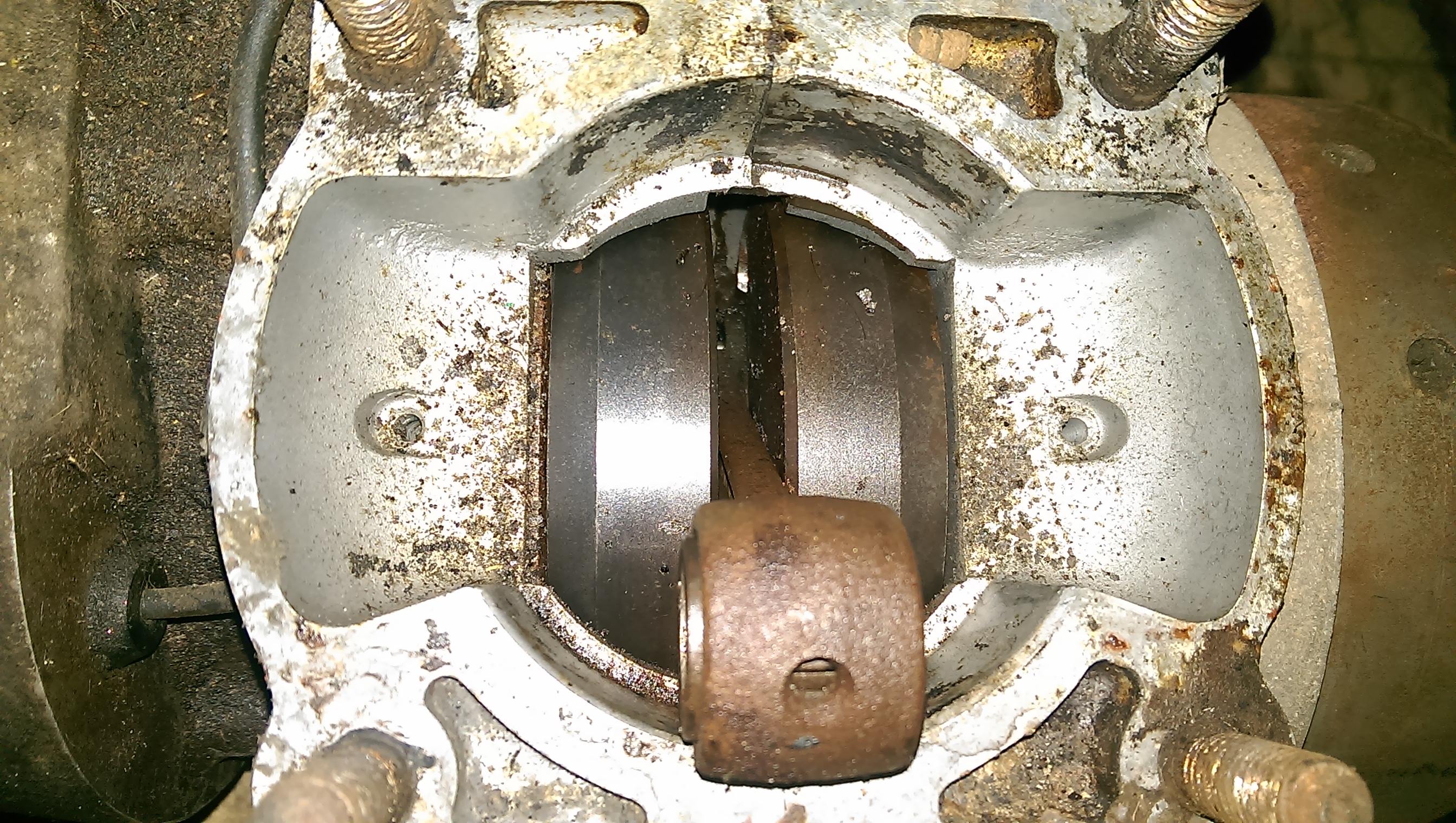

I'm currently rebuilding a :suzuki RL250 motor and will be posting what I think are things of interest as it goes along. If anyone has done one of these and has any hints please add them. So far I have noticed a few things different to other 1970s Japanese trials motors.
This is a photo showing a puller (or maybe a pusher) set up to push the crankcase halves apart. There is a piece of 6mm steel plate in there because the threaded puller holes in the crankcase half are not 120 degrees apart, so the "universal" puller part wouldn't fit. All three holes are on a 100mm PCD.
When I first checked the RL250 motor out, I noticed it had a badly failed magneto side main bearing. The RL motor is very similar to the Suzuki TS250 trailbike and TM250 MX bike motors of the same era, but while they have those amazing Suzuki CCI oil injection system, the RL250 does not and runs on premix. The CCI system supplies oil to the magneto side main bearing (and the big end bearing), and to the induction tract. Most other two stroke oil injection systems only go to the inlet tract. This had me wondering if the cause of the failed RL main bearing was possibly due to shortcomings in how Suzuki had adapted the RL250 motor to running on premix. As part of this I looked at what Yamaha and Kawasaki did in their trials motors to lubricate that bearing. In the photos you will see the ventilation holes in the three different motors. The idea of these holes is to provide a path for fuel mist to travel through the hole and through the bearing, with the intention of keeping it a bit cooler and more lubricated than otherwise. Some other bike motors of the 1970s (Bultaco for one) don't have those ventilation holes, and tend to suffer from main bearing failures much sooner than the motors with the bearing ventilation.
Anyway here are photos of TY250, KT250 and RL250 bottom ends to compare what the ventilation holes look like
Notice that the RL motor only has a ventilation hole on the magneto side. The RL250 main bearing on the clutch side is lubricated by gearbox oil, like a modern two stroke, with the seal located on the crankcase side of the bearing
