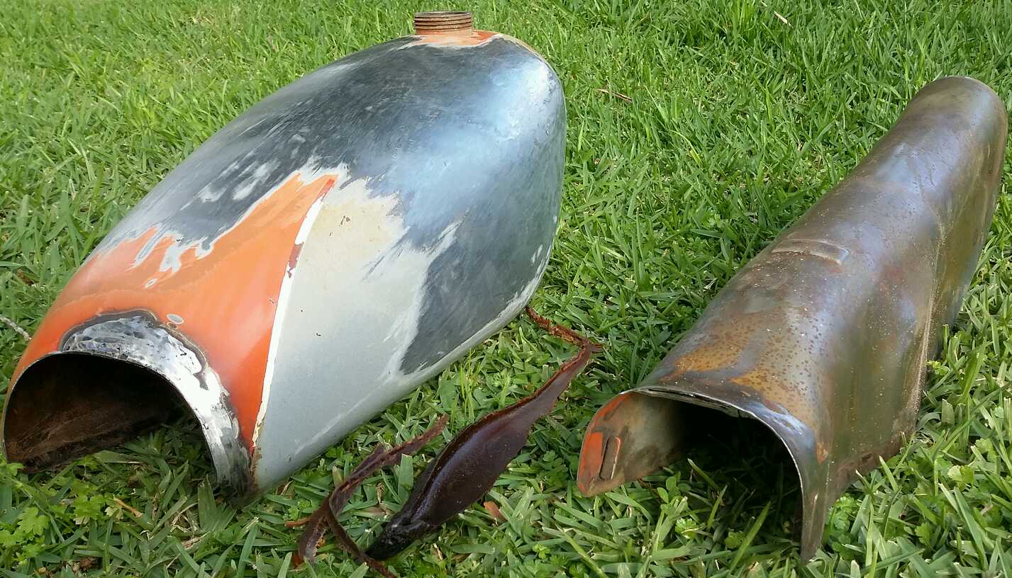

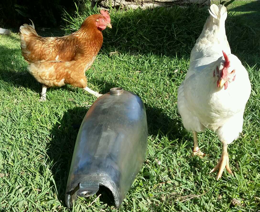

In the last lot of :suzuki RL parts I bought, there was a butchered tank with a lot of mig welding, 1 run of weld would have fixed it, if only they removed the paint.
I decided to separate the top and bottom after grinding the excess weld off.
This proved a little difficult due to the excess stale fuel.
Then off to my mate Jim to beat out the dints.
Final inspection before going back to Jim for Paint!
