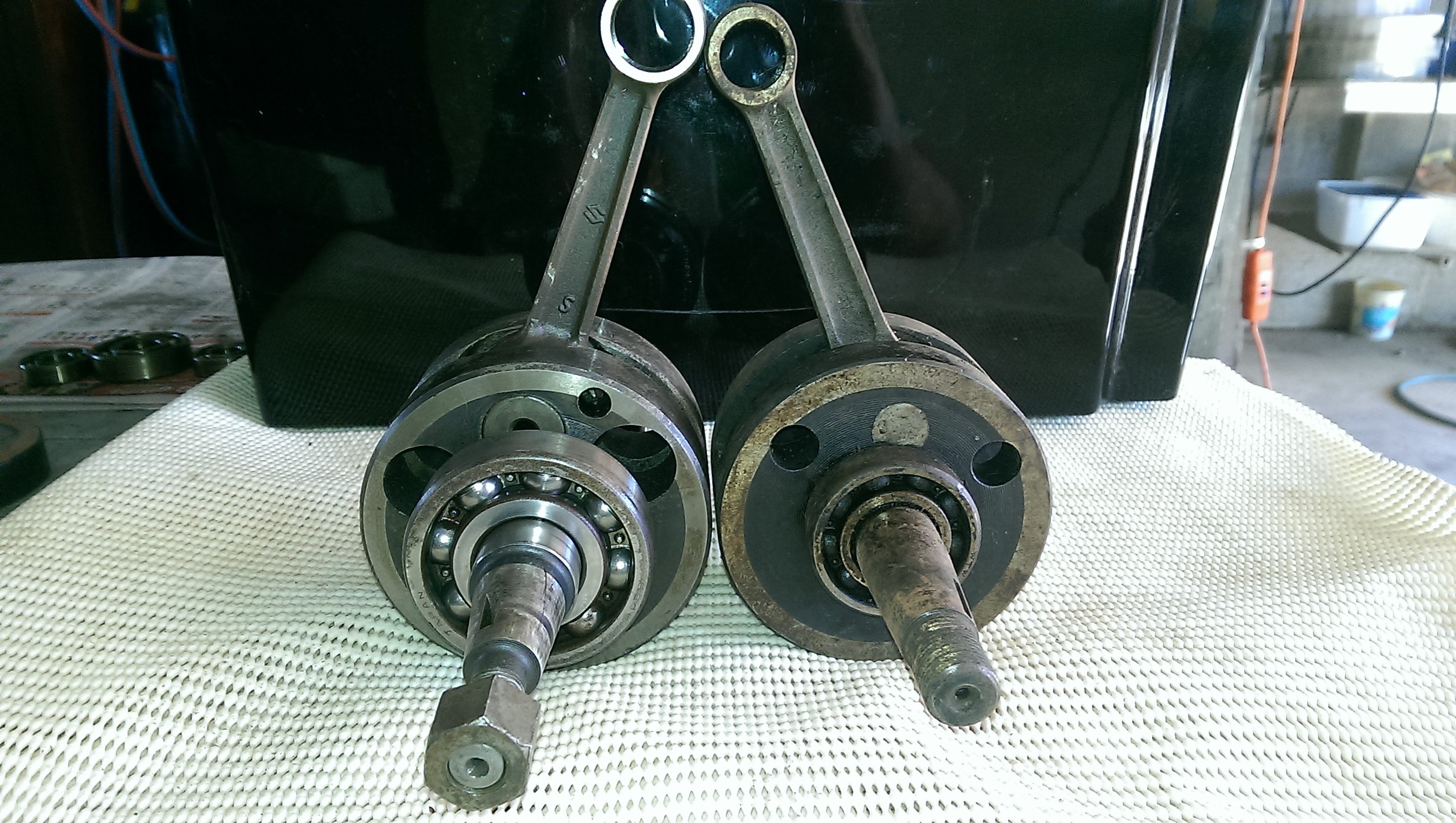

OK I couldn't find any old main bearings from KT250 or TY250 motors, but did find a Bultaco 250 crankshaft with the main bearing still on it for comparison with the RL250 (GOLIATH)

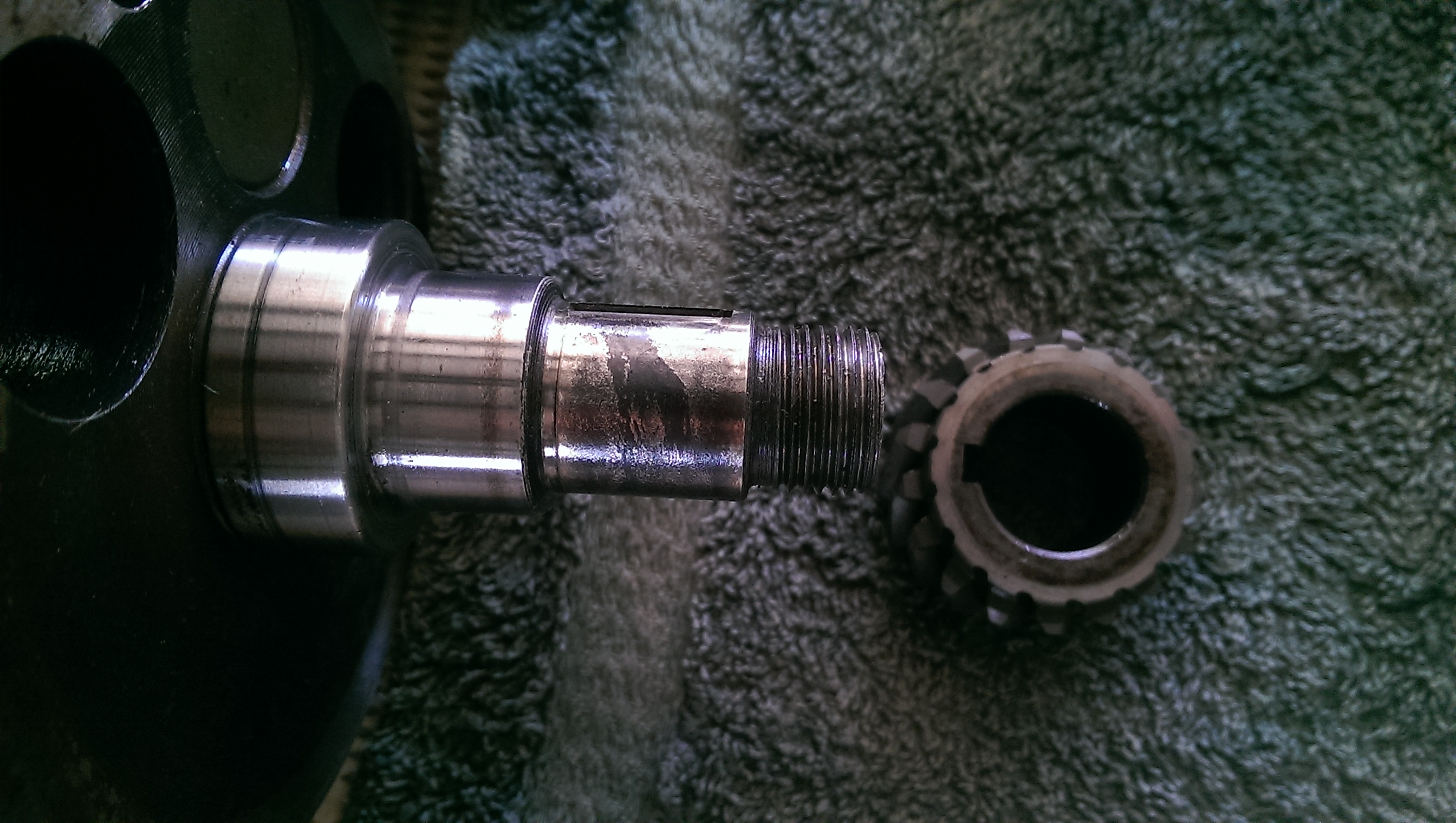

I reckon a fair bit of the engine noise that Greg Harding heard when the Blue Dungar accidentally started was the primary drive gear loose on the end of the crankshaft.
When I pulled the clutch cover off, I found that the nut for the primary drive gear was loose. The tab washer that stops this nut unscrewing was in place, and the tab against the flat of the nut was completely unmarked. This means that either the nut was not tightened fully at the Suzuki factory, or someone in the past had worked on the bike and installed a new tab washer when they reinstalled the nut (not tightened fully).
Either way, the gear which would originally have been a light push fit on the crankshaft, was now a rattle fit, the drive key was very sad and the keyway in the crankshaft was quite battered. Both the gear ID and crankshaft OD have lost metal.
Tricub has repaired this same damage on some RM Suzuki MX bike motors, but motor parts for RL250 Suzukis can be easily and economically sourced. The other crankshaft in the photos will be used in this RL motor after Tricub fits a new conrod.
