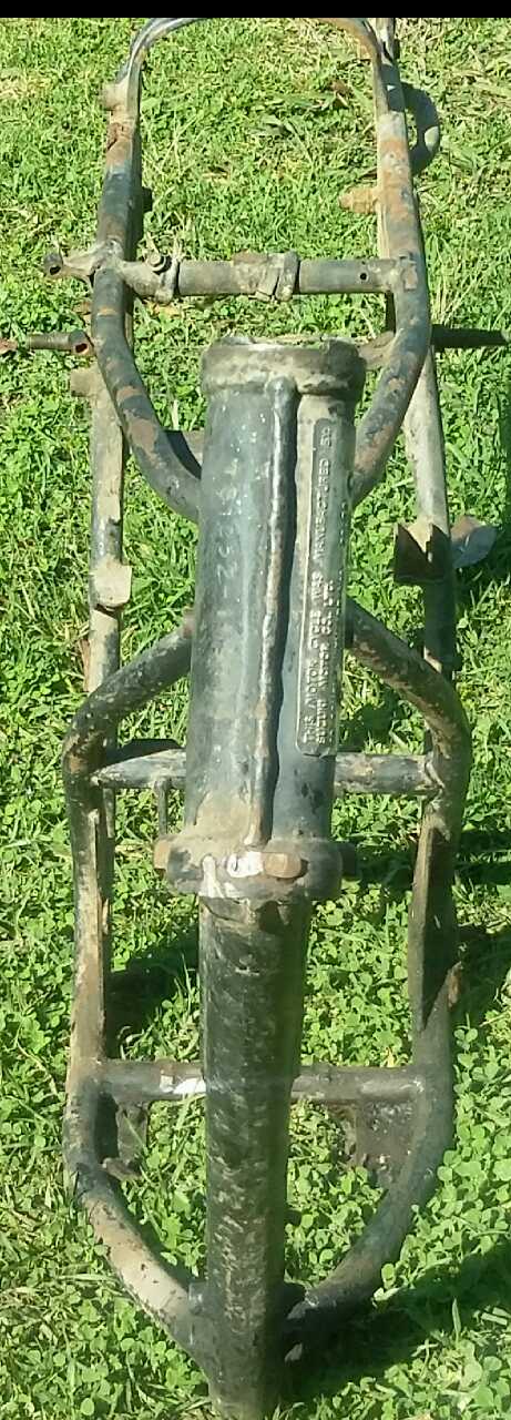

David Lahey wrote:The front downtube has a curve near the bottom. Trouble is that on some other model Bultaco Sherpa T frames there is a deliberate curve higher up in the front downtube, and there are also plenty of Sherpa Ts that have crashed head-on into solid objects, causing curves where there were none previously.
At first I tried to imagine how a bend like this could be caused in a crash, because if I could work that out, I would know where else to look for other damage bends, and would also know how to get the frame back to original shape. I couldn't imagine how any crash could do what I was seeing, then remembered that I had just bought another M80, and did a comparison.
I'm now pretty sure it is meant to have that curve in the bottom end of the front tube, but would be happy to hear comments from people who can contradict or support this. The top frame tube is straight and the rest of the front downtube is straight. The front gusset is completely flat

I thought of that, and compared the series 1 M49 frame. The series 1 M49 front tube is dead straight until below the front engine mount. They really went to town when they made the later series M49 frame, getting it tucked in beautifully close to the engine casings

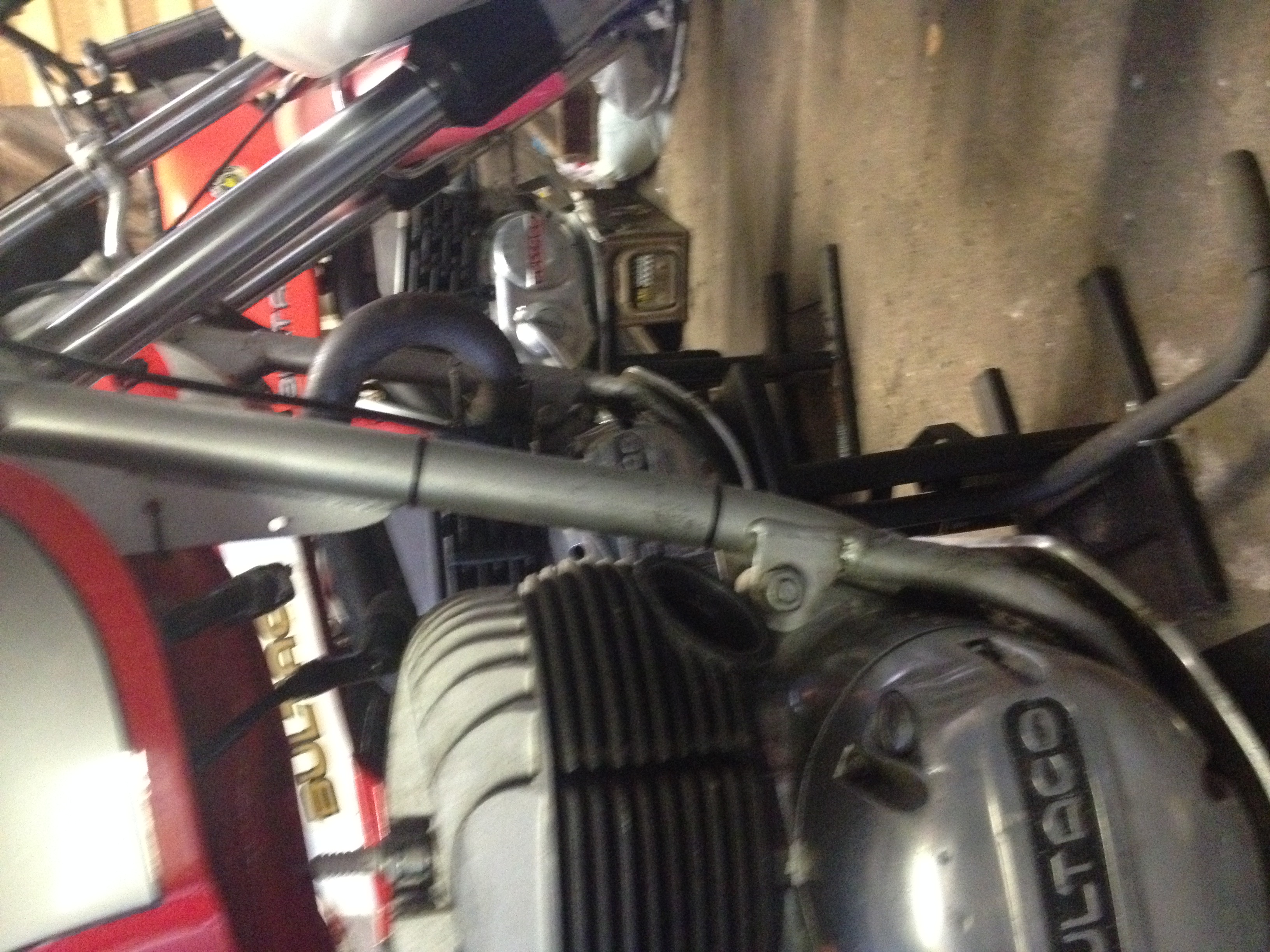

Looking at that photo of my M49 just now, I'm now wondering if the M49 motor will fit into the M80 frame with that old style magneto cover on it. I think the clutch cable mount might interfere with the frame tube

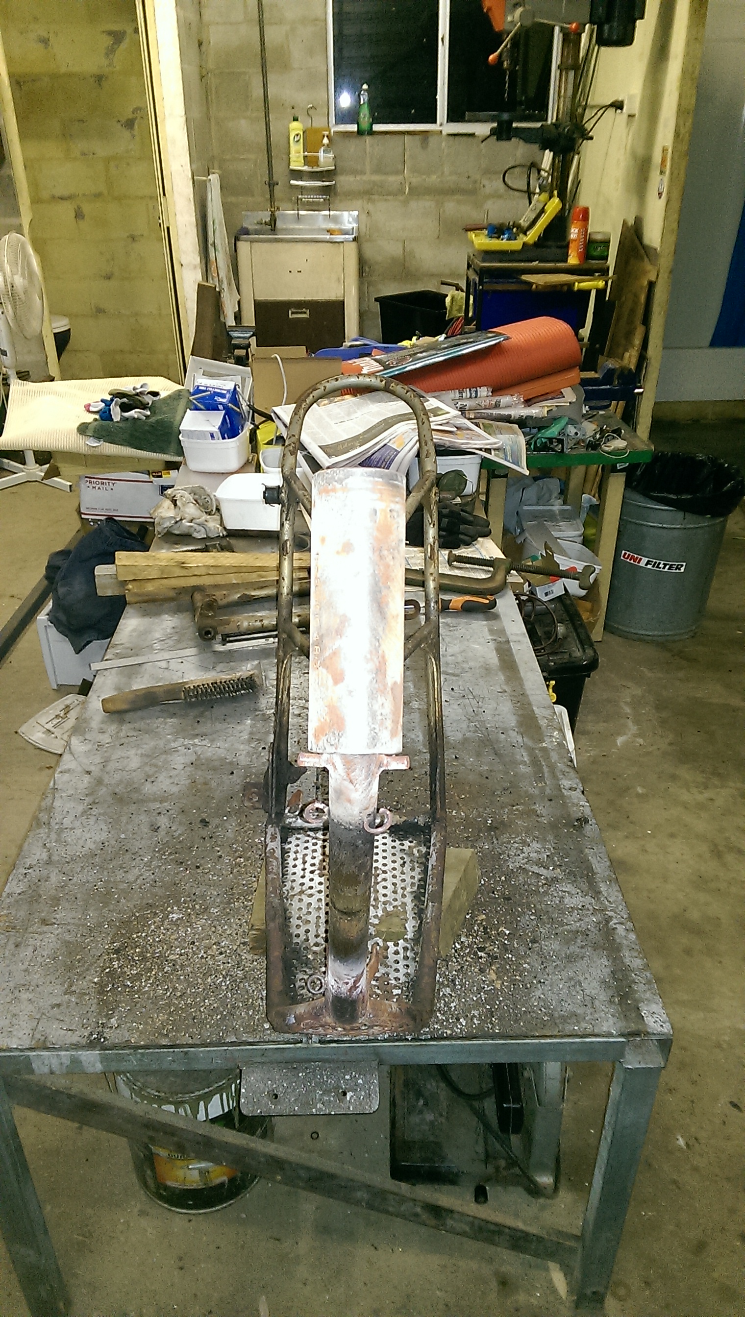

Every now and then, while no-one is looking, I get to escape to my workshop and have a great time. This afternoon's fun involved flames, lots of clamping-down and big levers, and I ended up with a straight Bultaco M80 frame and a fair bit of burned-off paint and gunge

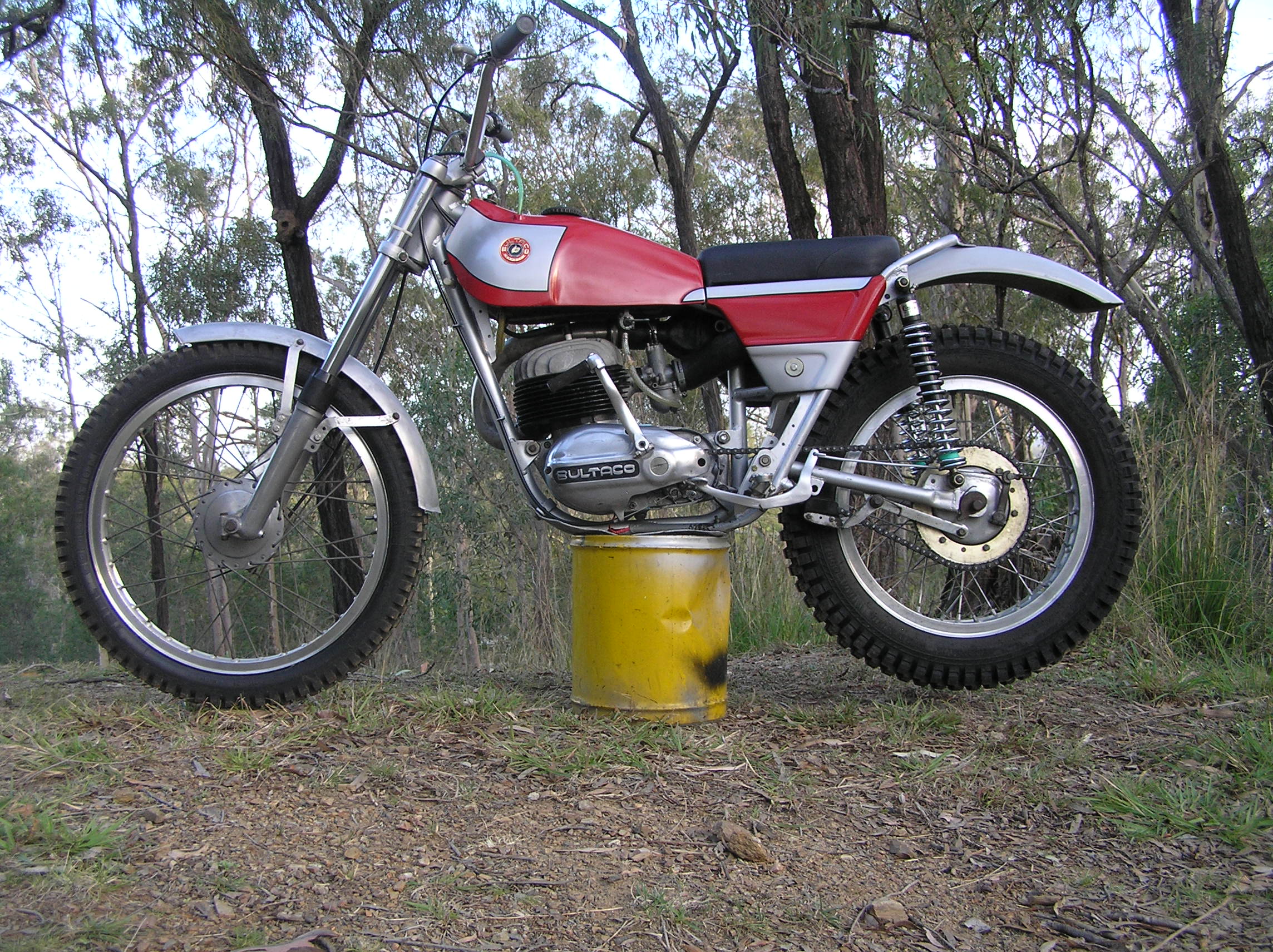

Here are two photos taken by brownie of his beautiful series 3 Bultaco M49, illustrating that the later M49 frames have the same curved front down tube as the M80 frames

Also I checked a couple of Bul frames I have & the M49 (series 3) & M80 have that bend at the bottom of the downtube, but the M91 & 116/138 Alpina frames don't
