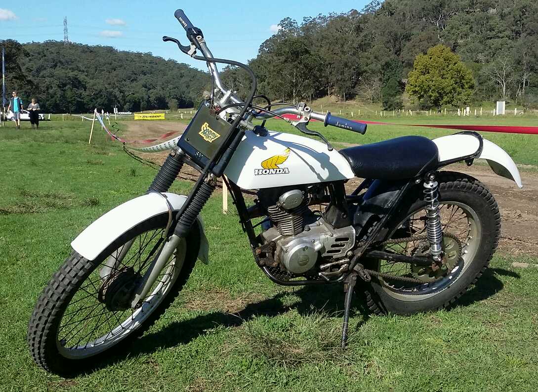

My plan was fairly simple, snap photos of all the old bikes that were competing while they were in Parc Ferme. However there wasn't one, so here are photos of some old bikes that were on display:
Please help us out here with photos of the bikes that we're competing, preferably in Action?
