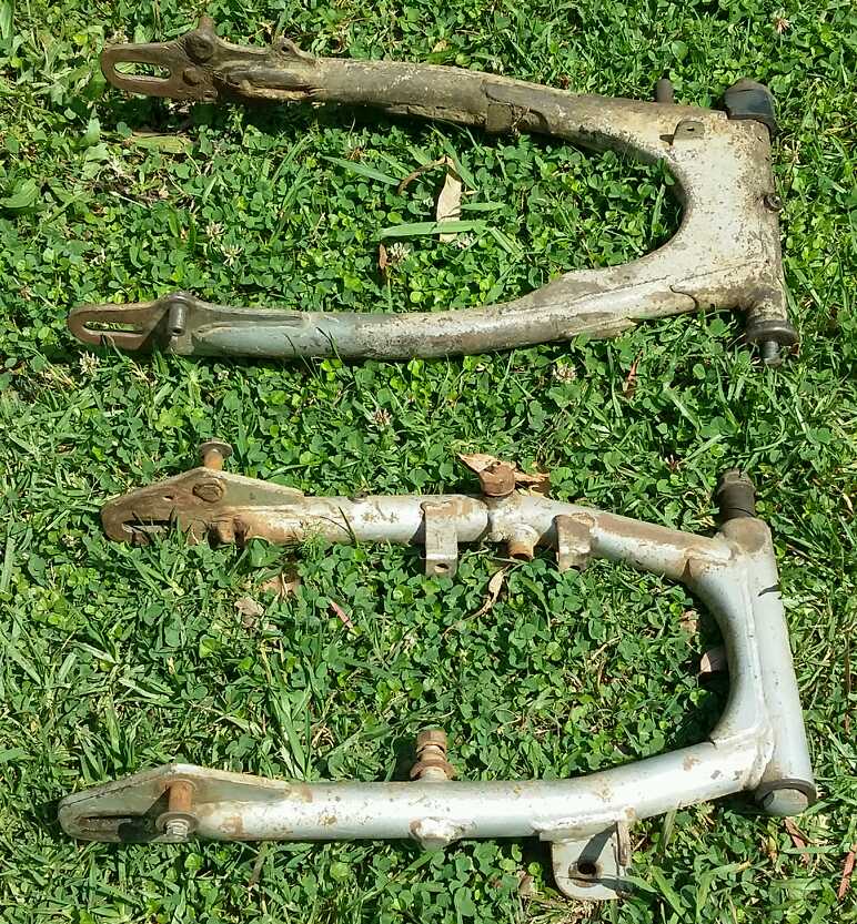

David Lahey wrote:Just worked out - swingarm is from a Honda TL250
David Lahey wrote:Still trying to work out the bananas. Maybe where Greg lives is 15 degrees south of the equator? But hang on those must be Queensland bananas because they have a bend. Maybe the bananas have a 15 degree bend?
David Lahey wrote:Maybe the first swingarm Greg tried with a moved-forward lower shockie mount bent like a banana?
David, yes, mmmm and no, but there were a couple of reasons for choosing TL 250 swingarm. Firstly, styling wise a RL swingarm has nothing in common with the frame other than it bolts on, there are round holes everywhere else on the bike, but not on the Swingarm! . Secondly the RL swingarm has kink bends which matches nothing else, whereas TL swingarm has radius bends more like a Banana!
paulo wrote:Thanks David. I don't know what bars are on the RL, i pinched them off a mate who took them of his ty175. They're some sort of vintage solid bar, they seem fairly tall. Maybe it's just a matter of getting used to the bike.
Paulo, those bars look slightly higher than the ones on all of my RLs which seem fine for my 1800 mm height.
JC1 wrote:Greg, I was just being facetious about the overall top gear ratio. For what its worth it works out at 13.3 (primary ratio x 5th gear ratio X final ratio) so it's not far off 15.
How much longer is the TL swingarm than the RL's?
John, TL swingarm is 2 inches longer overall.
Continuing the theme of spotting mods to the RL
So many more subtle changes to be seen:
Brake pedal & outer cable stop moved back (15mm?)
Front engine mount plates diff
Front downtube appears slightly closer to cylinder & closer to bottom front engine mount
Exhaust midsection is different, perhaps shorter (by 15mm?)
Diff header pipe - also looks shorter. Maybe to clear front wheel on compression of forks on account of other mods.
Bottom rear engine mounts look more upright - hard to tell in the pics & I maybe imagining it, but perhaps to move engine back.
Rear top engine mount looks now to be under the cut-out downtube rather than in front of it (as on std RL)
Tank looks closer to steering head & front of tank is trimmed. I don't think tank has been moved forward, I think the front end has been moved back.
So it seems to me that, apart from the s'arm pivot being moved forward, the engine is moved back a little (15mm??) & the engine cradle & backbone have also been shortened keeping the same rake.
ie the front end is effectively back closer to the rest of the bike & with the longer swingarm the weight distribution is much better with more weight on front wheel. Overall wheelbase is perhaps slightly shorter.
Tho I could be imagining a couple of the small changes (as we've only got these few pics to go on), the whole thing looks so much more in proportion than a std RL (or even a Beamish). It no longer has that 'stretched neck' look.
The more I've looked the more I see how much thought has gone into it. Best modified RL I've ever seen I think. It looked superb in real life.
Re: Basket Cases Squeamishness
Adding BLUE text to respond to John.
JC1 wrote:Continuing the theme of spotting mods to the RL
Brake pedal & outer cable stop moved back (15mm?) Right again John.
Front engine mount plates diff Yes see photo at bottom? The standard plates have triangular holes which match nothing else on the bike and are generic left and right even though they don't fit either side particularly well!
Front downtube appears slightly closer to cylinder & closer to bottom front engine mount Yes 15 mm
Exhaust midsection is different, perhaps shorter (by 15mm?) WARM
Diff header pipe - also looks shorter. Maybe to clear front wheel on compression of forks on account of other mods. You are good at this, photo shows why header was Changed!
Bottom rear engine mounts look more upright - hard to tell in the pics & I maybe imagining it, but perhaps to move engine back. I actually thought the motor went forward, but I have been known to do things backwards, this build thread for example!
Rear top engine mount looks now to be under the cut-out downtube rather than in front of it (as on std RL) Those sleepless nights are paying off! I did not like the look of bulky rear engine mount. Downtube continues to base of frame.
Tank looks closer to steering head & front of tank is trimmed. I don't think tank has been moved forward, I think the front end has been moved back. The tank is the one I separated to remove dints on page 64, the flange was cut off all the way round.
So it seems to me that, apart from the s'arm pivot being moved forward, the engine is moved back a little (15mm??) & the engine cradle & backbone have also been shortened keeping the same rake. Yes and the rake is the same as I think :suzuki got it right!
ie the front end is effectively back closer to the rest of the bike & with the longer swingarm the weight distribution is much better with more weight on front wheel. Overall wheelbase is perhaps slightly shorter. Wheelbase is 10 mm shorter than standard.
Tho I could be imagining a couple of the small changes (as we've only got these few pics to go on), the whole thing looks so much more in proportion than a std RL (or even a Beamish). It no longer has that 'stretched neck' look. Not having actually seen a BEAMISH in real life means there was no influence except I had previously swapped standard RL side covers for the YELLOW BEAMISH ones.
