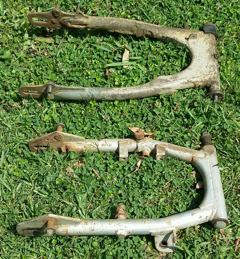

David Lahey wrote:Just worked out - swingarm is from a Honda TL250
David Lahey wrote:Still trying to work out the bananas. Maybe where Greg lives is 15 degrees south of the equator? But hang on those must be Queensland bananas because they have a bend. Maybe the bananas have a 15 degree bend?
David Lahey wrote:Maybe the first swingarm Greg tried with a moved-forward lower shockie mount bent like a banana?
David, yes, mmmm and no, but there were a couple of reasons for choosing TL 250 swingarm. Firstly, styling wise a RL swingarm has nothing in common with the frame other than it bolts on, there are round holes everywhere else on the bike, but not on the Swingarm! . Secondly the RL swingarm has kink bends which matches nothing else, whereas TL swingarm has radius bends more like a Banana!
paulo wrote:Thanks David. I don't know what bars are on the RL, i pinched them off a mate who took them of his ty175. They're some sort of vintage solid bar, they seem fairly tall. Maybe it's just a matter of getting used to the bike.
Paulo, those bars look slightly higher than the ones on all of my RLs which seem fine for my 1800 mm height.
JC1 wrote:Greg, I was just being facetious about the overall top gear ratio. For what its worth it works out at 13.3 (primary ratio x 5th gear ratio X final ratio) so it's not far off 15.
How much longer is the TL swingarm than the RL's?
John, TL swingarm is 2 inches longer overall.
